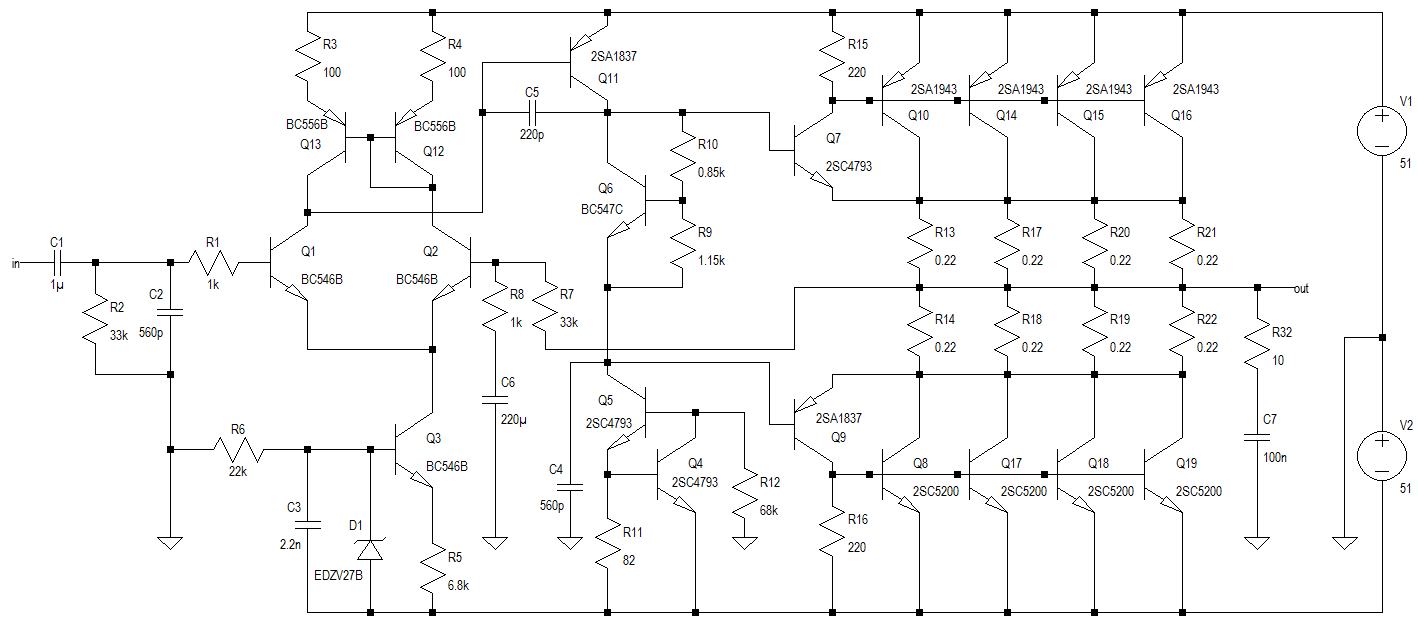

mrcloc: Why do you use current mirrors as current sources rather than the 2-BJT feedback-controlled circuit? The latter is faster and you are using two BJTs anyway. I don't think the loss of 700mV in the feedback version is worth considering - that would mean you are clipping the amp.
Many designers view current sources/sinks as being "not part of the audio path" but they are mistaken. Those circuits are providing the 'push' or the 'pull' against a single-ended VAS or other stage, so their speed is just as important as the signal-driven half.
Also, if you use the mosfets in a CFP-style circuit with slight gain, then the gate voltage is no longer in series with the output voltage so the only loss is over R-ds.
Also: Mouser and Digikey are US vendors that ship worldwide and process orders in various currencies. Check them out. They carry many of the 2SA-2SC pairs and similar Fairchild FSA-FSC parts. They are reputable and work hard to deal only with legitimate suppliers.
Hi. Thanks. I didn't know the feedback controlled current source is faster. I definitely consider speed important in the current source, hence why I want lower power in the VAS; so I can use small signal transistors. I understand there are bigger transistors that are fast too, but then you deal with much lower Hfe, and you need a similar transistor for the amplifier where Hfe is important, etc.
I'll try the different current source. In the LTP, I've changed the current source for one transistor with a zener.
I will definitely investigate CFP style configuration. Isn't that exactly how IGBTs work?
I like Mouser and Digikey - good to know they do well to stock genuine stuff. I know the manufacturers list them. The only thing is that shipping is very expensive. I'll check it out today.
No - heck! Shipping is R600 minimum, unless you buy over R2000. I'll buy for over R2000 at some point, and then I can get some stock, but for now, the expensive shop down the road will have to do.

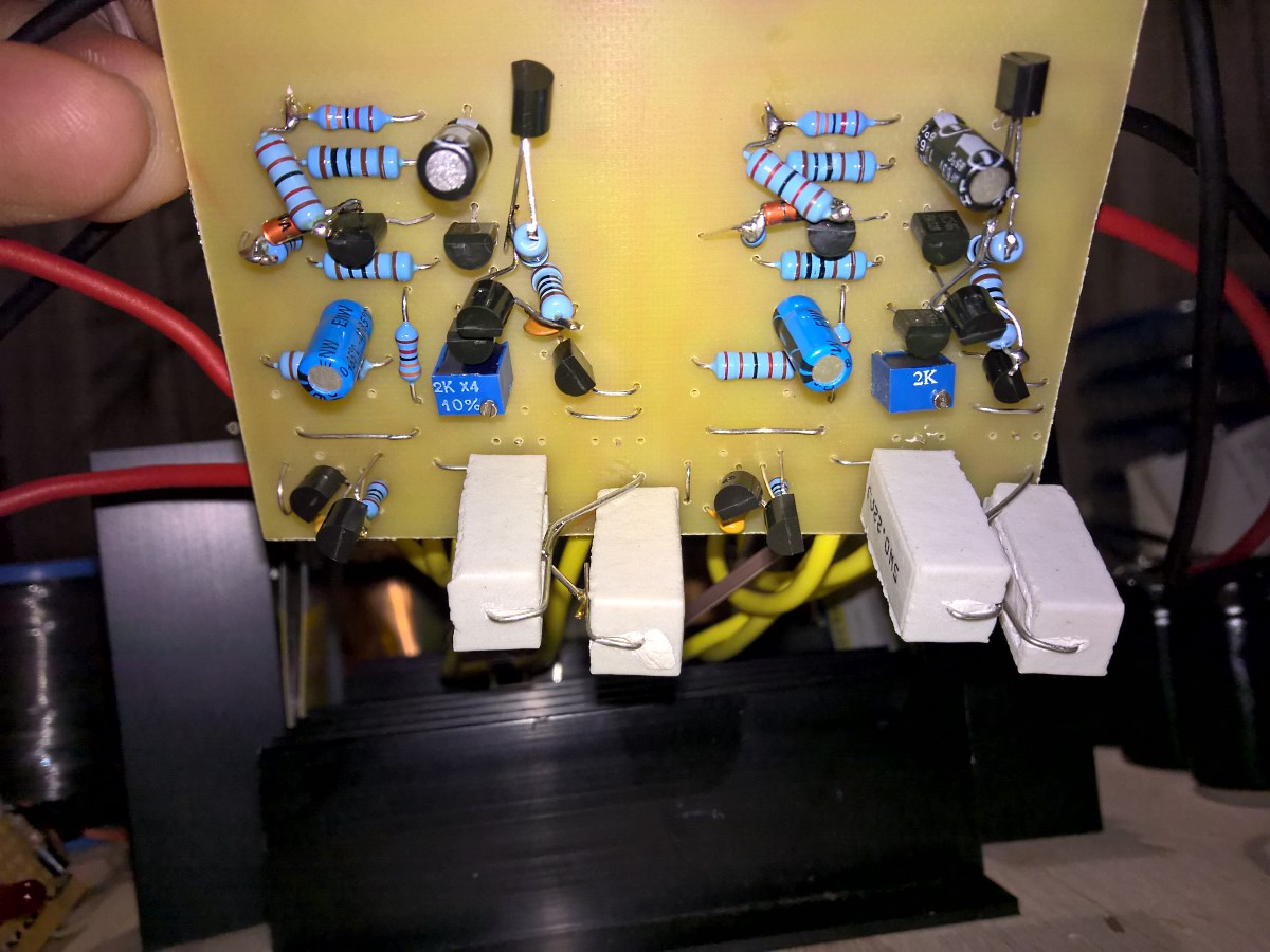

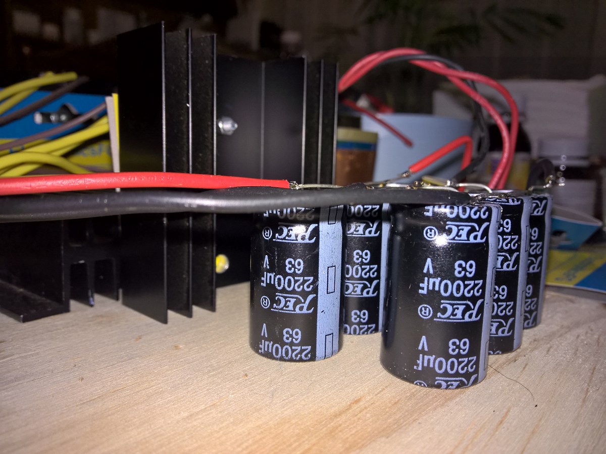

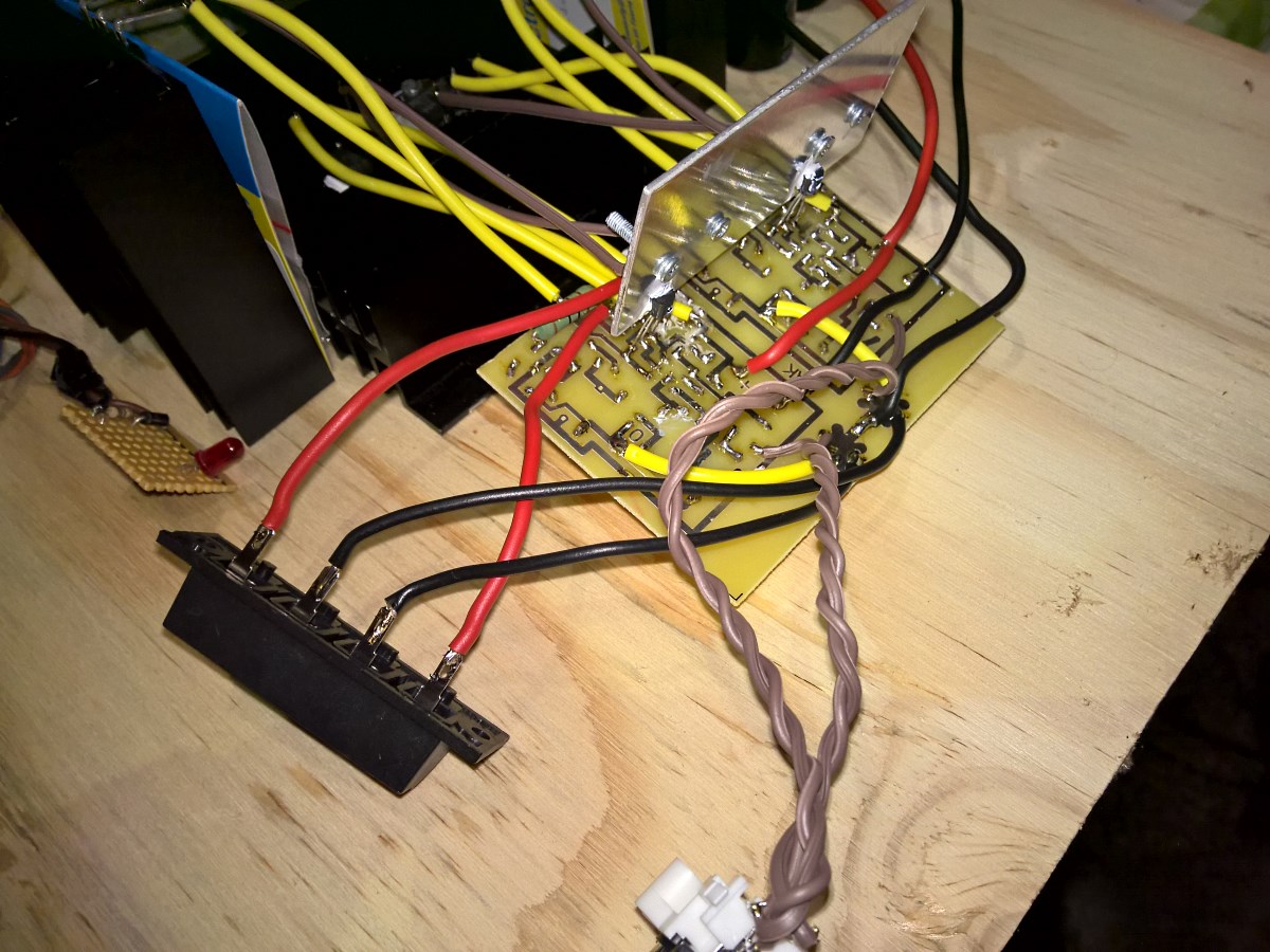

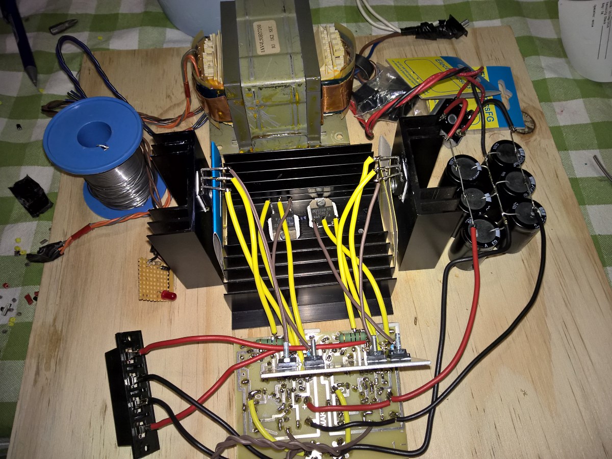

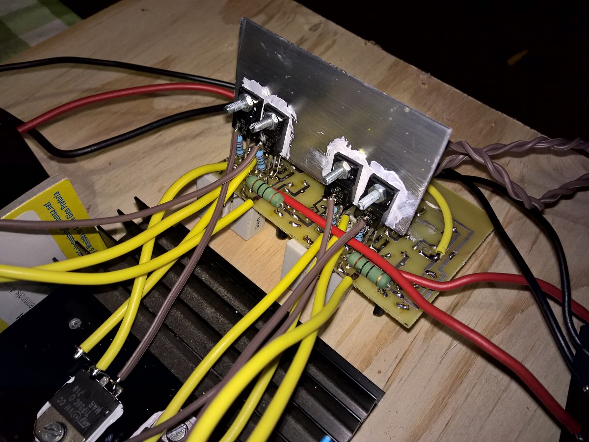

So the evolution of this amplifier has been built. The PCB needed 3 modifications, very minor, but it does look a little bit of a mess. Not too bad - all can be incorporated on this layout in the future. Here it is with no Darlingtons, and the outputs are some old TIP35/6's I had. I'll do some measurements, but I don't think I'll replace the TIP's with anything else. For future amps, I'll decide based on this one's performance.
So far, it sets up as expected. Dead silent; no hum, very low noise. I'll have to see if I can hear noise, but I'm not 100% sure how I can do this. No input makes it buzz a little, and with an input, all I can hear is the quantisation noise of my phone / CD player. I'll have to use a higher quality source.
I'll measure it, but currently it's only set up to 25 mA. I believe this should be fine. The driver heatsink is quite big, so thermal feedback is slow. Total quiescent varies from 62 mA to 66 mA very slowly, but once it's warmed up it's rock solid and holding the heatsink doesn't make much difference.
As it is here, it can accept +-50 V. The VAS transitors might need a small sink, but that's all. With that sort of voltage, 2 or 3 pairs of output transistors are needed with I'd say 0.22 ohm emitter resistors.
There is barely a turn on noise, and it just fades out on turn off - no thump.

Hi Guys

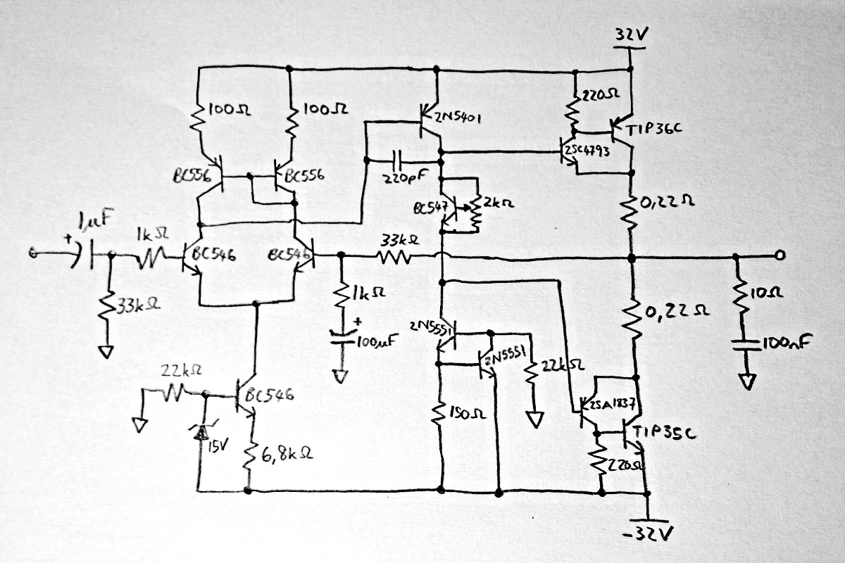

Now all you need to do to knock THD down an order of magnitude is to add an EF to the VAS. This is very simple to do inasmuch as it makes the VAS look ALMOST like a Darlington except that the collector of the input transistor is tied to ground rather than to the collector of the existing VAS. dd a 1k to 2k2 across the BE of the VAS.
I also place a resistor from the amp output to ground, usually 1k, to assist in turn-on/off settling. Depending on the power output of the amp this R might have to be a power type. With 50V rails, it should be a 3W.
There are other details that can be improved in the design and these can be done in any order or combination:
Diff-amp degeneration: Some say this is important others say not. if you add the emitter Rs to the diff amp, the compensation cap will need reducing in value to maintain stability.
Input section decoupling: On the VAS suply rail, a series R is added between the output stage and VAS/diff-amp feed, and a cap to ground is added on the VAS-side of this R. R is typically 22-330R depending on the currents needed for the front end. C should be 220uF or higher, modern amps use 1mF.
Lower-value Rs for lower noise: The feedback loop Rs and the input base-leak and base-stop are often made much lower in value to reduce thermal noise (hiss). If you changed the 33ks to 10k, then change the 1ks to 303R, the gain will be the same but noise is reduced about 1.7 times. if you reduced the values by 10x then noise would be cut by more than half. When you do these R changes, you have to bump up the C values by the same factor.
LF rolloff: The 100uF cap in the feedback loop is a joke even for an amp that is to drive only tweeters. This cap should roll off in the sub-1Hz range so that its distortion is not significant in the audio band. A simulation of your circuit will show that changing from 100uF to 1mF then to 10mF causes reduced THD at 1kHz. This cap is a low-voltage part so high values do not make it a large part.

Thank you Struth, some valuable input there.
I understand specifications-wise there can be value to everything you've suggested, or at least to some combination or some variation thereof. At the moment, PSRR is very high - hum is inaudible. Turn on sometimes has a very slight click, but you have to be listening out for it. Turn off has absolutely no thump whatsoever. It just fades away. In fact, quiescent current remains about 64 mA until some point where it just drops to 0. THD I'm expecting in the region of 0.005%. To implement such a lot of extra bits and pieces, and to experiment which combination gives the best results is a bit too time consuming for me at the moment, especially since the improvement will really be minimal (having a newborn around doesn't help).
As I said, hum is basically gone. At 2am when there isn't a sound to be heard, if you really listen for it with the speaker on your ear you can maybe make out a touch of hum. I haven't heard any noise (hiss) yet - the input device's hiss is far louder, and I haven't completed construction: when there is no input there is still a dash of buzz. I need to earth the amp, test the output noise and hum, and sort out the input.
I completely agree that the 100uF is a bit too small. 220uF would have been 100's. But I don't think there will be any reduction in THD changing this cap. I may be wrong. The 100uF does about 5Hz, which I think is fine, but my input capacitor changed unexpectedly to a 1uF (should have been 560nF but the shop didn't have), so the 100uF is unfortunately the limiting capacitor (the input cap and feedback cap have poles almost exactly the same at about 5Hz).
The only improvement I would really suggest is to use BC550/560 rather than BC546/556 (provided the supply does not exceed +-42 V). And if the supply is kept to <+-30V, I would make the VAS transistors BC546/556, but keep the BC547 in the bias control. This will ensure that noise is kept to an absolute minimum. If you want to stick your nose in the air, use a more "suitable" pair of output transistors too.
The resistors are all 0.5 W metal film, and I would suggest nothing less. I've tried to compromise to keep all resistor values small, and then having a decent input resistance. 33k is the biggest value, and this is fairly small still. The bigger metal film resistors make a huge difference.

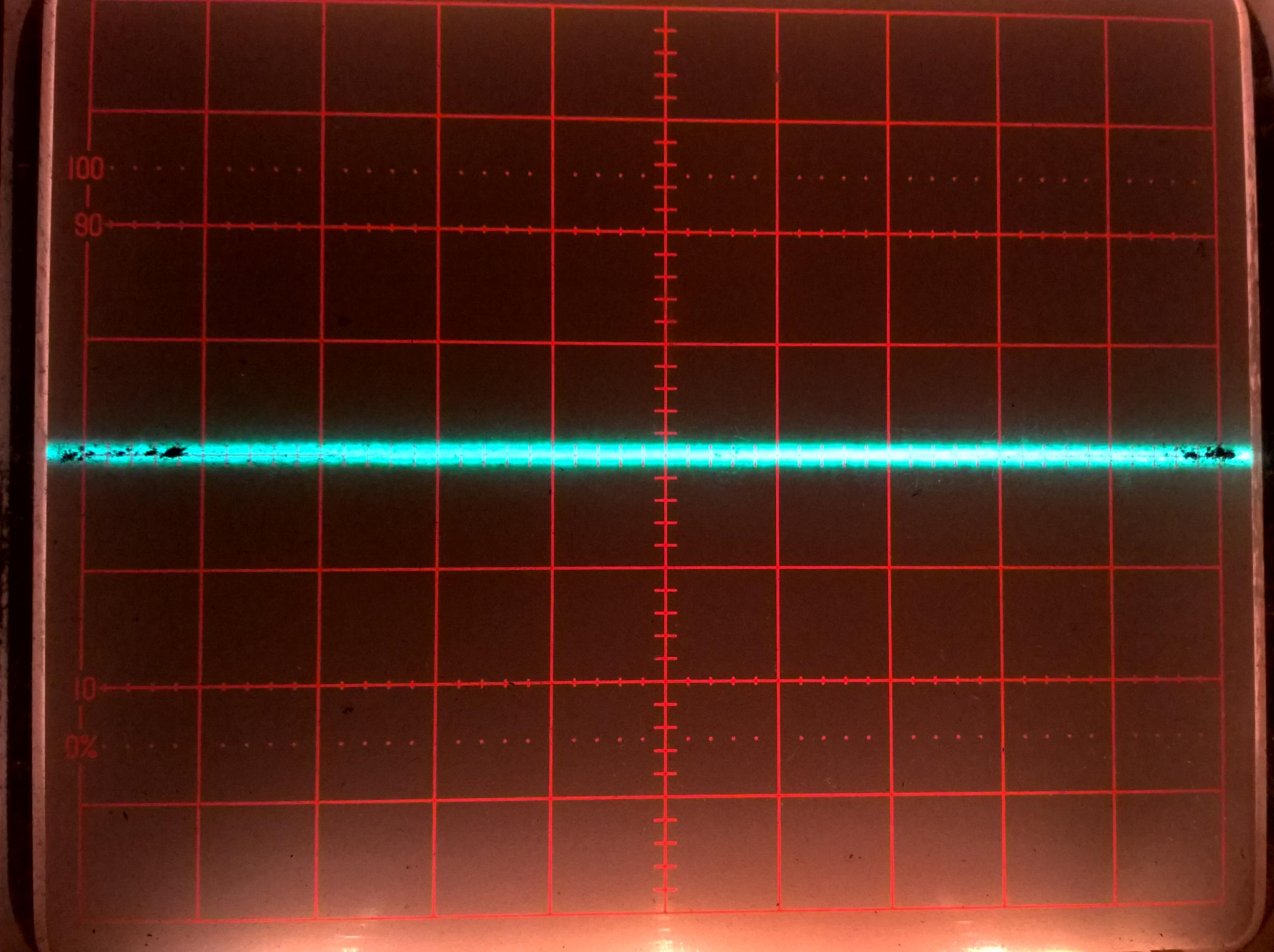

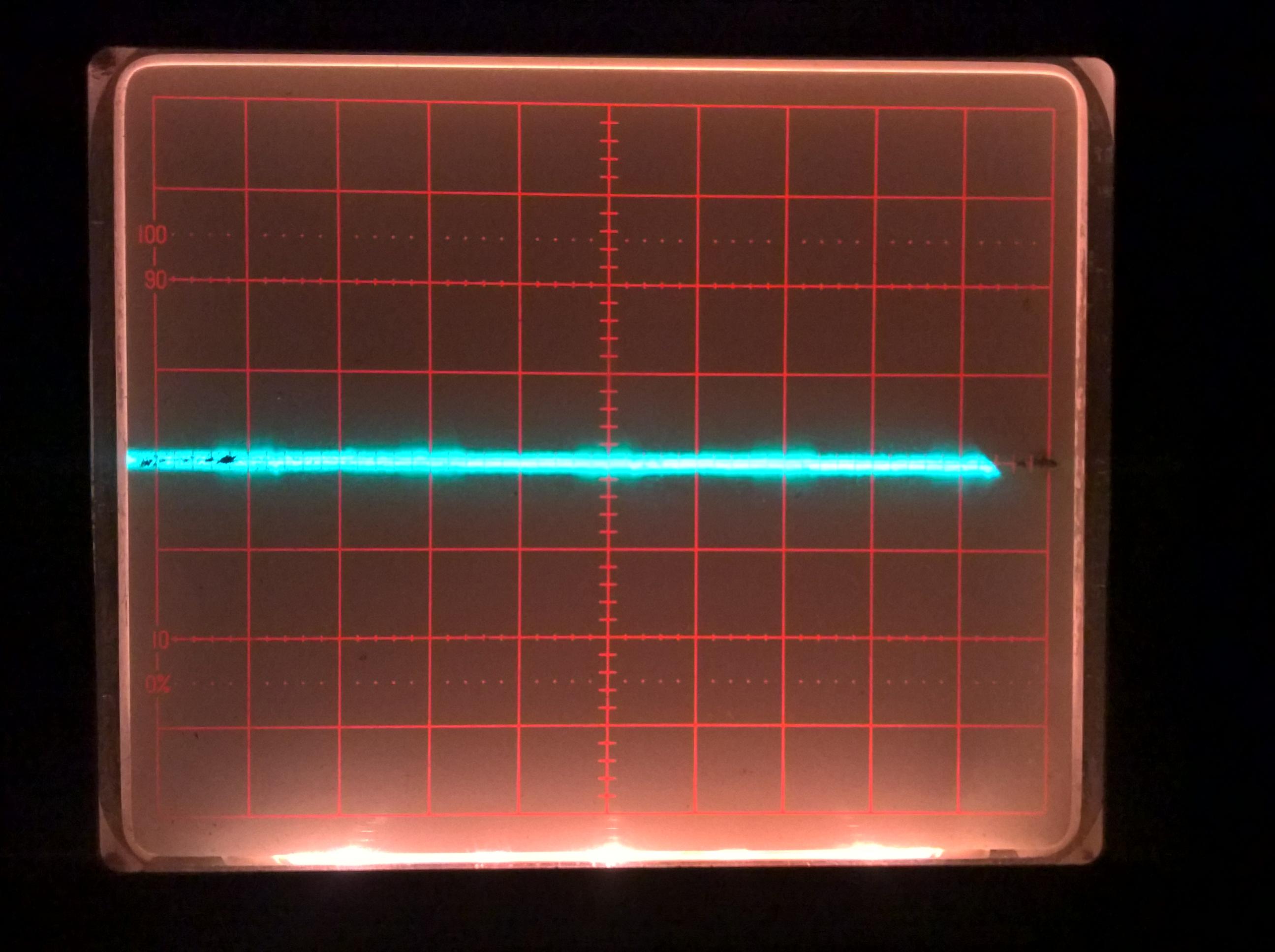

I can't measure hum and noise. My oscilloscope's noise drowns it out and I see no change when I connect my amplifier output. The quantisation noise of my sources drowns everything out. I added an RF capacitor (220pF) in parallel with the input grounding resistor (33k). I need a better oscilloscope probe. Do CFLs emit high frequency? I think my scope is picking up the close by CFLs noise.

I was measuring about 50 kHz, but I measured it with the scope leads disconnected, so I assume it's the CFLs, or some other RFI. Cool thing is that after I added the RF capacitor on the input, the input was far less sensitive to it to the point that I couldn't see it on the amplifier output. Very happy about that!

I've done some measurements on my amp in #106. Got a new scope probe to do this. In the pics, the first one is anything <2ms, the second is at 5ms. Both are at my scope's limit at 5mV/div. I think I've calculated it correctly. SNR = 100dB. I really don't know the calculations, or if I can even measure what I need. I'll read about standard ways to measure SNR.
Either way, i can't see hum, i can't hear hum with my ear on the speaker, and it's midnight and everyone's asleep and we live in an exceptionally quiet area. I can't hear noise, and it looks like it's peaking at 1mV. Turn on occasionally makes a very quiet click, turn off has no thump, only sudden fade out when the rails drop below a certain level. I'm extremely happy.

I saw a small oscillation on the output into a reactive load, so I bypassed the current source in the VAS with a 470pF.
So to confirm, the SNR is somewhere between 97 dB and 100 dB (calculated). The noise RMS value is about 303 uV. I think that's pretty good for a 55 W amplifier.
I target <0.1mVac for Hum+Noise at the speaker terminals.
0.3mVac is my absolute top limit for all amplifiers that I build even a 170W Leach.
D.Self suggests even lower. -96dBu if I remember correctly for a 100W amplifier.

Thanks. Unfortunately salvaging isn't going to do here. Old electronics generally go to the townships; people usually give the broken things to their workers, who take them to their families. I think they try fix them up and they eventually get used. There is a place where I can buy old working stuff, but nothing can come close to a decent power supply. Switching supplies, on the other hand, are possible to build, but I'm not sure how they compare for big amplifiers. I have tried to look up that route, but it's difficult, and a bit less reliable, but I still want to figure them out.
Either way, at $600 for two amp boards alone which are capable of annihilating any speaker I own isn't worth it for me... 🙂
I'm not sure what you mean by commercially silent? I think 100 dB SNR for 21 V output is pretty much as silent as any commercial amplifier. Marantz 6006 does 0.08% THD and 102 dB SNR for a 18.9 V output. I'm at about 0.005% THD and 100 dB SNR, and I'm using equipment with bad noise performance, like an old CRT oscilloscope, cheap probes, and a cheap input wire to the amp. Rotel's RCX-1500 boasts 92 dB SNR for line level input, and 100 dB for the CD player. I'm in commercial territory, I think. 🙂 For the 150 W version, I think I'm looking at 104 dB SNR, theoretically.
Shouldn't those 0R22 resistors be placed at the emitters of your output devices? Or shouldn't the output devices be swapped (C5200 to the positive, A1943 to the negative rail), each one given it's own emitter balancing resistor?
Best regards!
Best regards!
- New design 135W 8, 270W 4
