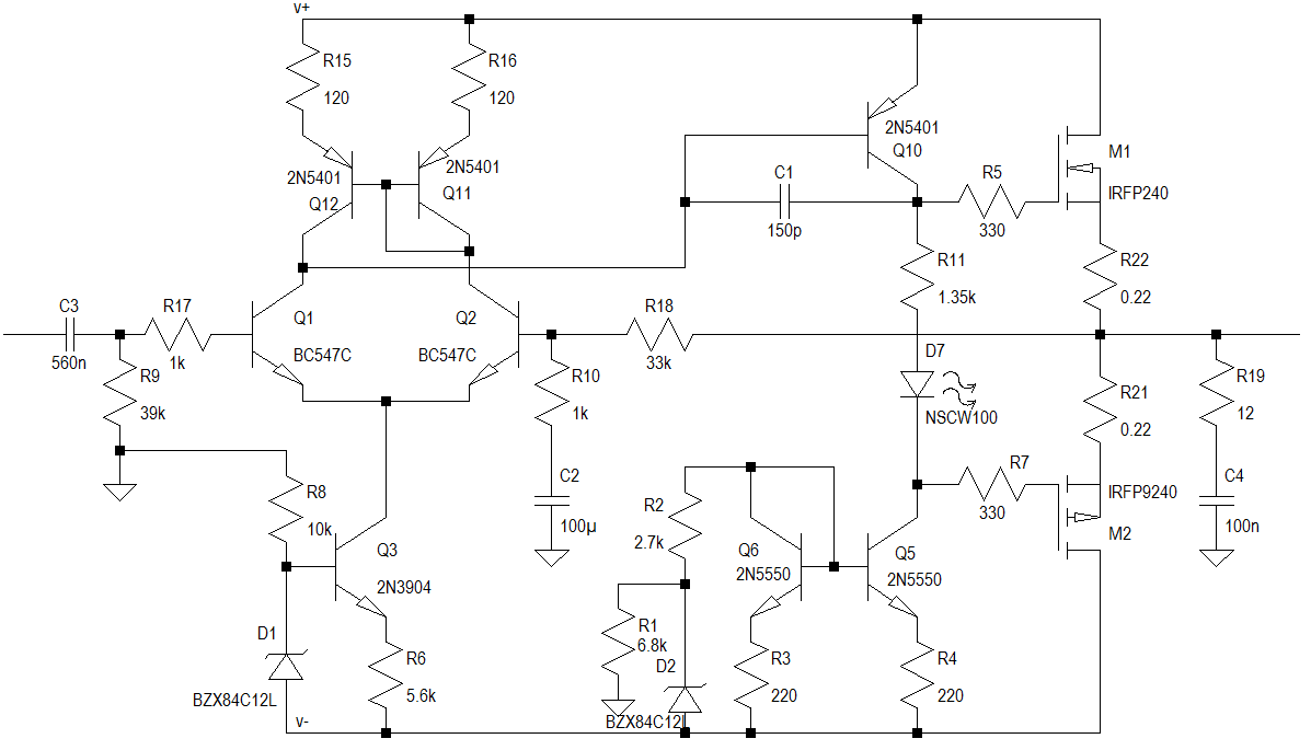

On the other hand, the amplifier can be modified to use a MOSFET output. I really like the IRFP240/IRFP9240, but what are the limits? Is it simply the drain current possible at a certain case temperature? I know BJT's, but I have no experience with MOSFET output stages. See attached; I would think it can do the 120 W in 8 ohms with +-53 V supply, but can't be loaded with 4 ohms at that supply? I would expect it can do 130 W in 4 ohms with +-42 V supply, provided there is enough (and realistic) heatsinking?
And with those transistors, I'm guessing thermal feedback is also necessary?
You NEED very good thermal tracking, try an "amplified Vbe" sensor transistor and either bolt it to the heatsing if a flatpack (TO220, etc.) or drill a small hole in the heatsink and insert it there with some thermal grease if TO92.
Forget that Led + resistor biasing, it will burn your amp as soon as it warms up, switching type MosFets have a high *positive* thermal coefficient.
Ok thanks! And what about HEXFETs - IRFP260?
Two considerations, if I may:
1) Driving the HexFETs directly from VAS does not work well because of the HexFETs' high, non-linear input capacitance (no problem with laterals, but a problem with HexFETs). Solution - push-pull EF stage between the VAS and the HexFETs.
2) As JMFahey just mentioned - thermal feedback is a must. Well-tested configuration for HexFETs with EF drivers - MJE340 (TO-126) with the red LED in series with the emitter - Tempco is particularly suitable for (IRFP2x0).
- New design 135W 8, 270W 4
