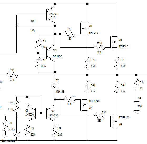

Would the attached work fine for 220 W 4 ohms? I would make the diode an LED, and I think the MJE340 makes a good bias control transistor.

Everything's right except some particular cases, like the one illustrated on my schematic.
The purpose of the LED in series with emitter is to reduce the spreader's sensitivity.
It's not on a heatsink, used as a stable, temperature independent voltage reference.
If it would not be there, the spreader would significantly overcompensate the bias.

Yes, the LED in the bias circuit is perfect where the MOSFET is driven with a BJT EF stage, near perfect tempco with vertical MOS.
