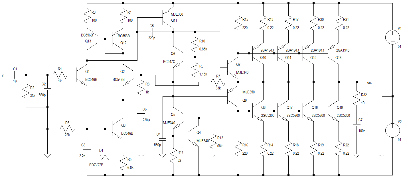

Shouldn't those 0R22 resistors be placed at the emitters of your output devices? Or shouldn't the output devices be swapped (C5200 to the positive, A1943 to the negative rail), each one given it's own emitter balancing resistor?
Best regards!
Thanks. Yes, your thinking is sound about the resistors being moved to the emitters. Essentially, I have 0.055 ohms for each emitter of each compound pair: 0.22 / 4 for four output pairs.
For pure resistive load, the power of interest is at about 0.95A per pair for 8 ohms (for 150 W configuration). this translates to about 0.2V over 0.22 ohms. Not really significant enough, in my opinion. For 4 ohms use, it may be useful to move them. I've never experienced BJTs being that far off from each other ever. So balancing emitters is safe, but safer is to just check the transistors first, especially for compound pairs.

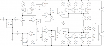

The alternative is as I've shown attached.
Ok, so all that said, if you end up with transistors that really aren't that well matched, emitter resistors are a good thing. So, with that in mind, I think the best configuration is the second attached image.
Thanks for the insight! It made me think a little more about the output.

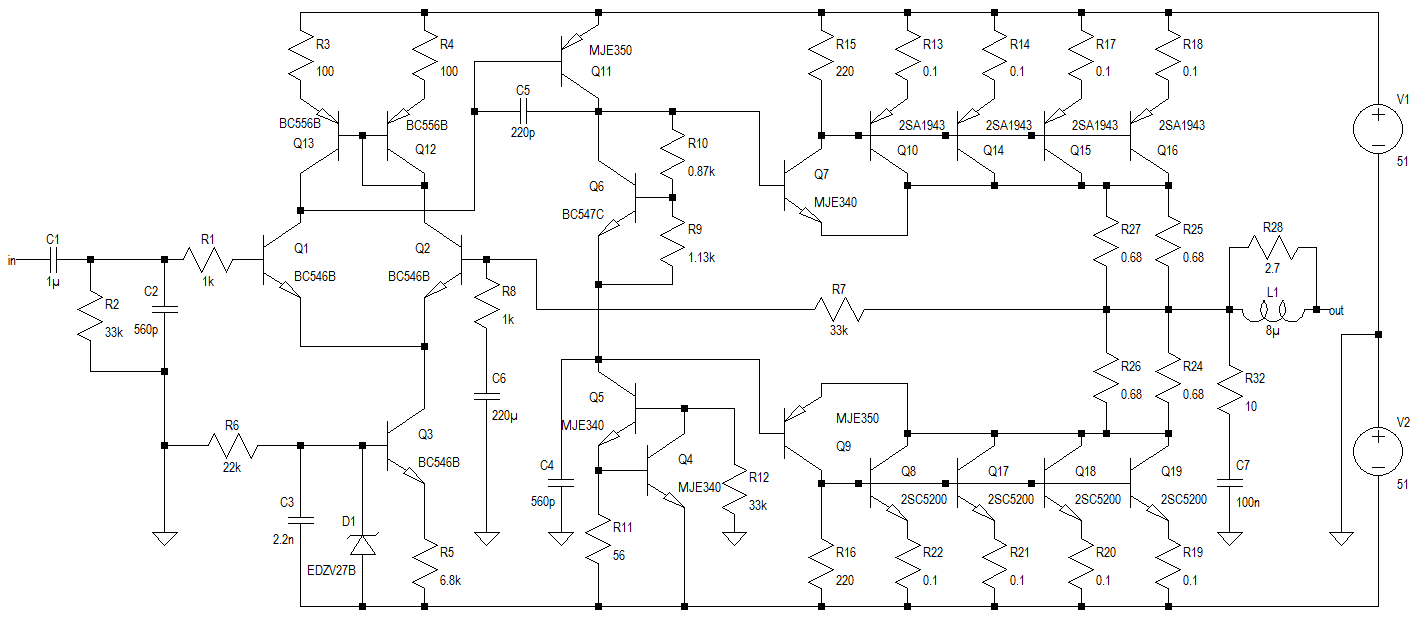

Your new schematics are puzzling me as well. If you rotate the bias trimpot especially in the first drawing, you'll initially see no idle current at all, them a sudden jump to zillions of Amperes, only limited by the PSU's internal resistance, the power devices (which most certainly will fail) and the 0R22 resistors.

Thanks, you're right. Like I said, I could be wrong. On inspection, the balancing resistors mitigate potential mismatches, and it's a good idea.
Yes, the first one is difficult to set up. I've done it, and it is possible, but for certain conditions, it actually isn't possible to set up.
The second one is easier; I've done a similar setup with two pairs per amp with 0.22 ohm balancing resistors, and 0.1 ohm output resistors, and I set it up with a single-turn pot. I must say it wasn't easy at all! 😀 But here it's a 10-turn pot, and with these values, I haven't had issues or drift.
I guess there's nothing wrong with increasing the output resistors. Say to 0.68 ohms each minimum? I'd say up to 1 ohm each should be fine.

I thought the best advantage of emitter resistors on the output transistors is eliminating thermal runaway. As Vbe sags with heat, the voltage drop on the emitter resistor increases. That reduces the gain in base current with heat.
Peavey PV series for emitter resistors uses 0.5 ohms and AX6 use 0.51 ohms, I'm sticking with that. Dynaco ST120 didn't have one on the negative transistor and kept blowing transistors.

Yes, emitter resistors (R24 - R27 in my last schematic) must not be omitted, except if you're planning a class B amplifier with lots of crossover distortion. Leaving them off will be asking for trouble, but at least the compound pairs are very stable thermally.
The 0.1's match the output transistors sufficiently (can probably be increased to 0.22 ohms), and the output resistors provide some local feedback (not sure how this affects things), and allow a more stable setup. The difference with 4 0.68's rather than 0.22's is 145 W / 8, 275 W / 4 vs 142 W / 8, 260 W / 4. Not much difference at all.

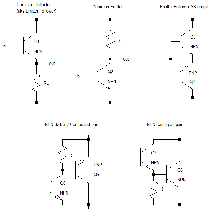

Why don't you go with emitter follower power devices?

This is an emitter follower output. Do you mean Darlington configuration?
I prefer the thermal stability and PCB layout of the compound pairs. I also like the extra 0.6 V output... 😀

you have a common emitter output.This is an emitter follower output.
Darlington is an integrated two device component that brings out three leads and forms a dual emitter follower (common collector)Do you mean Darlington configuration?
the common emitter topology that you are proposing is reputed to be much more intolerant of poor PCB layout/component inductances/inadequate compensation.I prefer the thermal stability and PCB layout of the compound pairs. I also like the extra 0.6 V output... 😀
This fits with what little I know about the two topologies.I use a Darlington output configuration on my guitar amplifiers. It's a 50W amp, and it performs incredibly well. It's also an easy amp to build and set up. I have nothing against the Darlington configuration............
Darlington is an integrated two device component that brings out three leads ...
I think we should agree with Mrcloc that there are discrete darlingtons, made up from two transistors of the same polarity and one or two resistors, and even complemetary darlingtons, aka Sziklai pairs, as well.
Monolithic, three-legged darlingtons came to the market well after this principle's invention.

Let's be clear about what's called what. That's the first thing (see attached image).
Basically, you have an "emitter follower" output if you have something which can be simplified down to what I've shown as an emitter follower AB output, obviously.
If you break down the NPN of the AB output shown (assume it is biased), then there are two common configurations: Sziklai / compound, which can be seen as a common emitter, and a Darlington, which can be seen as a common collector.
If there is an output stage that (simplified) doesn't look like the emitter follower AB output I've shown, I don't know about it. Thus, I refer (in my answer to Kay Pirinha) to the broken-down structures, ie. Sziklai vs Darlington.
Darlington configuration refers to the configuration of cascading 2 (or more) BJTs of the same polarity, not the monolithic device (TIP127/147/ et al.), which would be referred to as a (singular) "Darlington transistor".
In terms of stability, you can most certainly have a common collector (gain of 1) oscillate. Similarly, you can easily have a common emitter (gain of >1) oscillate. Sure, the compound pair is less tolerant of certain factors than a Darlington configuration, but the compound pair is better thermally, and this is something which cannot be predicted as easily as oscillations in the real world. With oscillations, solve it for one, solve it for all (generally). But you have no control over how a user will use the amplifier, in terms of the cabinet it's in, the other components it is near, etc. There is far more to it that this. I'm not nearly as experienced as many on these forums, but in my 14 years of amplifier building, I've learned a thing or two.

I have started to build this one now. I've made one or two modifications, but the circuit remains much the same. I'm using BC546 throughout for small signal and low-power current source drivers. These were selected for ideal capabilities, and comparably low noise. I'm using MJE15030 and MJE15031 as the class A transistor and its current source, as well as the drivers. They do a reliable 100 Hfe in the entire range they'll be used in. I'm using 5 pairs of 2SA1943/2SC5200 on the output, with 0.15 ohm emitter resistors to balance them. All 10 output transistors will be mounted on a 0.45K/W heatsink (it's huge), with thermal switches on each heatsink, which will switch on a fan if the heatsink temperature reaches 95C. The circuit was changed slightly to accommodate +-57Vdc supply.
This amplifier will do around 330W into 4 ohms, and 180W into 8. I will post successes / failures as I build. I will also post a schematic sometime. Components are being delivered now, and the last are due to arrive on March 20 the latest. I'm excited about this one.
