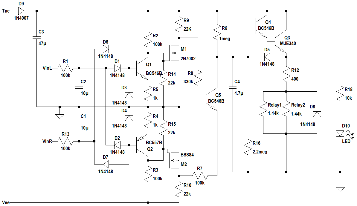

I designed a DC protection and turn-on delay circuit. The turn-on bit I've used in my other amplifiers, and I'm very happy with it. It shuts down nicely - you can turn off, and then turn on shortly after (haven't tested how long), say 1s later, and the turn-on circuit will delay the relays perfectly again. I believe it should work down to a few milliseconds, but I'm not sure (C4 discharges quickly through B-C of Q4). The 47uF filter capacitor lets the relays turn off in a few tens of milliseconds (more than fast enough), and this is convenient for the LED as well. 🙂
The DC protection filters the amplifier output to about 0.15Hz, and should have no false-triggers below 2.5 Hz. It will theoretically operate at +-2 Vdc up to the supply rails to protect expensive equipment from DC. It has a measure circuit for negative DC and one for positive DC, and then compares the output of each. It then inverts as necessary to get the correct voltage onto the relays. The nice thing is that it works seamlessly with the turn-on part for NO relays.
I haven't built this to tweak it yet, but I plan on doing so over the next few months. It is designed specifically for a 40-0-40 transformer supply (+-56-60 Vdc), and the transistors shown aren't what I'll use for the final thing (I want SMD transistors).
If you have comments about the circuit, you're welcome to criticize / suggest things. I'd actually very much appreciate it. I'm going to make everything surface mount, and also design a PCB for it. I'll post all the files here for anyone to use or modify as they wish.

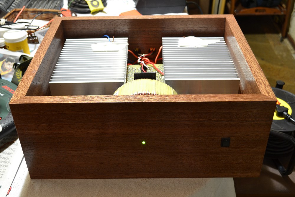

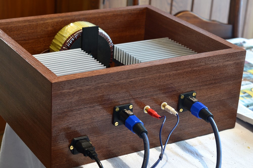

The amplifier looks great and works flawlessly. It sounds perfect, is dead quiet to the ear and it has lots and lots of headroom. I need to put the new DC protection and control circuit in. Without it, the wires are a little untidy, but it works perfectly now, so I'll do that in a few months' time. I just need to put the glass on top, feet at the bottom, and attach the fans.
I will measure the output soon as well, just to make sure.
