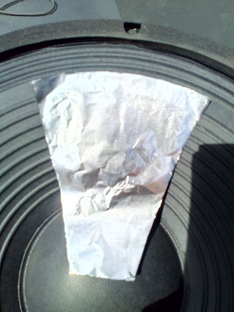

I cover fullrange drivers with aluminium foil in order to get some advancement in sound quality - you can see it here and there is something on the theory on it to read, too:

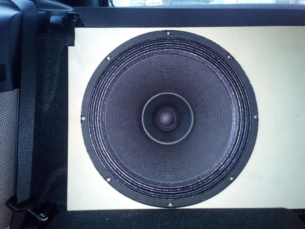

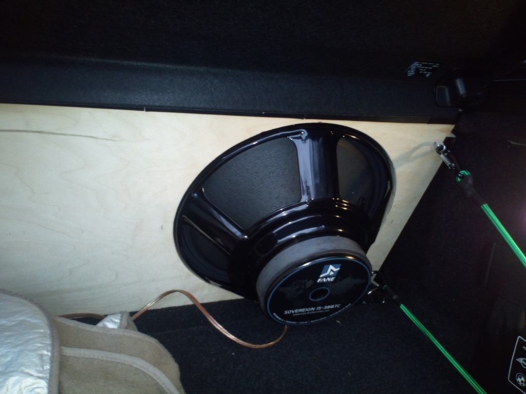

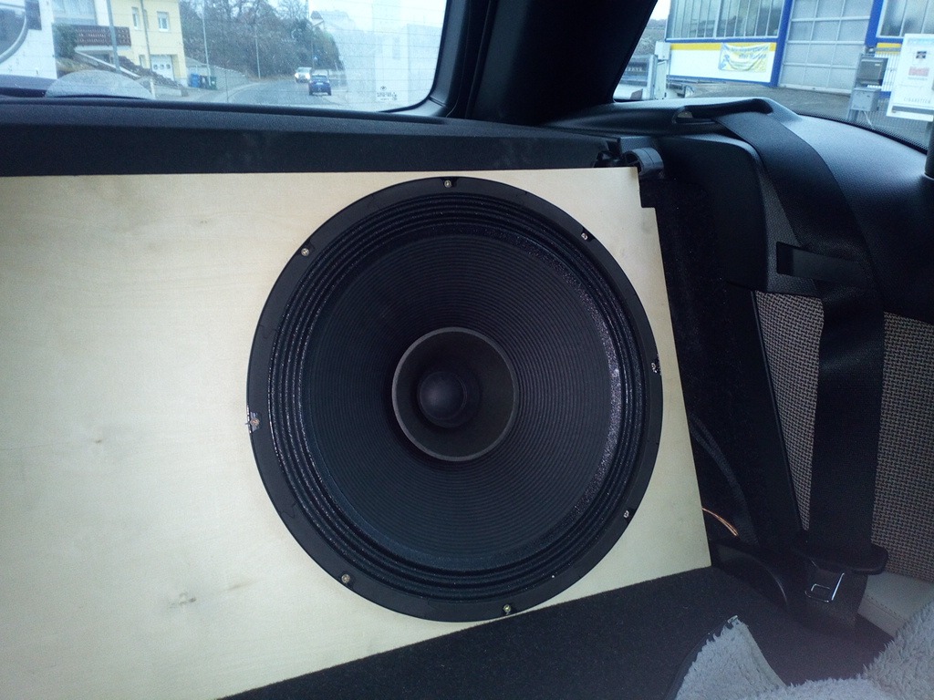

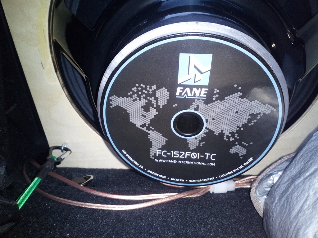

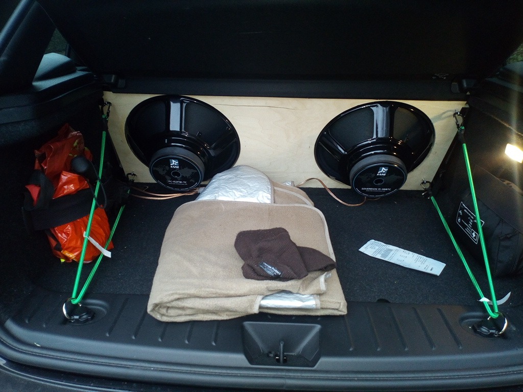

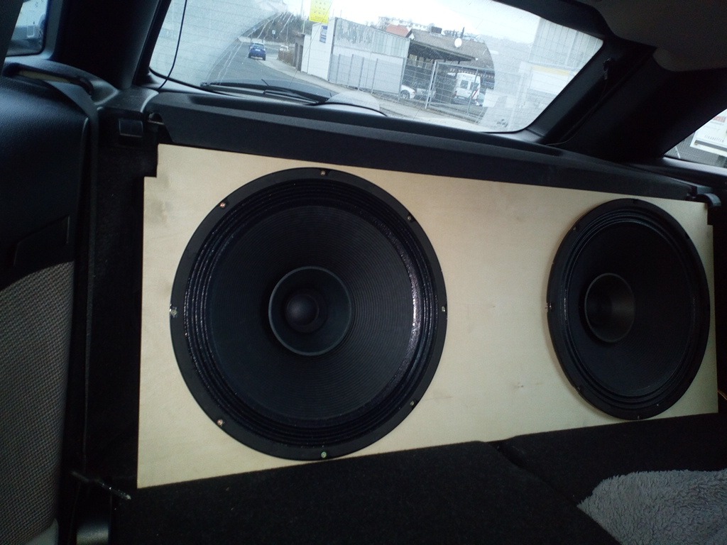

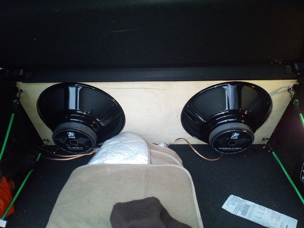

Hello, now I had the time to visit the Fane 15 inch fullranger built into a BMW i3s car. Behind the rear seats the speakers are put onto a wooden board facing to the listeners in the front seats.
All loudspeakers are driven by modern dsp controlled amplifiers. They were measured and calibrated. The Fane is untweaked and in original condition.
I am quite astonished that this driver works right from the shelf impressively good. After measurement it gives in the car the full audio spectrum down to the lowest octave. The high frequencies are fast and quick in presentation - this fact alone is more than nice.
We found out that the rear cardboard shelf is vibrating too much and taking away the bass energy. As a remedy we fixed two times 500 gramm weights on the lower side of the cardboard shelf tuning it like a passive diaphragm to low frequencies what works perfectly. At the side of the board are small openings which work as a low tuned bass reflex opening (I checked this in a simulation). Closing these openings showed less deep bass so the openings should stay as they are.
The fanes are impressive fullrange drivers who do not need any further diaphragm tweaking which I usually do like using aluminium foil. This is due to a well made stiff paper diaphragm - I have to congratulate the makers of this driver as this is the first time I came across a fullrange driver which would profit only marginally from any tweaking.
There is no resonance audible at any frequency. After linearization the existing resonances are not audible in real life listening situations.
As there are forcefull d-amps working with 150 Watts these drivers exceed easily 105 decibels of loudness. The sound is quick, direct and with perfect imaging and no colouration in the so important mid frequencies.
As my friend never gets enough the last tweak with the vibrating cardboard used as a passive diaphragm made the final difference to audio heaven - he now is happy to have purchased these big drivers.

As the BMW car is on leasing and any modification of the car is not allowed. We have fixed the two times 500 gramm weights with strong neodym magnets. There are on the carboard and on the other side are metal plates giving weight to the cardboard tuning it low in resonance.
