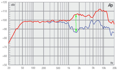

- wonder if Fane mis-labeled their response graph of sealed 75 l vs 80 l /55Hz tuned vented box ? https://www.fane-international.com/images/FC-152F01TC-BASS.jpg

Look @ the dreadful off axis response. Up to -20dB in the critical mid voice section. And generally not good from 1kHz upwards either ! Seems like it might be ok for guitars though :D
I am not sure what the off axis response is measured at in degrees, but my faulty memory suggests 45°. Though even if it's 30° it's quite good for a 15" imo.
At any rate, it looks like a very decent mid if you xo at 0,7-1khz. I've been looking for a single mid with this sensitivity.

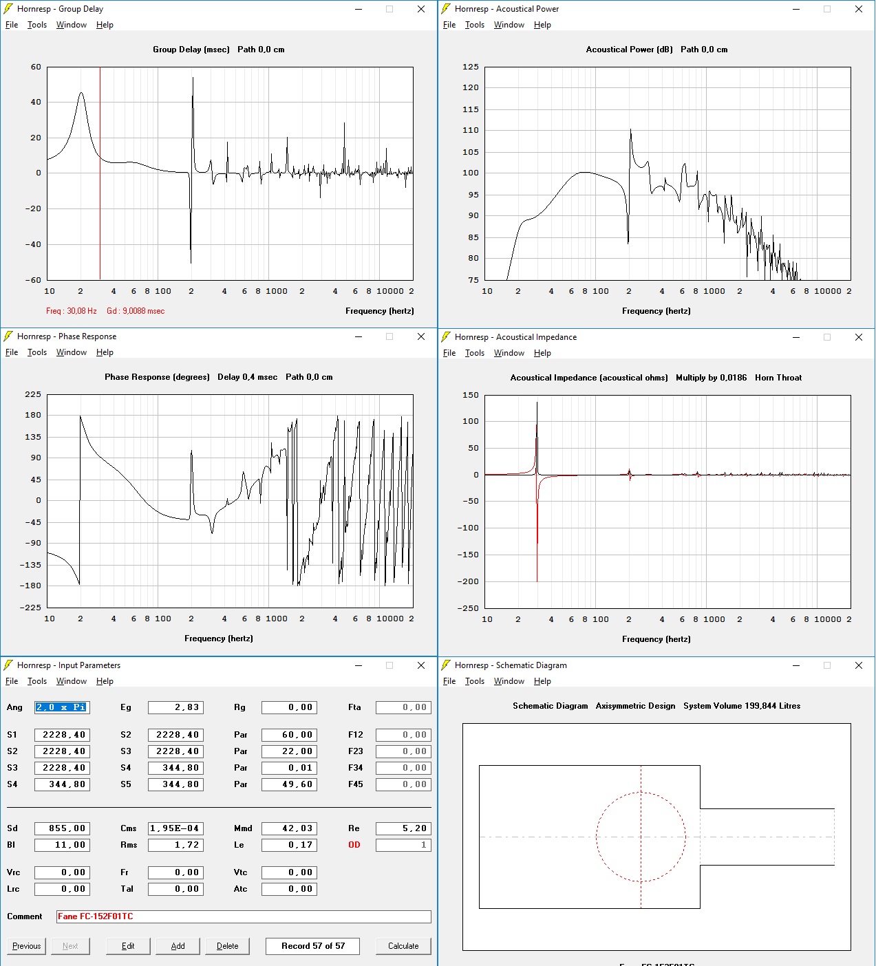

Hmmm... At 100 liters sealed you are just over 100db at 100hz, 99,38 at 80hz.
Just tried a "silly mode" 200 liter thing here, group delay at 30 hz is just over 9 msec which is great! Not a ton of output down below, but reasonable roll off at 30hz -10db smooth down from around 70hz 0db.
Maybe this really is a fullrange?

Found it in another Fane datasheet, it says: "Half space response measured in a 965 Litre sealed box. Blue Line = fundamental 45° off-axis."
Example:
https://www.fane-international.com/downloads/FaneColossus12BDS040714.pdf
I will assume they use the same methods of measurement to all drivers. It seems they write this in all the Pro series units, for some reason they skip that sentence in many of the sovereign data sheets?

I was thinking this driver would be a perfect match for a super budget setup, if you build my simulation with reasonably braced 15mm OSB, get some rockwool leftovers and a bit of felt from an construction site, power it with a TDA7297, use your smartphone as a source and also just do simple "pad down" eq'ing you have a insanely cheap setup that is flat from 40hz up at 95db/2,83v!
I am very excited about this driver.

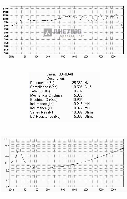

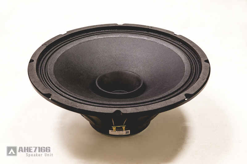

Wow... I thought I had the same driver, at first glance. But nope, there are little differences.
This one is made in Taiwan. Not exactly the same, but quite similar in some ways.
I am using it in OB, as the low end woofer. I tried it as a fullrange, but it drops way too fast around 9kHz. The supplied FR is a little enthusiastic showing more output higher up... in reality, it doesn't go that high.
