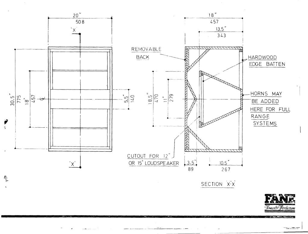

Hello, has anyone building plans for a backloaded horn for the 15 inch Fane?
Has anyone a AJHorn Software to make a simulation? Target of 45 Hertz lower frequency cut off would be nice.

If nobody knows about a horn for a 15 inch driver, maybe anyone got a link or building plan for a Karlson Coupler for 15 inch?
And maybe someone knows about an easy to use FIR-Software (digital EQ for Win PC) for correcting frequency and phase response of the driver together with the backloaded horn. Maybe there is a software applying the EQ to WAV music files so you do not need a computer computing the EQ live.
As the backloaded horn turns the phase below 200 Hertz a FIR compensation would correct for that.

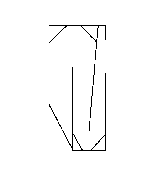

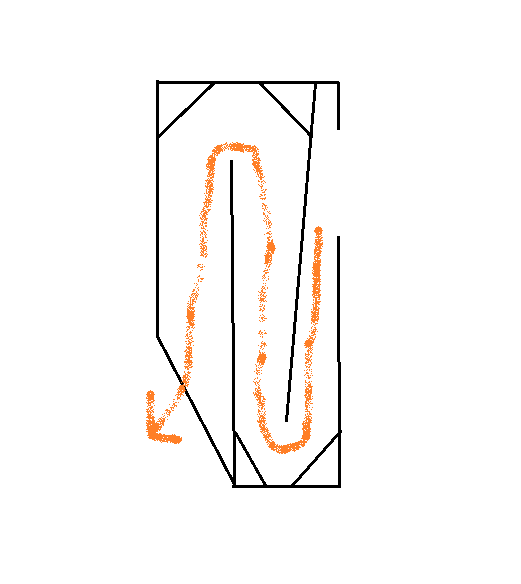

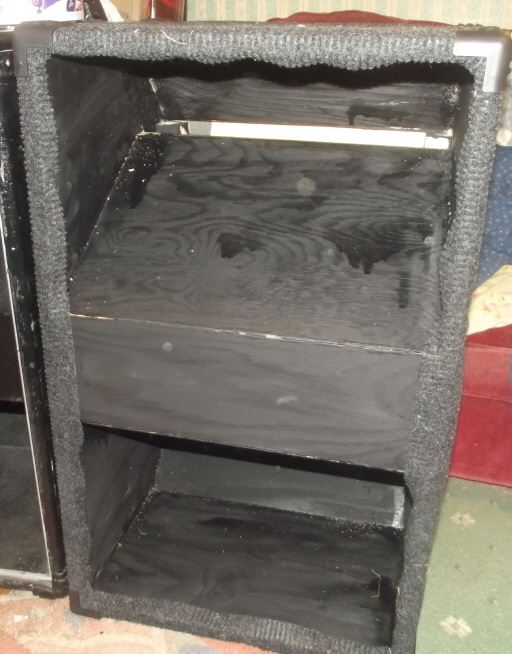

This one is a front-loaded design.
I prefer a classic backloaded horn, something like this one in the picture. It is for a 20cm Beyma.
In the magazine Klang und Ton which I have is a new Horn for 20cm drivers. I could scale it up but I hope to find a horn already designed for 15 inch.

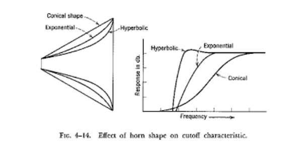

Ideally it should be hyperbolic and be optimized for corner placement with the horn using the corner as good as possible. Something like that.

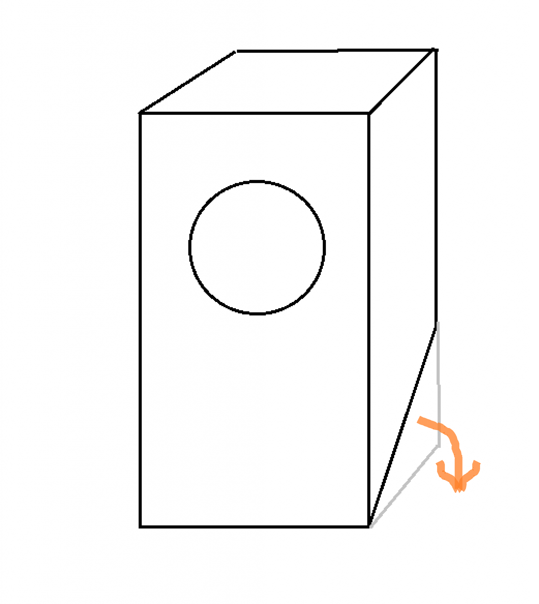

Look from the side onto the box, if you put this box into the corner it fits to it and uses closely the corner.
This is a design without back cavity - you need a cut out of the wood directly behind the driver just to fit the magnet.
Next image is front view - if placed into the corner the side openings left and right of the box couple into it.

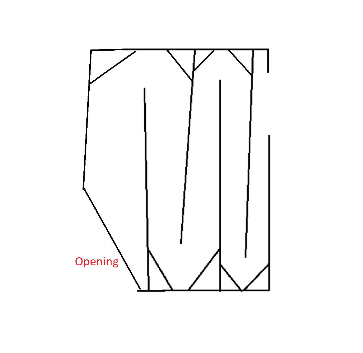

However the line has to be computed and simulated for lower cut off frequency. In germany DIYer use AJ Horn software for this. Anyone here has it?
I could compute a hyperbolic opening by hand. I plan to use DSP just to correct if the design does not behave as it should be it can be equalized to flat. But its better to design properly.

I loaded down hornresp for calculating. But I never used this software maybe someone is used how to feed the needed data.
If the horn needs to be longer for a low cut off frequency the box can be made deeper.

Right, assuming minimal power compression its BW will only be ~ 48*0.75/2 = 18 Hz - 2*48/0.75 = 128 Hz.
