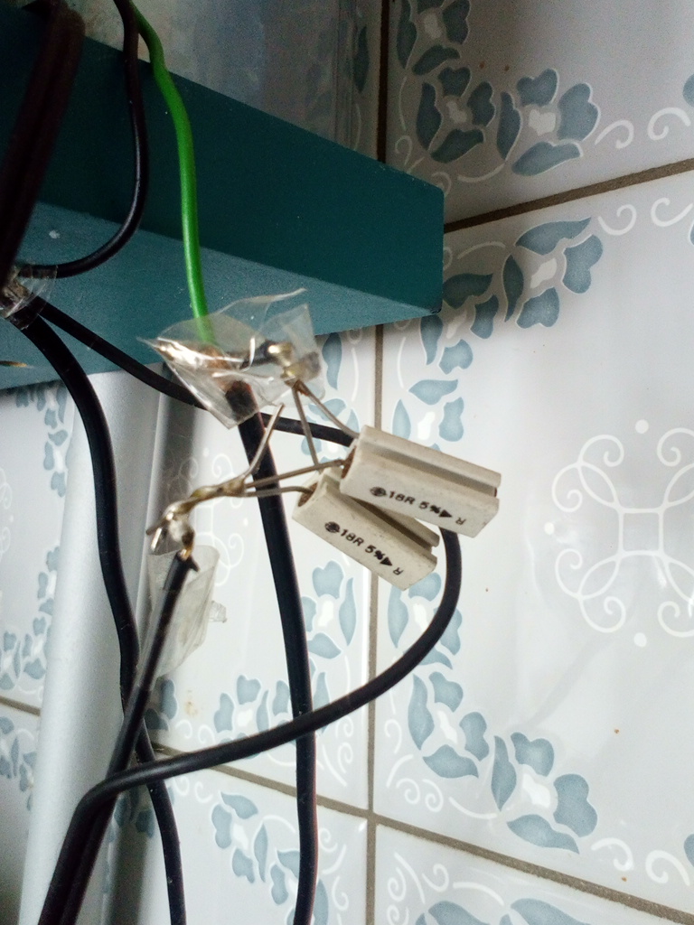

I have a 13cm fullrange driver in a small vented box. I tried here first time putting a simple resistor of nine ohms before that 8 ohm driver. And it helped a lot to bring it further in terms of hifi sound with much lower distortion clearly audible by ear. As the driver was a cheap one with no shorting copper ring at the pole piece it now sounds like it has one.

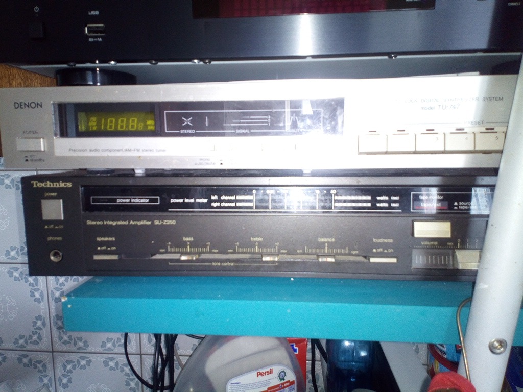

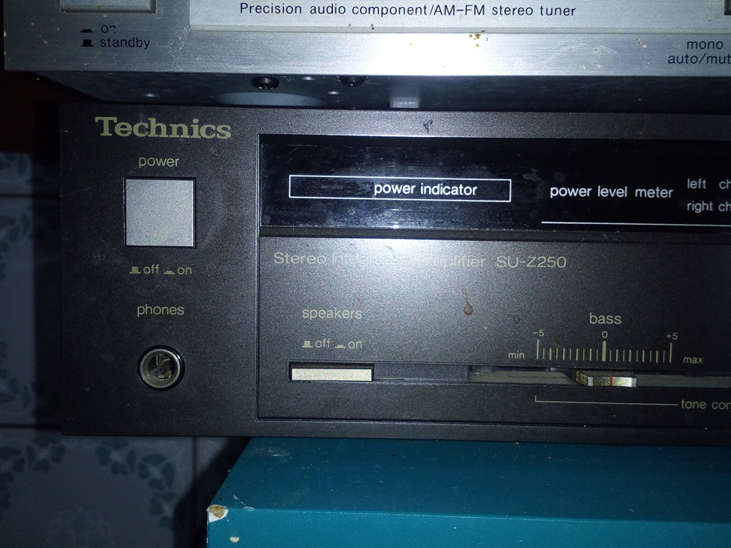

Second reason for trying this: I did that because it is an older amplifer from the eighties and the loudness knob does not work well in the beginning i.e. the headroom while listening not loud. With the resistor in work I have to move the loudness knob in a region where it works much better.

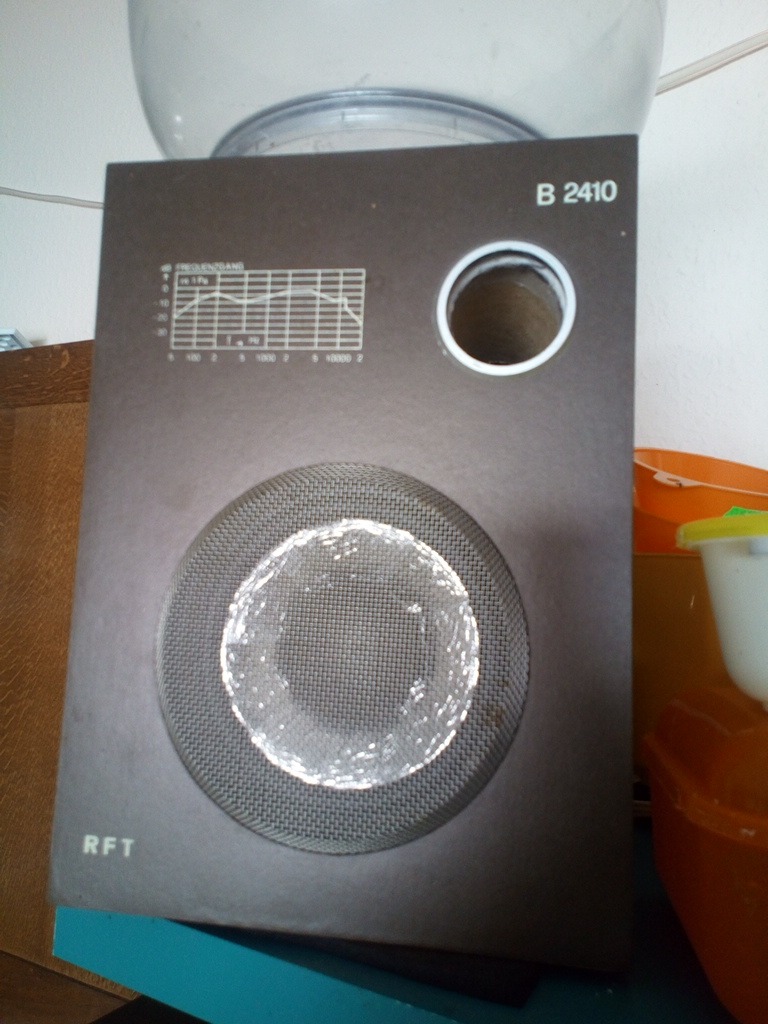

The small box has two 18 Ohms resistors in parallel. The fullrange driver is not original RFT, it is an Eagle L022B Mk2. I covered it with on the front with aluminium. This helps making the cone stiff and can reduce resonances significantly.
