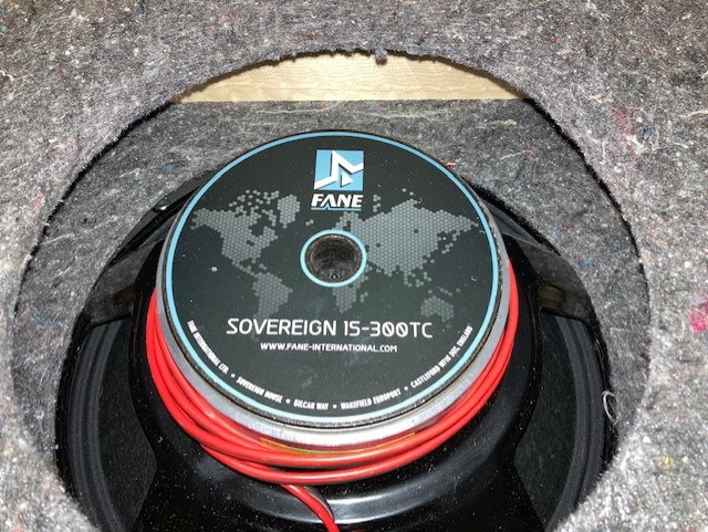

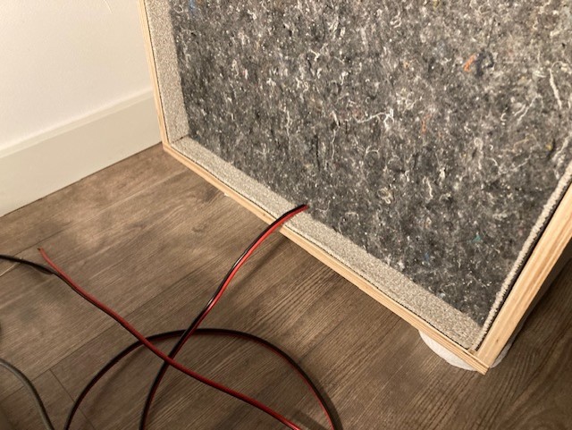

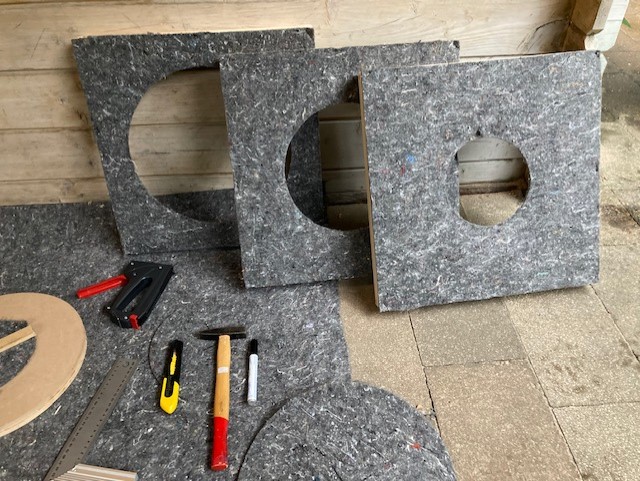

Today I made the frames and finished 'boffling' one of the enclosures. Construction wise I am quite happy about how things turned out.
Unfortunately I'm almost certain I got the wrong fabric. Went for a carpet by the name felton. It didn't cost a lot but doesn't seem to be dense enough for this specific application. There's still quite a bit of sound coming out of the back of the speaker box, which as I understand it should have been more of a faint rumble.
Will do the other one with the felt underlay that I initially had in mind. Hopefully that works a bit better, and more like described in the original articles.

A quick update.

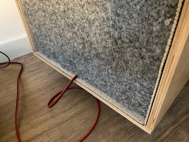

Last night I finished the other box, now with the 6mm felt carpet underlay.
This seems to work a bit better. However I think I could still get a lot closer to Hartley's outcome if I had access to the stuff that he used himself. Which would be about 10mm felt on a burlap core. Maybe there are modern materials that would work even better. Carpet tiles? How does one in general suck up backwaves in 2021?
First listening impression, with essentially two different speakers, is that some of the magic is back again. So that's good. Some obvious flaws still remain, for instance quite a pronounced resonance with male voices. Expecting these (and more) to clearly appear in my first measurements.

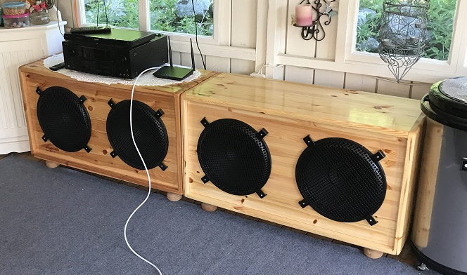

I have not done any simulation for this design no, we designed it as a sealed box to limit xmax, achieve tight mid-bass and smooth roll-off to fit the primary user musical taste within classic rock, blues etc from the 70s and 80s where the need for the lowest few octaves are of less importance.
At first we made only one cabinet and wanted to keep the footprint at minimum but realized the next year we wanted to cover a larger outdoor area with sound and build another.
Id wish I made the baffle 10cm taller and the depth 10cm higher increasing volume from 150 to 240l, I'm sure that would allow us to not use any eq boost in the low end and only focus on mid-taming but there is no science which is more exact than hindsight we are not starting over but we have to option put some ports below.

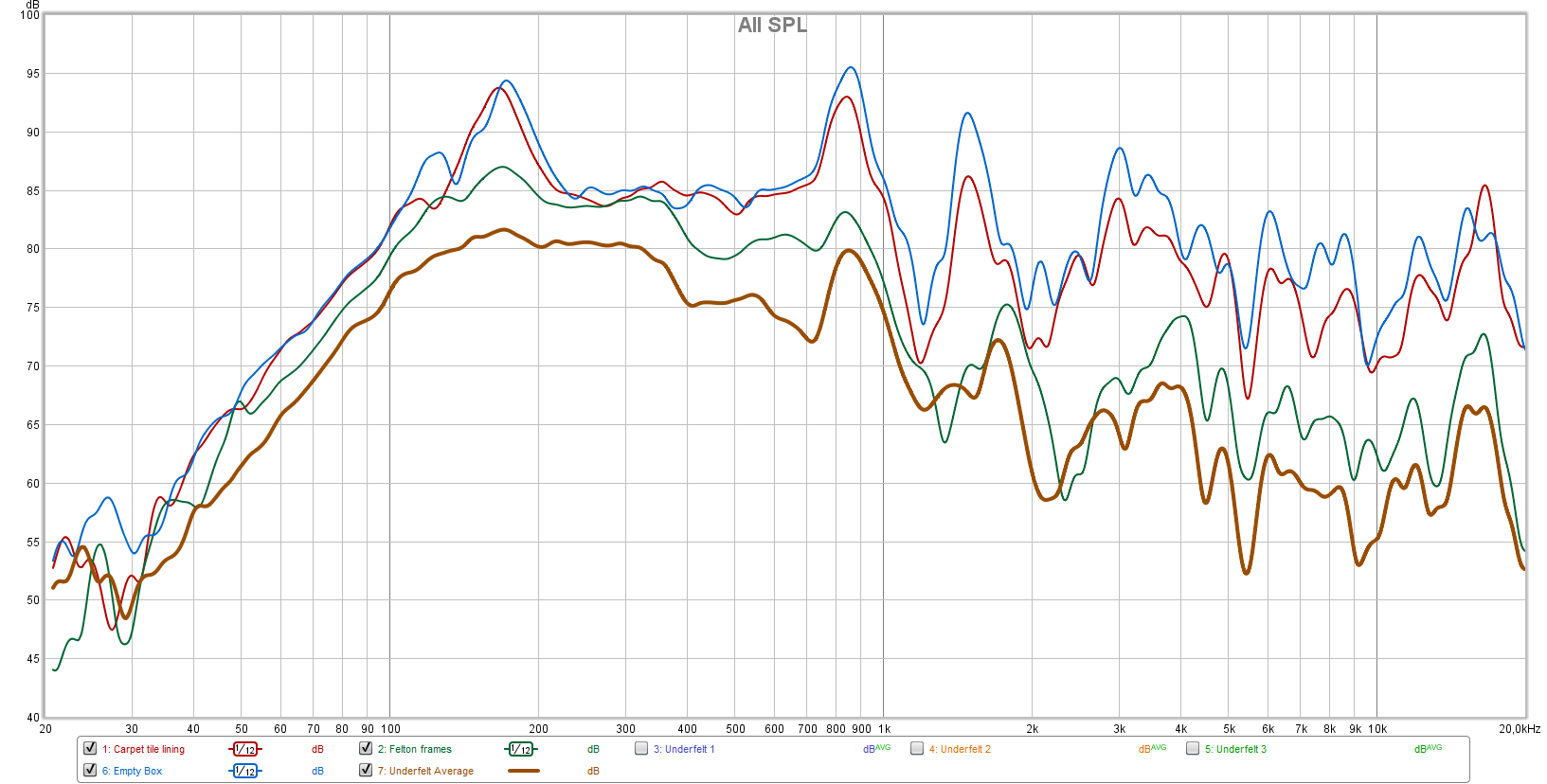

To get an idea of the effectiveness of the boffle concept, at least the way I executed it so far with the Fanes, I took one of the speakers outside and measured the response at its back side, in four configurations.
1) A totally empty boffle, just the naked wood and the driver
2) The first configuration but with the inside lined with carpet tiles
3) The second configuration with the addition of the frames with 'Felton' carpet
4) The second configuration with the addition of the frames with 6mm underfelt
Measurements were done on the backyard lawn, speaker placed on a 45cm high stool, mic centered at 20cm distance from the back side.
Attached the results. I am just posting this for the record, not at all because I believe I have achieved anything yet. In fact I highly doubt the boffle strategy is going to get me anywhere near this integrated media console I had in mind. Even if I would be able to increase its effectiveness considerably.

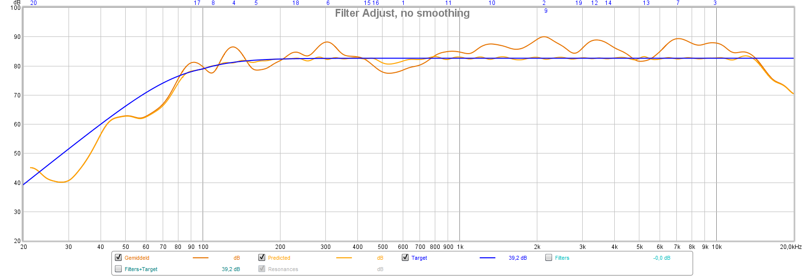

Parking the boffle for the time being I went back to this configuration, but now with the drivers on their 47x47cm boffle baffles.
Then I took a three point in-room measurement, averaged them, and let REW generate a set of EQ filters for the attached target response. I know this is not the recommended way to do speaker/room EQ, but one has to start somewhere. Anyway I applied the filters in EQ APO, and played some music.
What I ended up with was a gorilla in a bell boy suit. The resulting sound was very polite and well-behaved. I added little bit of bass and treble, which helped somewhat. But as others have noted before, EQ-ing the magic out of these Fanes is quite easy. Even if the result would be more correct on paper and maybe even to the ears. A very interesting experience indeed.
