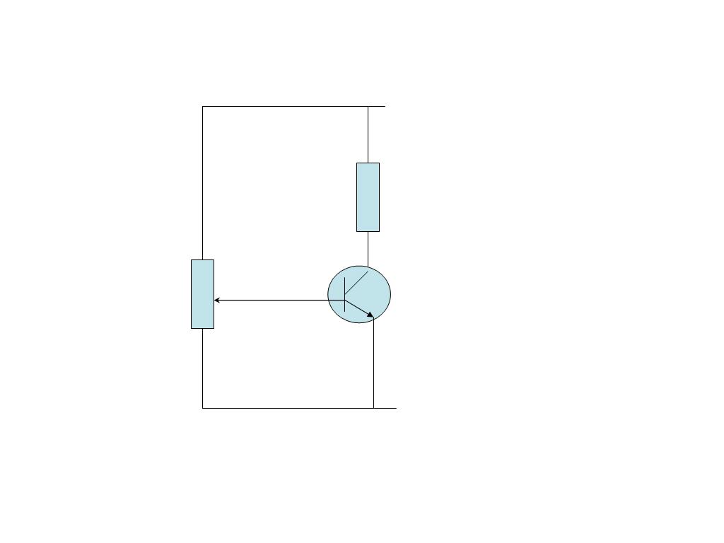

SOA Testing
First of all you need to study and understand the datasheet.
MJL4281A is rated at 350V and 15A BUT NOT SIMULTANEOUSLY
The SOA graphs show that the device can operate at 15A with a Vcc of 15V for one second. The important factor is Ptot = 230W.
So we have to pick somewhere under the SOA curve and within Ptot.
Lets use 8A and 24V, that gives us Ptot = 8x24=200W.
You will need a 24V 8A power supply. A 3 Ohm 25W resistor and a Large Heatsink.
You will need a 5W 220R potentiometer or a variable voltage source.
Basically, start with 0V on the base of the transistor and slowly increase the voltage until current starts to flow.
You should be able to increase the current within the SOA (up to 10A briefly) and the transistor should survive.

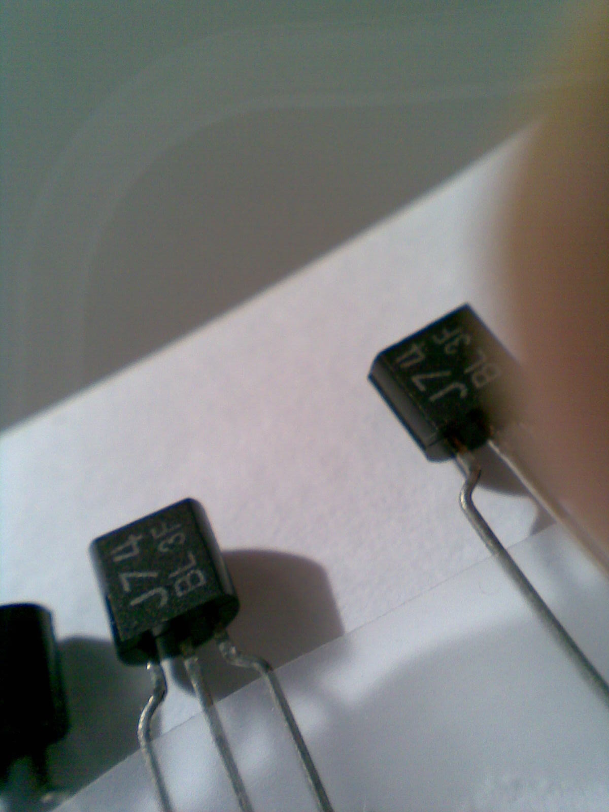

Fake 2SJ74
I bought some 2SJ74's, thinking I would be able to match them myself, as I had 2SK170's already.
Well the 2SJ74 were very strange, in build and specs:

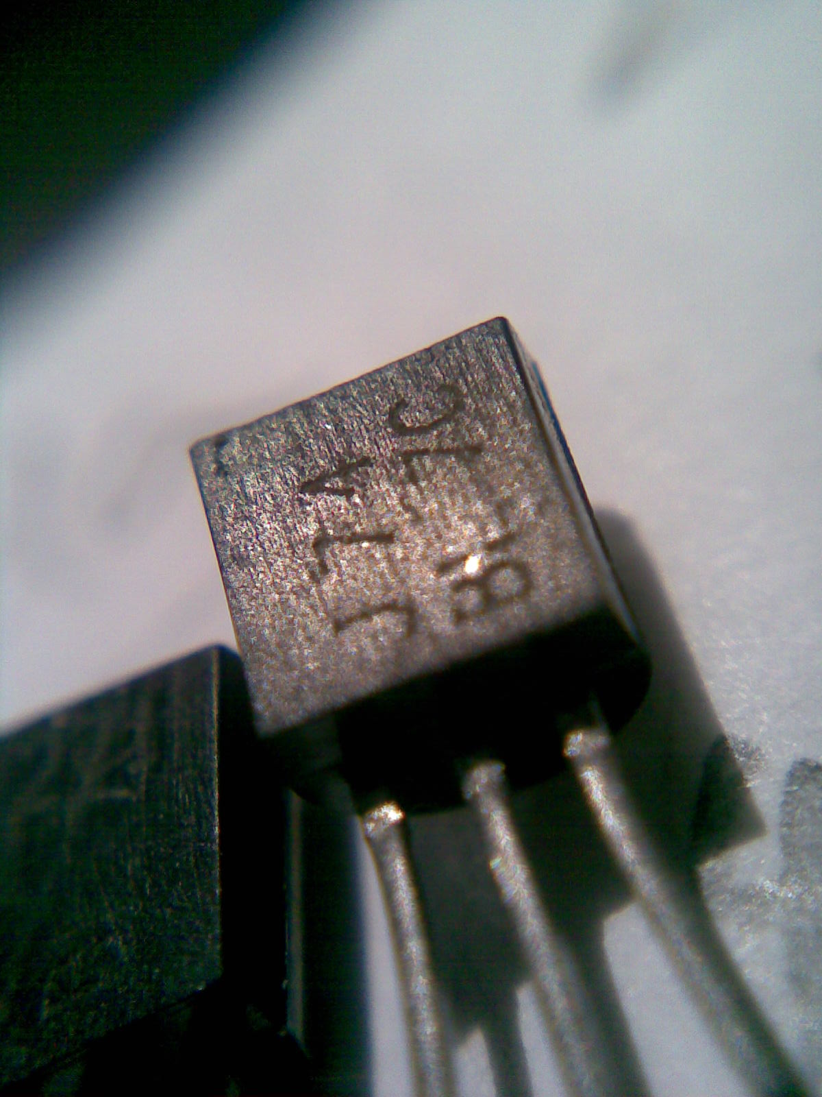

how they looked like:

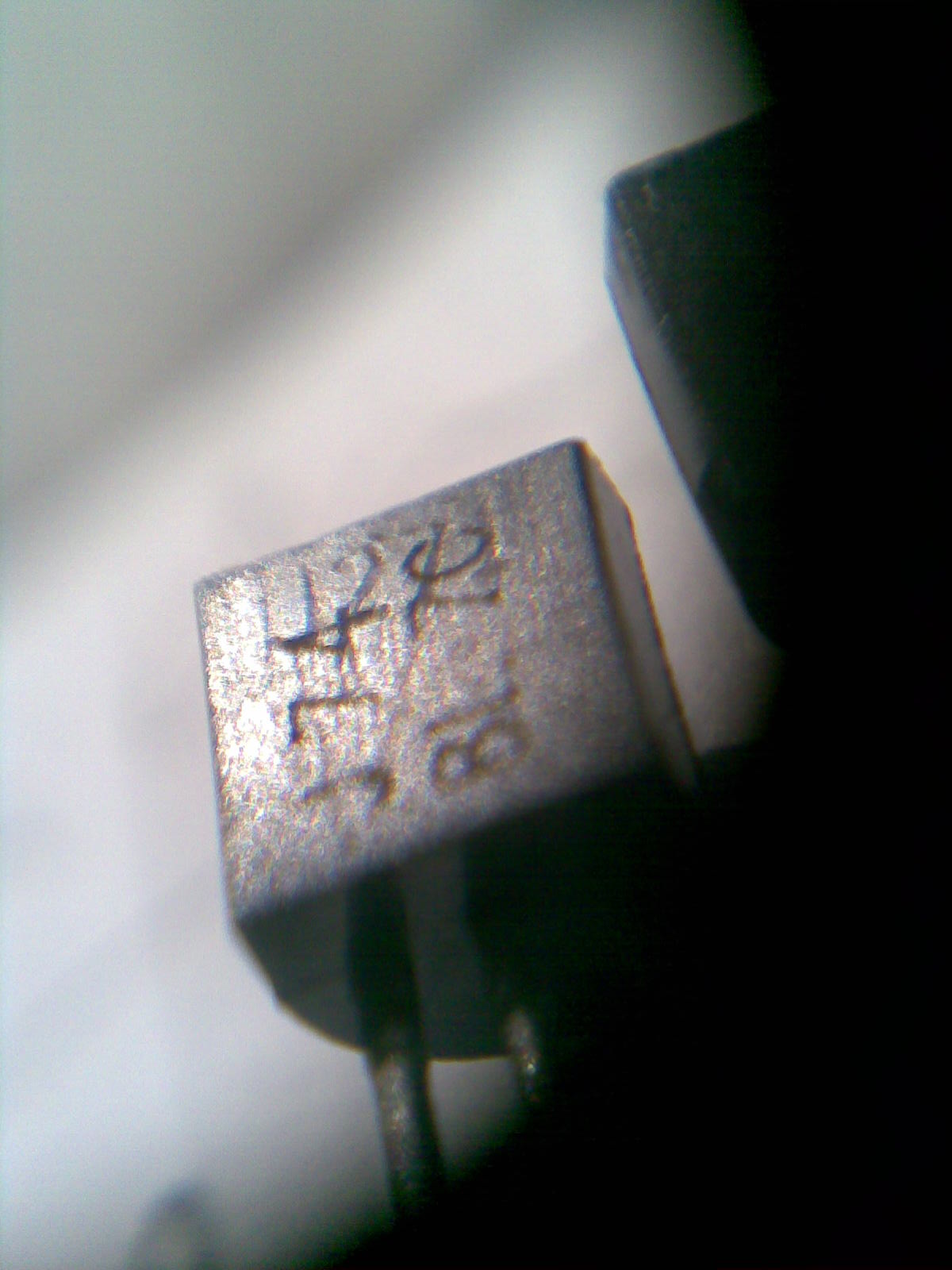

All had scratches, one also showed an old typenumber
This is how they looked from a good source:
And these were the measurements,
top the fakes
and bottom the real ones (and matching 2SK170's)

They costed the same, so this was not an el cheapo trap. Yes, I got my money back.
take care
albert
top the fakes
View attachment selectie 2SK170, 2SJ74.pdf
take care
albert
the second pic looks like the old number was J271, but that doesn't make any sense because a J271 is a 60A MOSFET in a TO-220 case... unless it's a Siliconix number J271
a J271 (national semiconductor, siliconix or fairchild) is a general purpose p-channel jfet with a far lower transconductance. since the process for this device has been licensed to 6 manufacturers, it's likely these fets are much cheaper and plentiful than the 2SJ74 would be.
You are right. I looked at the device again today, and indeed it reads J271 (but the J is hard to read because of part of the new 'imprint' was lasered across it).
J271 is a P-Channel Switch designed for low level analog switching sample and hold circuits and chopper stabilized amplifiers, from Fairchild. Indeed, Idss between 6 and 50. Not a hifi device! Not for audio at all.
