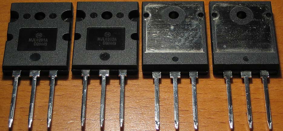

Pictures for MJLs
I will show pictures of MJL0281A/0302A as all MJLs from OnSemi look the same. I found no significant difference to other MJLs.
They should be good as reference to all TO-264 from OnSemi.
These have been aquired through the OnSemi sample program. (Not ROHS conform yet)

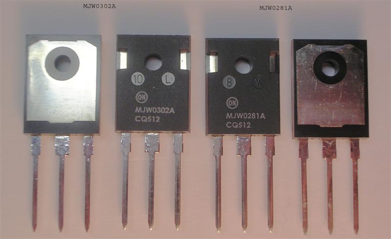

MJW0302A / MJW0281A
Just got some more from a new batch. These are great!
hFE measures just under 100 for all, NPN's maybe one or two counts higher on average.
B-E capacitance is going to average 7.6 nF with the PNP slightly lower by a couple counts (so far).
Here is another picture of both types ......

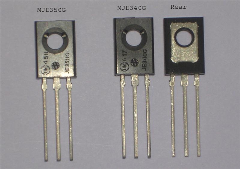

Mje340 / Mje350
Here are some oldies (new stock).
MJE340 B-E capacitance averages 278 pF, hFE around 100
MJE350 B-E capacitance looking like 370 pF, hFE around 120 (fewer samples).
A shot of real, fresh On Semi parts .........

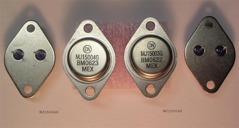

MJ15003 / MJ15004
Some more older numbers (brand new stock).
MJ15003G hFE averages 45 ~50, B-E capacitance around 3.65 nF
MJ15004G hFE averages 180 ~190, B-E capacitance around 3.55 nF
I wish the hFE figures were closer between NPN and PNP.
Another mug shot for you .........

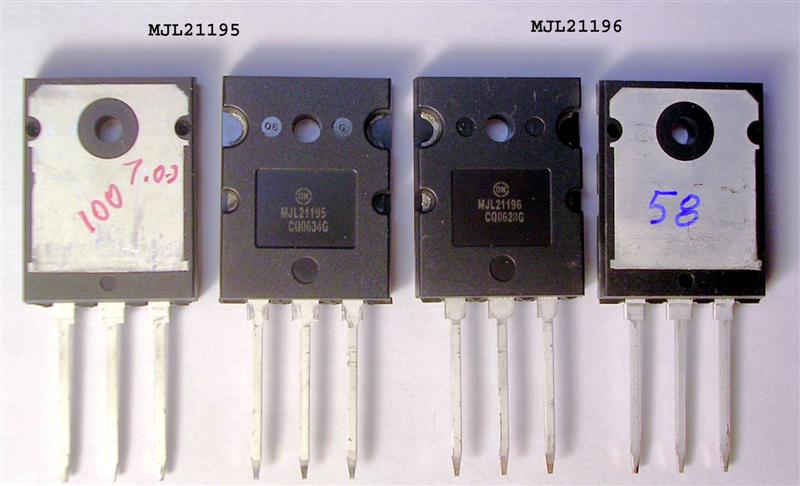

Mjl21195_mjl21196
Hi all,
I've now measured some new MJL21195 and MJL21196 transistors. PNP and NPN current gains are about 2:1 at low currents. I'm going to have to try this at higher currents.
MJL21195 beta averages about 100 and are very consistent, B-E capacitance is averaging 7.05nF at 10 KHz.
MJL21196 beta ranged from 38 to 62 averaging 52, B-E capacitance varied from 5.02nF to 5.81nF averaging 5.33 nF at the same 10 KHz.
Capacitance meter test voltage was 100 mV AC.
If On Semi could only get the newer devices to be as consistent as the MJW parts, we'd all be in heaven.
