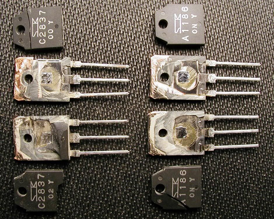

Hi Chris,
I cut open the case on four of these using a cutoff disk in a Dremel tool. They did not open exactly the same way as the ones seen at Elliott's site, but they look good. The die is about 4mm on a side which makes sense since they're lower power being 100W. Elliott was looking at higher power parts with a size of 5mm on a side, the fakes were typically 3mm.
The font looks exactly like this known good part shown at Elliott's site:
As I said before the font is heavy and the date code is centered.
You asked about quantity, this total lot of Sanken parts totalled
over 100,000 parts, close to 200,000. The highest power transistors are 125W, and the lot included other parts such as diodes and voltage regulators. I won't list the numbers here since people seem touchy about this sort of thing.
I'll try to get some pictures soon.
Pete B.
Pete B.
Hi Pete,
I'd say those are real.
Was the dremel fun? You must have had a foul smelling dust storm there. I hope you were wearing a mask!
-Chris
-Chris
The way in which that die is attached to the copper tab seems quite strange to me. Genuine devices shouldn't have any kind of substance around the die, either white or transparent. Also, genuine devices shouldn't have lots of solder around the die as if it was soldered by hand there. I know that this picture is not yours and is taken from Elliot's site, where he believes it to show a genuine device, but I'm in doubt.

Eva said:The way in which that die is attached to the copper tab seems quite strange to me. Genuine devices shouldn't have any kind of substance around the die, either white or transparent. Also, genuine devices shouldn't have lots of solder around the die as if it was soldered by hand there. I know that this picture is not yours and is taken from Elliot's site, where he believes it to show a genuine device, but I'm in doubt.
I wondered about that also, Eva, since they said the fakes had something like silicone sealer over the
top of the die. I don't think that's solder in that picture, looks to me like some kind of goop, but I'm not
sure you could be right.
I believe that die coatings have been used, over DRAMs for example as a sheild against alpha particle
radiation which causes an increase in MTBF of soft memory errors. The plastic package was molded
right over the die in the parts I opened. I'm not sure how these Sanken plastic parts are fabricated.
Pete B.
Hi Pete,
I've seen some die covered with some kind of clear sealer before in parts I know are real. Factory original dead things.
Yeah, the encapsulent can smell pretty bad. I've opened a few in years gone by.
-Chris
-Chris

as to the use of "goop" on dies..... i have seen the inside of a lot of motorola to-3 transistors, and they always have a drop of clear silicone rubber rubber on the die.
Sanken Pictures
Pictures I took of the Sanken parts:
I got a bit too close with the cut off disk and ground off
the plating and exposed the copper on a few of these:
http://i150.photobucket.com/albums/s109/BASCON07/SANKEN/CLOSE.jpg
http://i150.photobucket.com/albums/s109/BASCON07/SANKEN/OPEN.jpg
http://i150.photobucket.com/albums/s109/BASCON07/SANKEN/CLOSE_OPEN.jpg
These parts look good as far as I can tell.
Pete B.
