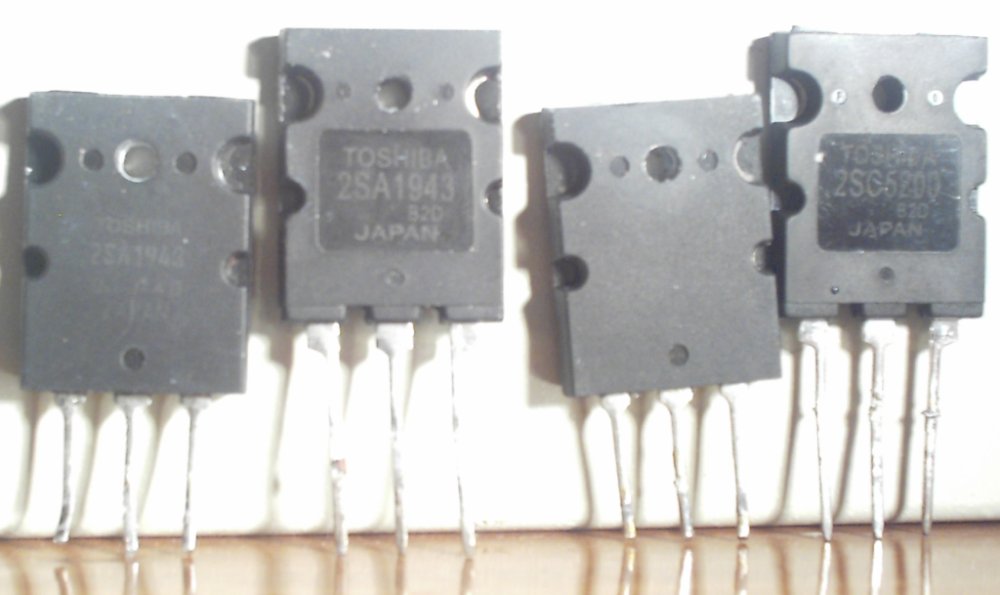

Hello there people.. i have been doing much reading of this forum recently and learned much from you all. in particular i have been reading up on these counterfeit transistors....
pictured are 2 5200s and 2 1943s... for each, 1 genuine, and 1 presumed counterfeit.
my question is only this.. The ones with the clear markings in the smooth rectangle have been mentioned many times here and elsewhere on the web, but does anyone know for certain if Toshiba have ever manufactured transistors in this exact packaging?
if someone with more knowledge and experience than me could clarify this once and for all, it would be helpful to many people to have such an obvious difference clearly acknowleged.
apologies for the quality of the photo.. i really did try to get a good clear one.. but photography is not a skill i have.
