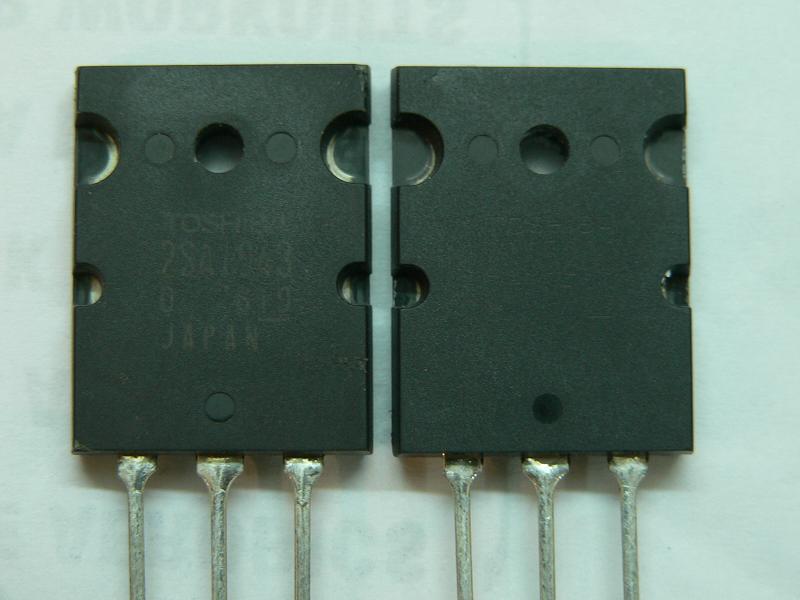

sbrook said:Look at the *difference* in those heatsinks!
The ones to the right, with the stamp can't be flat on the back! and look at the irregular top of the heatsink. They SCREAM FAKE!
I agree at 100% 😀
but I don't understand from where all these false bjts come
Like where did this melamine tainted gluten that found its way into pet food come from?
From small to medium size companies in countries with little to no care for who they rip off and are desperate for western currencies.
Goodness knows it's easy enough to do ... get some metal to fabricate a heatsink, buy cheap transistors to put inside the case so the leads show something like correct characteristics then pot them in epoxy and paint the numbers on.
Then you sell them through middle men who will take the fall. Or sell them through things like ebay (sadly, while ebay is brilliant, it's also a terrific way to market knock off products). If a large electronics distributor has need of particular components and he sees a supply available, he'll buy to meet that need, not always checking quality or source. Of course, if he asks for samples, they'll send a few of the "real thing".

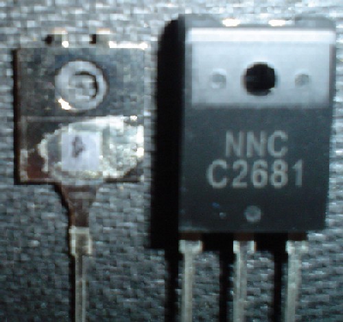

Anyone ever seen these, or heard of the brand ?
The number is supposed to be an NEC(ETC), became obsolete in 2002.
I also got a bunch of the 2SA partner from a different source, but those do read NEC.
These devices are supposed to have a 100 watt rating and an Ft of 80/90 MHz.
The capacitances measure ok but it has an insulated casing, similar to TO-126 and some TO-220 Sanyo devices.
Haven't put one through Eva's full force test yet.

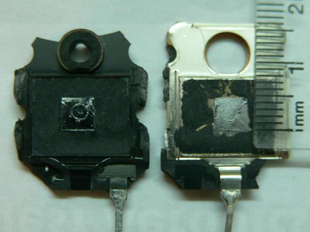

Hi Jacco,
can you tell from the damaged one what size the chip is?
I see a pale grey square and a dark triangular patch, which?
Can you tell what material (and it's thickness) that stretches across most of the width of the backplate?
I'm a bit of a brute, i opened the case with a nutcracker.
Touching a wine glas has been a no-no for like 25 years, i can torque the thread off the most incredible size hexagonal nuts though. First time i'm opening up a transistor.
One half of the die is left on the epoxy that cracked off, the triangular patch is part of the intermediate layer of the die.
The die measures a wee over 4mm x4mm, measured the metal bonding plate by hand and the die from an enlarged digital pic.
Also the first time i see a fully insulated device of this size.
