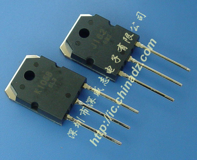

Hello!
What do you think about this MOSFET I think this is counterfeit? I have never seen this MOSFET in this case. Its looks like professional but I think it doesn't mean anything. If I search in google 2SK1058 I found only in other case. .
I try to measure the Vgs/Id characteristic but it wasn't successful and at moment its behavior is like should be shortstop between Drain-Source legs. Presumably its dead.
Earlier I measured IRFP240 and it worked very well. Of course I used same measure circuit but the components have different values because IRFP has higher Vgs value.
Does somebody have measure circuit for 2SK1058?
It would be very important because I have started to build hybrid amplifier and I would like use 4 pieces of 2SK1058.
I'm going to order matched them for safety sake from Borbely Audio. I would like to draw characteristic curve for every MOSFETs.

topicreader said:I don't understand you jacco vermeulen. What is your problem?

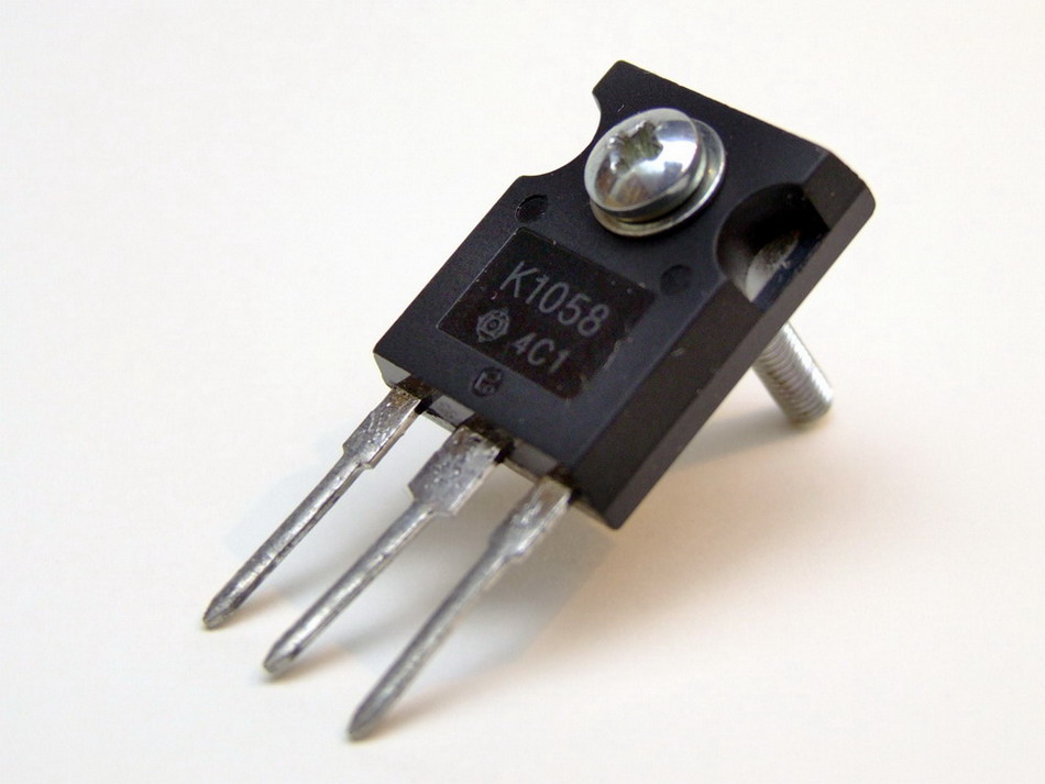

Here is an original 2SK1058 and I can see lot of difference between the two device.
In the datasheet case of semiconductor also like this.

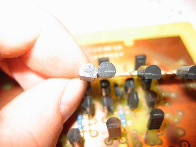

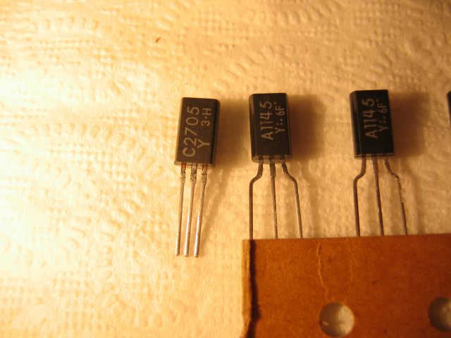

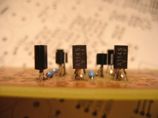

2SC2705-Y and 2SA1145-Y
I acquired some of those some years ago and bought lots more just a couple of days ago. The problem is, they don't look the same. I'm quite confident the ones I bought some years ago are originals. Now I want to find out whether Toshiba changed their package or whether I was sold counterfeits... Can you help?
First picture shows the transistors which I believe are genuine.
OliverD: Without electrical measurements, it's hard to be sure, but from appearance your taped 2sa1145s are also authentic. I've also seen taped 2sc2705s that look similar to your taped 2sa1145s, with splayed legs.
Thank you.
I took some basic hfe measurements with a simple multimeter, and both the suspect and the genuine parts were ranging from 136 to 154. This is within the specs of the yellow rank, although on the lower side. What else could I measure with simple means?
For a small-signal transistor, that's about the only easy measurement. Counterfeits often have suspiciously high hfe in the range of 300 and above - 130+ is OK, especially if it's clustered pretty tightly without large deviation. It seems genuine.
