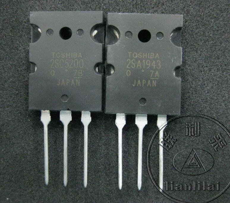

"SC5200+2SA1943" from Toshiba with Runaway of the adjusted Idle Current Value
By the repair of the damaged pure class-A integrated amplifier Luxmann (Luxmann) L550 (L 550) I note, that the shortly ordered output devices from Toshiba (about Nedis) don't work how they actually must.
The behaviour is exact in that kind, as if I had not screwed the transistors on the heatsink (respectively as if I had used thermal isolated insulating slices - but I use mica washers).
This means, the internal chip haven't contact to the die.
I guess, I have fakes resp counterfeits, although from the typeface (kind of font) nothing is striking to see.
How I can open this kind of outline (seems to be more difficult than TO-3) ?
Are there such observations were already made?
Thank you for your comments.

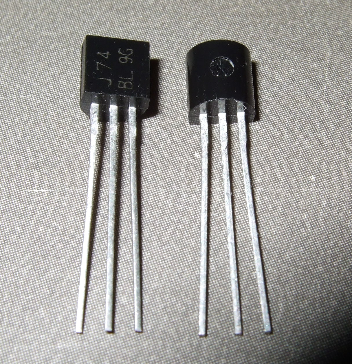

What do you make out of those JFakes, eh sorry, JFets?😀
They measure ~6mA in majority. Got just a few to check out. Legs longer than other Tosh, x mark inside the back circle unlike other Tosh having none. Unless they packaged any outside Japan, they are highly suspicious... Is anybody having any J74s looking like those, knowing more?

here the attachement of the transistors mentioned in my previous post. Please note: this isn't my own foto, but the kind of font is the same.
by the horizontal scratching across the face as if the case was shaved, i would say they are fakes. the font and everything else looks corerect, but the surface finish is not original.... upon further inspection the dot in the date code is too far to the left of the date code digits. it looks like * 7A when it should look like *7A
I had similar typeface on the 2SJ74 JFakes made by laser burning (or some other artifice) of the letters in the plastic, with rough edges in the letters. I would not trust them 😕
I got same leg model. And I did not buy cheapo.

Clamp the transistor with the wires in a bench vice and with a knife and hammer split the 2 halves. With a little luck it opens nice..
Good luck, Loek
Thanks - yes this is so. Size of die looks correct.
How I can check the internal thermal resistance between the die and the metal heatsink face by a device, that is yet not damaged ??
