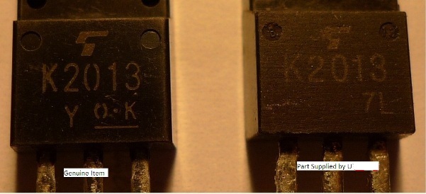

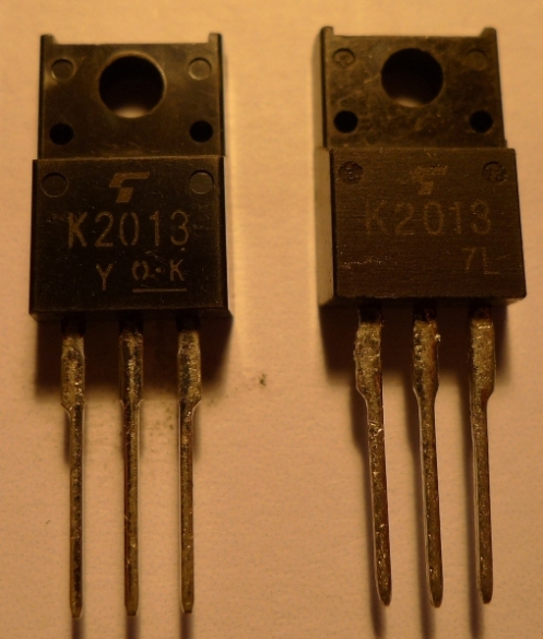

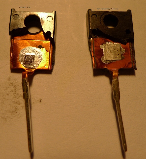

It's quite clear from the closed up picture. The original lettering on the item in question has been shaved off and re-screened. I also popped them up for comparison. The left one was my genuine part.

yup the one on the right has been shaved, and the date code is a different format than what Toshiba uses, because the gain code is missing. also the mold marks on the genuine one are blank, the fakes have lettering in the mold marks

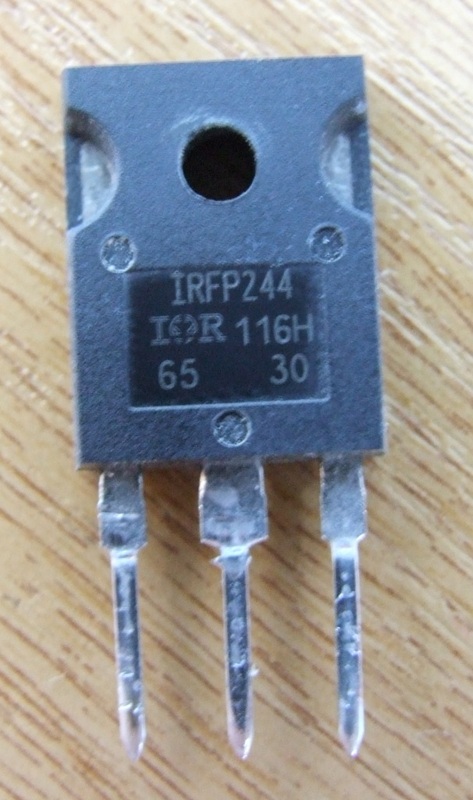

This is an example of a batch of over 100 IRFP244s that I bought from a vendor in the UK.

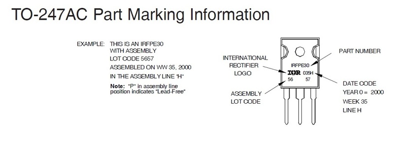

This is what IR say they should look like.
This is what I have got.
Is it me or is the typeface out of line ?

Batch codes are often printed using a different print head than the company logo, since the logo artwork stays the same from run to run. So the registration even on a real device may not be perfect, depending on whether they use a single or two head printer, or a movable batch number wheel windowed into the logo plate.
As the label is recessed, I find it difficult to believe that these have had their part numbers ground off to make way for re-badging.
