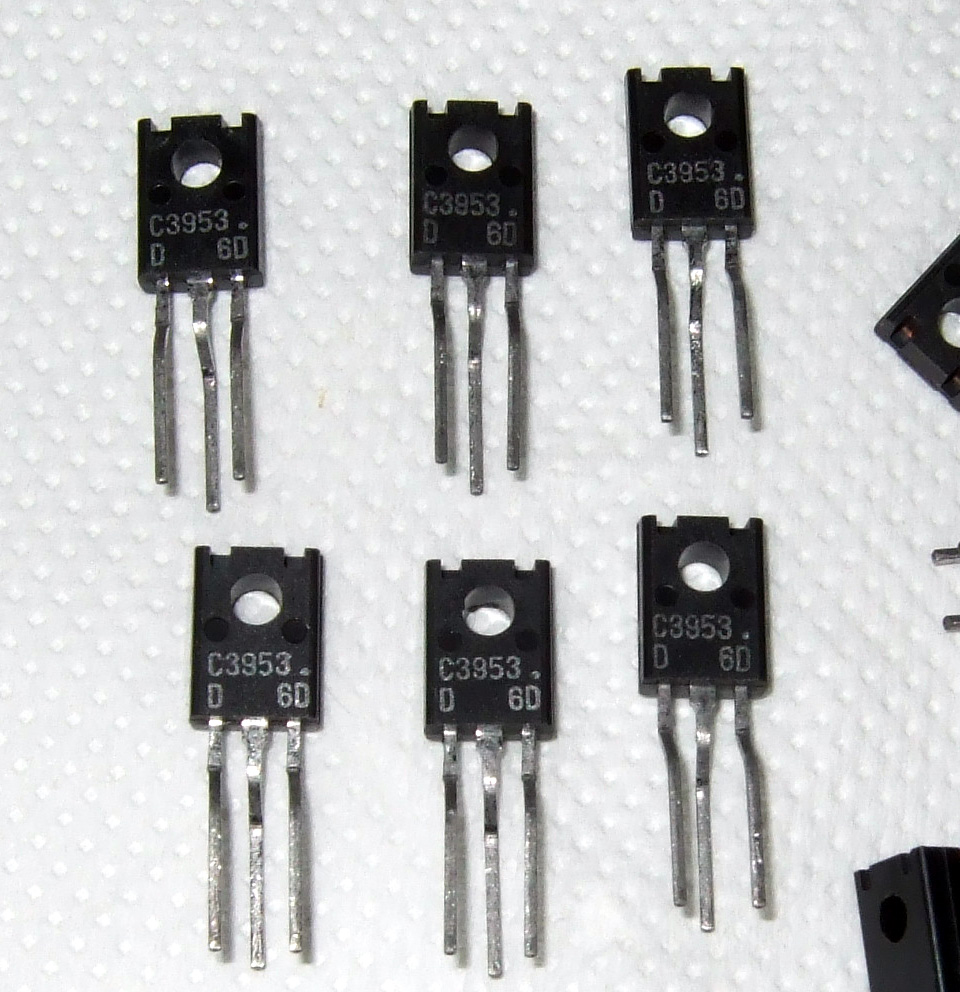

My Transistors, original or copy?

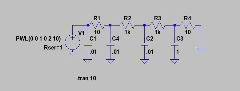

in thermal dynamics, the heat sink tab is a resistance, as is the interface between the heat sink tab and the heat sink (which is usually a much higher resistance). the mass of the heat sink tab and the mass of the heat sink are figured as capacitances. the "charge" on the capacitances is temperature. you can actually model this as an RC circuit in LTSpice. in the following drawing, V1/C1 is the chip itself, R1/C4 is the heatsink tab, R2/C2/R3 is the interface (heatsink insulator, etc...), and C3/R4 is the heat sink. as i said, the capacitances represent mass, and resistances are thermal resistance of the thermal component. the capacitance would be more accurately represented by the specific heat of the material times the mass. the resistances would be in degrees C/Watt.

The more shabby Japanese devices look, the bigger chance of being genuine, imo.
So these look fine to me, identical to mine.
Couple of years ago i would have thought chances of Sanyo video TO126s being faked would be relatively small.
Used legs and the correct package details, safer bet than sparkling beauties.
(but what do I know, they shafted me with dual JFETs twice now. my machismo shell may have cracked on the surface only, but my gentle breeze inner nature still feels fragile, soiled and violated)
2sc3953 is good for VAS & Pre-Driver duty.
120Vce0 is a limitation.
It has flat gain from 3mA to 90mA
It has fT~230MHz @7mA
Your Dgrade 60 to 120 hFE @50mA is a bit low but you are never going to use them at that current. Check hFE @ a more usable current for your use.
