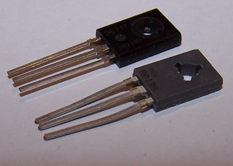

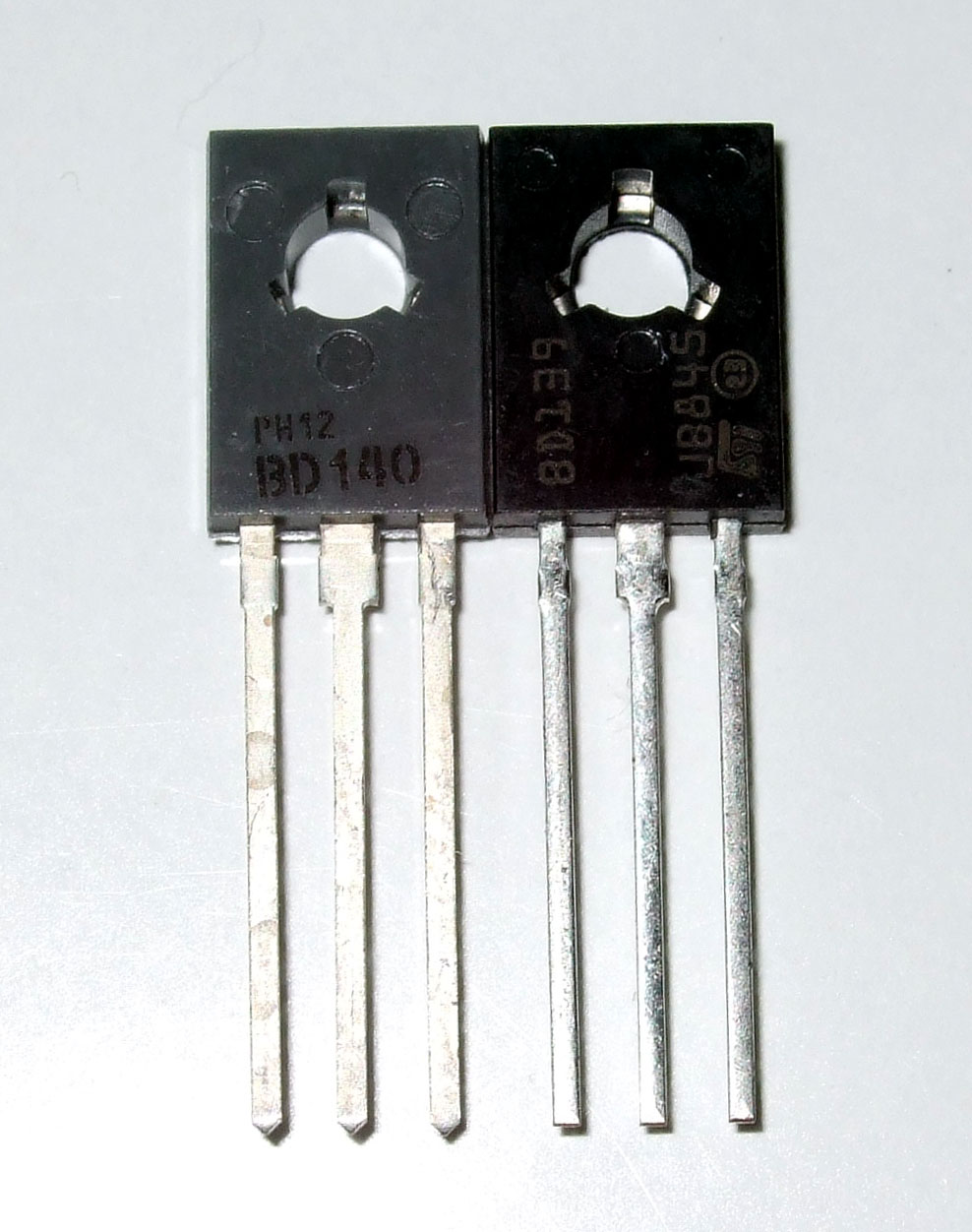

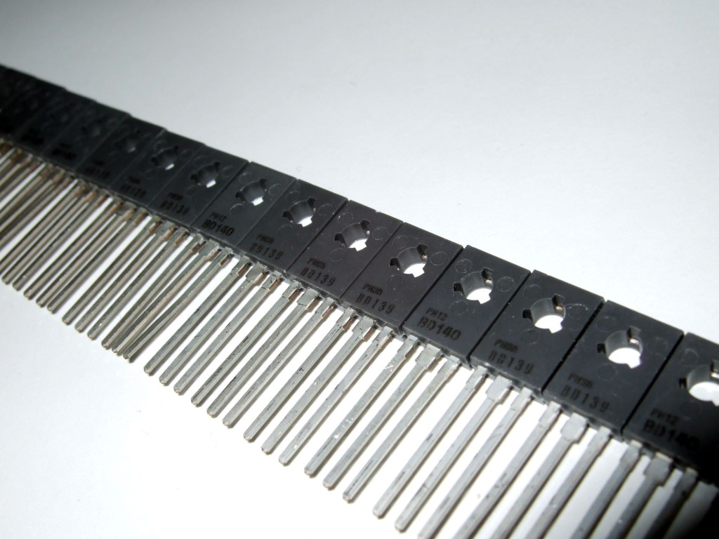

Found a last forgotten batch in the drawer Philips looking bugs in a small store. ST and ON is what I mainly see in stores. They measure circa 150 hFE very tightly between NPN-PNP, all of them. The ST I also got some to measure had 210NPN-110PNP on average. The BD139s have something illegible like PH3B or PHBn when the BD140s have PH12. Are those the small die high Ft proper Philips ones?
If the plastic is grey (the ones in the photo seem to be), they might be genuine Philips transistors.
BUT... one of our customers uses BD139/BD140 in some designs. The BOM says we must use ON and "do not use Philips". I don't know the reason for that, but I can't imagine counterfeiters are interested in copying something this cheap.
EDIT: About 12 years ago I built a class A headphone amp which uses BD139/BD140 in the "power" amp. One of the two types were Philips and looked very similar to your's.

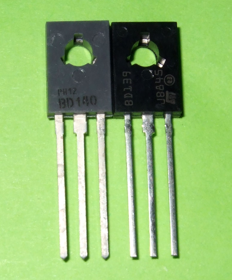

Hi, thanks. They are grey indeed. Its that ON and the others produce another die. More rugged but much lower Ft. There is some certain frequency compensation in those designs and they know it will not be compatible to Philips most likely.
Crooked printing :yes.

I've got about a thou of the 139/140 in 10-16 dress, nice generic part to have plenty in stock, built up to 10-pair Class A output stages with them, the 3.2 Rjc becomes a relative number with plenty in parallel.
Printing might be straight on a good day... 😉
When building the headphone amp I bought a few extra, just in case, I found them stashed away somwhere.
Probably another thing to recognize the Philips' genuineness by is that the leads seem made from a softer metal (more copper?) than most others. These are quite easy to bend. They are slightly wider too which is hard to see in the picture, but if you lay the Motorola on top of the Philips, you'll see that the Philips' leads are ca. 1 1/3 the width of the Motorola.
