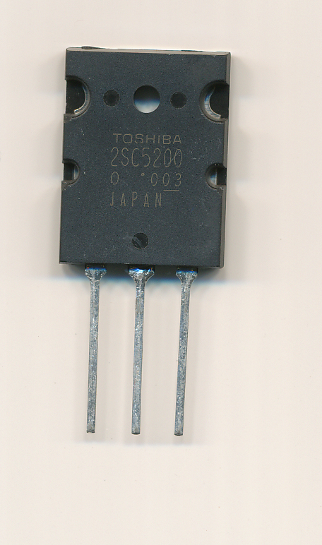

query about pedigree of my toshiba sc5200 transistors
I recently bought some of these transistors from a fairly reputable (?) company called Futurlec. However because of the faint printing on the face side I have doubts about whether these are genuine Toshiba products. Can anyone tell from the picture whether or not these are genuine?

assuming those are genuine for the moment, i'm drooling...
you need the data sheet, and you need to physically compare them to known originals. then if they are physically correct, the junction capacitances can be compared to known originals. for further testing, a curve tracer with the ability to nondestructively detect secondary breakdown is required (and for that many devices, the curve tracer is probably the best route to go)
