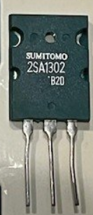

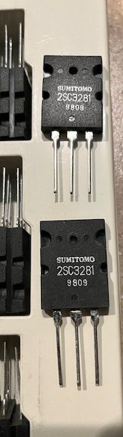

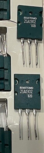

I have been offered the chance to buy a couple hundred of these "Sumitomo" 2SA1302 and 2SC3281.
I have read that Sumitomo made and possibly still makes lead frames, but I've not read about them making these transistors back in the late 1990s. They were obtained by the seller from an amp manufacturer about 15 years ago, but I don't know if they were ever used in production, or if they are legitimate.

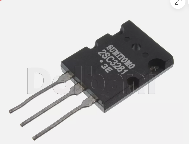

There are "NOS" Sumitomo 2SA1302 and 2SC3281 for sale on the auction site, but they don't look legitimate to me.
Anyone have insights? Thank you!

Current production at Sumitomo is wafers and Blu-Ray lasers, no devices.

Perhaps those were Toshiba made, and made for Sumitomo. If they made equipment that those parts went into (and would be the only factory-authorized replacement). In the same way as Motorola parts were marked Krell, Crown, or Peavey.
1999 would have been right around when Toshiba quit making C3281 and replaced it with C5200. I know Digikey had both for a while back then, but they were phasing the C3281 out.

Fwiw the fact that it seems to have lettering that doesn't look quite straight would put me off. Also the wording has MO at the end of SUMITOMO looking bigger than the other letters.
Not saying this is or isn't genuine but it looks more correct.

Thank you all, for these comments. Any interest I have in them is for replacement in amps I'd be repairing, and since these are no longer produced, if the price was right and they were not known to be fake, I had the same thought to ask for samples so I could put them on my Tektronix 577 to test.
Since I've never seen Sumitomo devices before, I was already suspect; add to that the same thought I had as @Mooly that the lettering doesn't look quite right.
With current production parts, I always buy from the big houses, but with out of production parts, having a supply for working on some of the vintage amps I've been fixing would be useful, and they are sometimes only available outside of those sources.
I'll start with asking for samples to test on the curve tracer, maybe cut one open, and take it from there. Thank you all!
