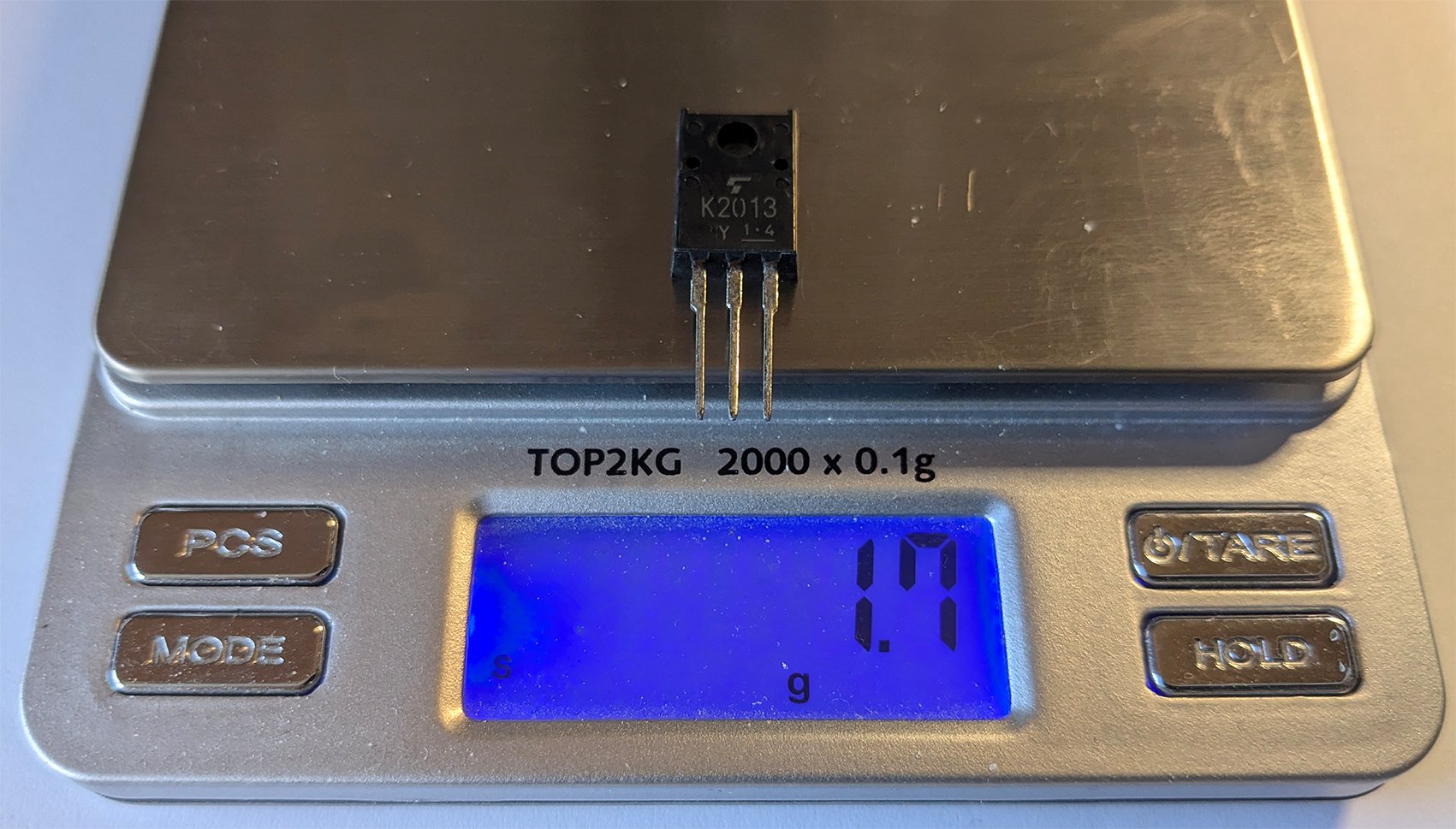

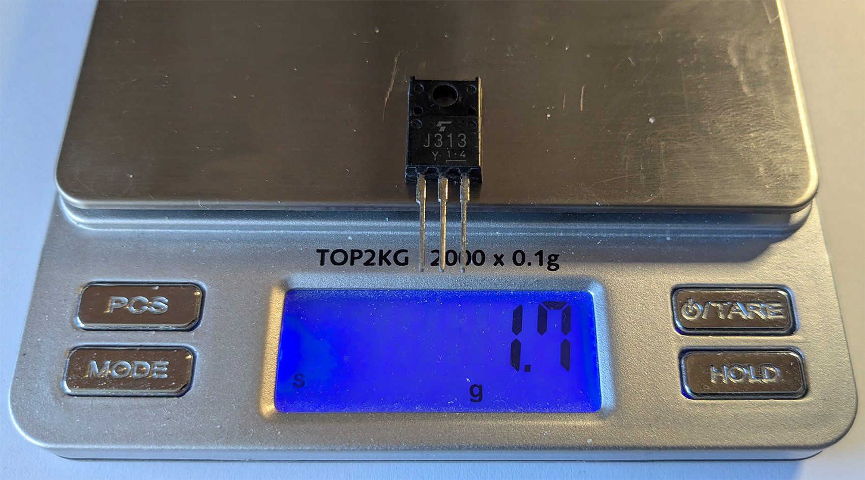

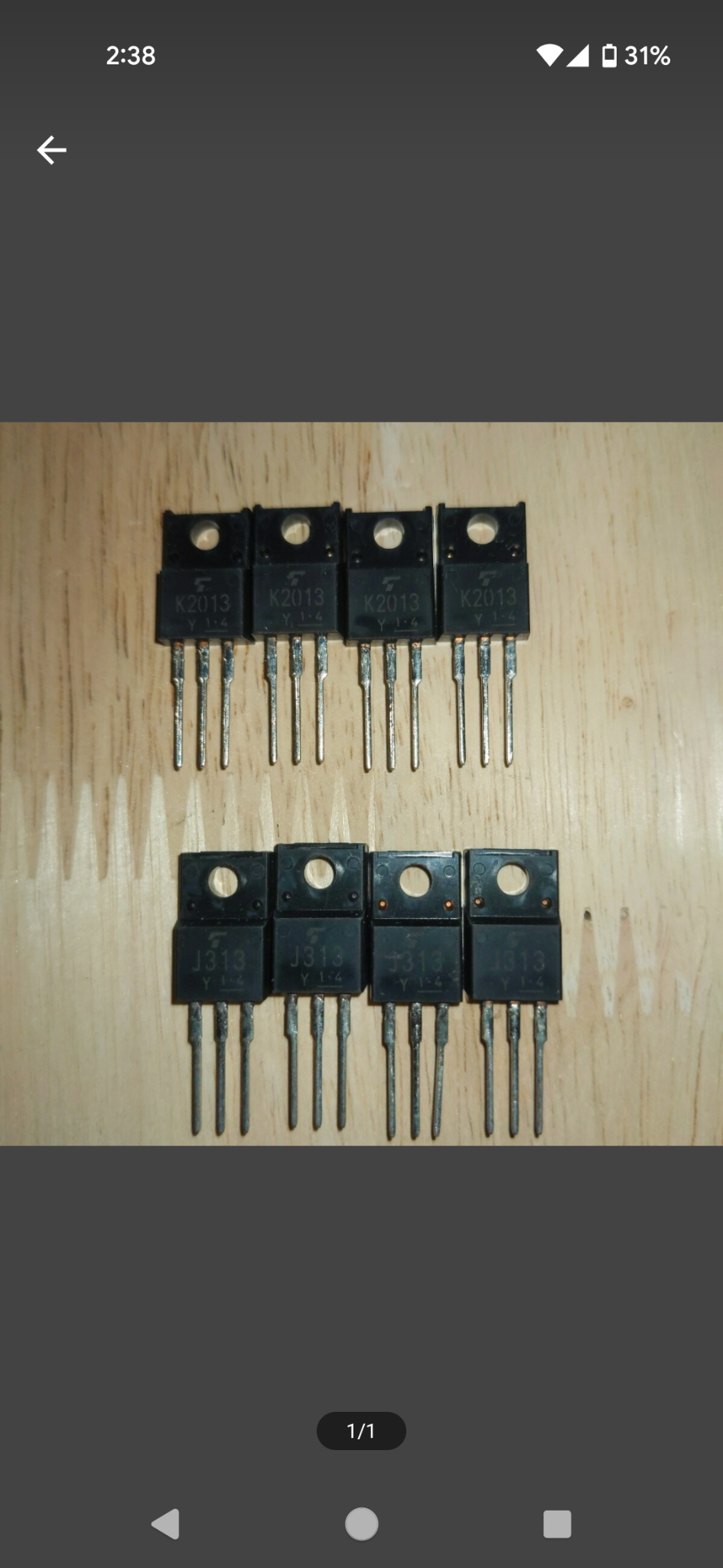

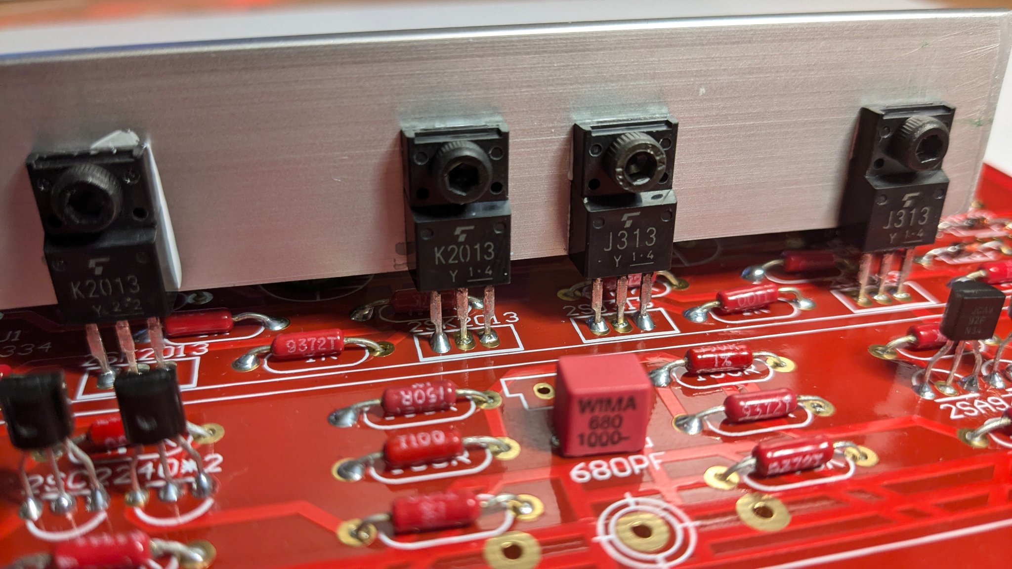

I bought these from China on eBay. Seller says they are old stock and included old shipping boxes and label pics in the sale listing etc. They were not cheap, as they should not be. When confronted, the seller demands they are not fakes.
They arrived batched and sorted and each was labeled. They test perfectly. They seem good on the weight scale too.
So what do you think? Real or fake?
A significant deviation on the scale is often a dead giveaway. Part of the picture.Weight has more to do with the case than the silicon.
They measured fantastic and they were matched and batched and labeled.
Indeed.That looks genuine.
I think I have a chicken winner dinner.
I'm kinda surprised. I always thought it was a good sanity check.If the weight is that far off, I would be amazed.
I've had some doozies that were so far off it was outstanding. When you provide all the poor data it helps getting a full refund and not paying shipping fees etc.

Most of the mass is in the case and heat spreader (metal tab). So if it is really off, they used Aluminum instead of Copper or Steel. But some legit transistors used aluminum cases (TO-3 for example). The actual die wouldn't be much different compared to the mass of the case.
Interelectrode capacitance is one indicator. Beta or Idss / transconductance measurements help. Breakdown voltage helps. I use a 300 VDC low current current source for most (HP 6186C). Then tests can get more involved, like a curve tracer. But the data sheet indications of package markings is an excellent test. Laser etched cases for old parts is a clear giveaway (=FAKE!). "New manufacture" for old, discontinued devices is another. Brand markings. In the JIS program, a device number is only made by one manufacturer, period. Not like in the US or Europe.
Yeah, dodgy responses from the seller is always a huge warning flag.
For me, I haven't got the time to vet each part, so I buy only from authorized distribution as a rule. Failed parts cost too much in troubleshooting time or taking other parts out with them. Then there is my reputation. Mystery parts are a no-fly option.

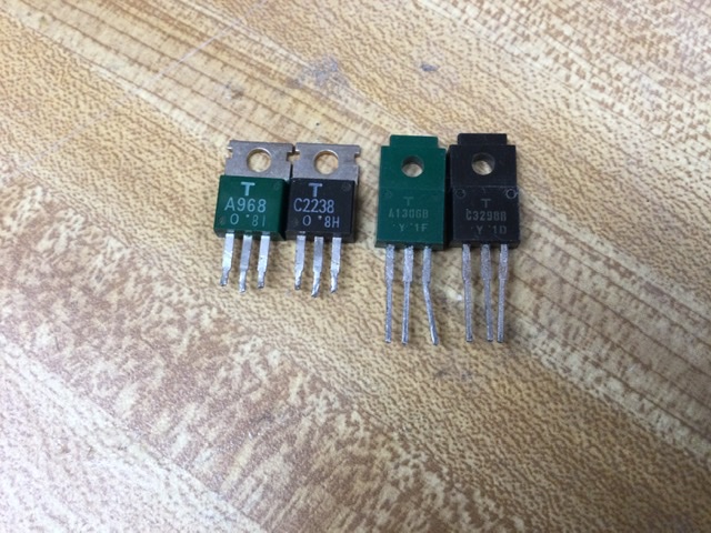

RealI bought these from China on eBay. Seller says they are old stock and included old shipping boxes and label pics in the sale listing etc. They were not cheap, as they should not be. When confronted, the seller demands they are not fakes.
100% original and possibly made in Japan, that solder dipped legs give away 100% made in Japan vibes to me.
Even toshiba don't always marked made in japan in some packagesAnd to add to the mess, some Japanese companies put 'Japan' only on parts made in Japan, and not on parts made in their factories outside Japan...
Even toshiba don't always marked made in japan in some packages, even though they are 100% made in Japan, that the case for some small packages of transistors, like To-92 and TO-220 and some TO-3P and there are many other cases too, which aren't big enough to mark due to size
Ones made in Japan would be marked as such if there is room, and always marked on factory pack. Anti-stat tubes would be marked, or a bulk pack box. Most Toshiba dies are still made in Japan, and boxes often say “Diffused in Japan, Made in China”. It could only me marked Japan on the package if it was all done there, according to their own documentation. Well, up till a couple months ago anyway there was a very easy way to tell on the Mouser site whose stuff was made in China but the waters are muddied now. On could tell for instance which OnSemi product was made in China by something mentioned on the price page. It surprised me to see just how much of it WAS, even stuff that was typically made in the Korea (Fairchild) plant.

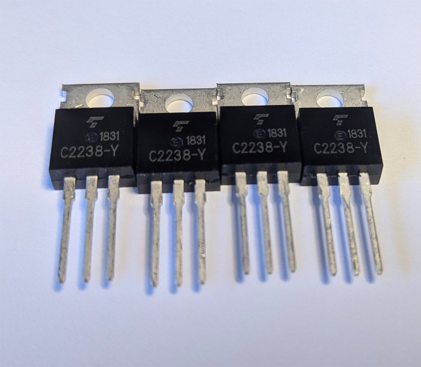

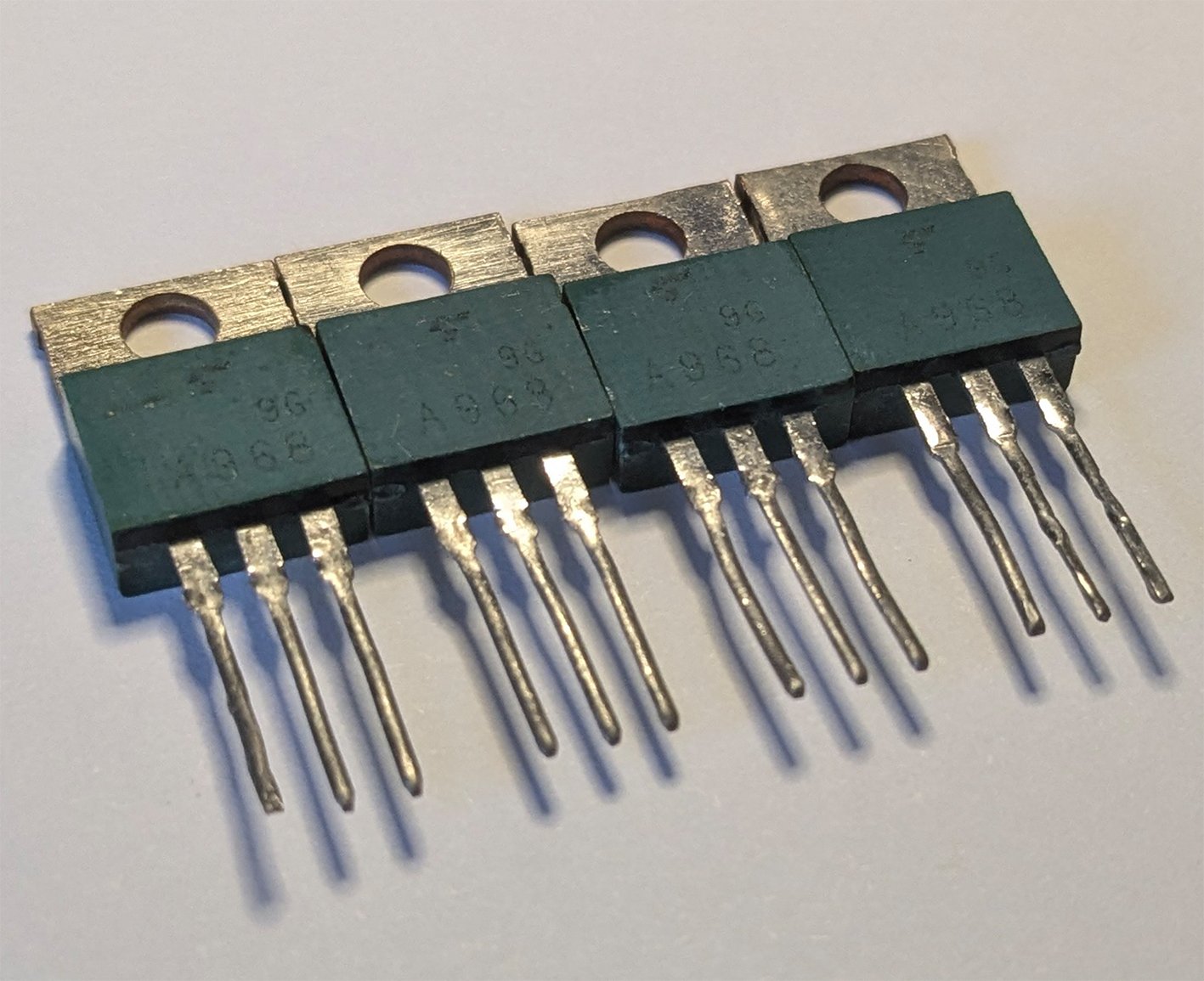

From ebay American seller.
2SA968
Hfe 118 to 146
Ie=6.3mA, Vbe=610mV-ish for all four
V collector to base - Vcc max 5.5VDC of tester, Cob = 108pF-ish for all four
2SC2238
Hfe 150 for all
Ic=1.5mA, Vbe= 586mV-ish for all four
V collector to base - Vcc max 5.5VDC of tester, Cob = 41pf-ish for all four
