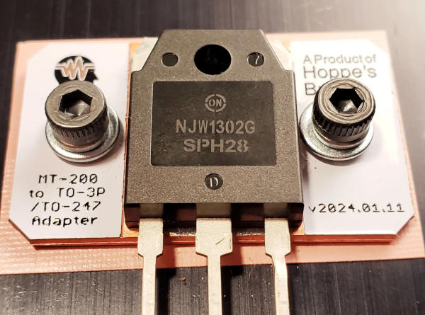

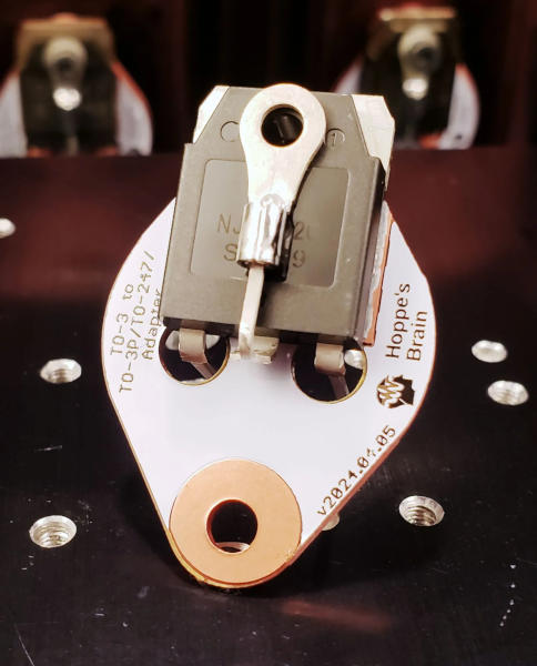

Those adapters from Hoppe's Brain looks pretty cool
https://hoppesbrain.com/product/to3-to-to3p-adapters/ web.archive
https://hoppesbrain.com/product/mt-200-to-3p-adapters/ web.archive
Scrolling down those two web links shows a pretty detailed description with pictures how to solder a transistor case onto the copper adapter, a quick skim through and the take away seems to be,
ps. click to enlarge images.

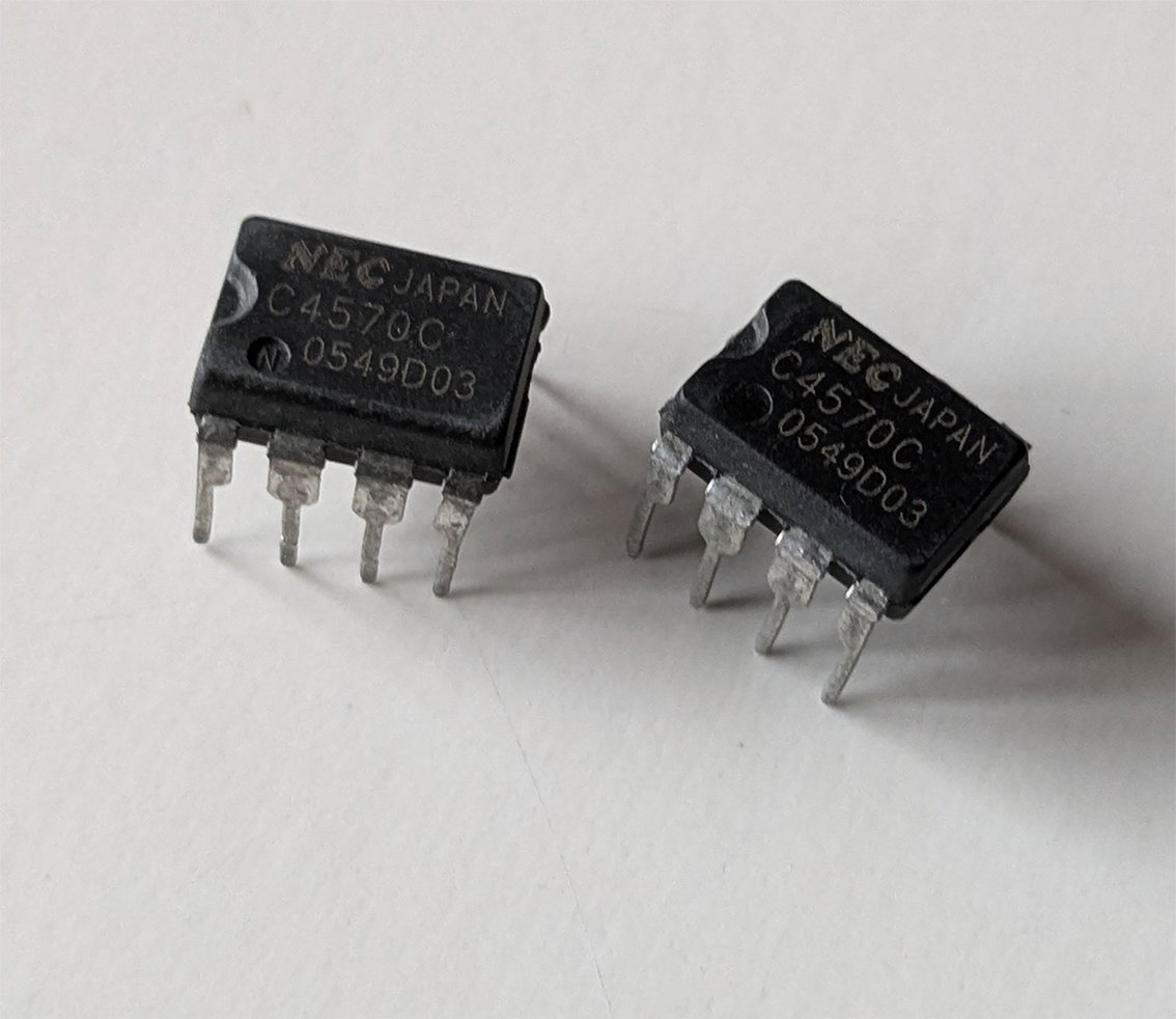

They look reasonable maybe.
Where did you get them, and were they "new manufacture"?
I have some original ones, the "NEC" print is smaller and finer, the rest more coarse. Enough so I am suspicious and where they came from may tip the balance.
Not sure what the point about these is. You could fit the non-TO3 transistors in the same way to the heatsink without the Brain plate in between (outer pins straight to their holes, middle pin bent up to the screw). Also, Brain seems to use anodized screws for electrical contact of the middle pin, which does not seem like a great idea to me.Those adapters from Hoppe's Brain looks pretty cool
I feel you might be underestimating the impact of a heat spreader. The 2sa1294 is rated for 130w, but that same package, welded on to an MT200 back plate is called the 2sa1295. Same wafer, just larger mating plate and is rated for 200w.Not sure what the point about these is. You could fit the non-TO3 transistors in the same way to the heatsink without the Brain plate in between (outer pins straight to their holes, middle pin bent up to the screw). Also, Brain seems to use anodized screws for electrical contact of the middle pin, which does not seem like a great idea to me.
This adapter is not necessary as you suggest, rather another tool for thermally managing total dissipation. Given the kind of heatsinking available.

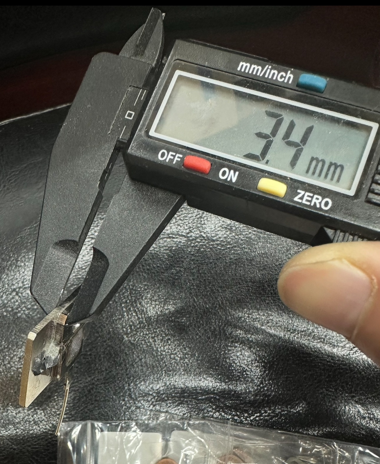

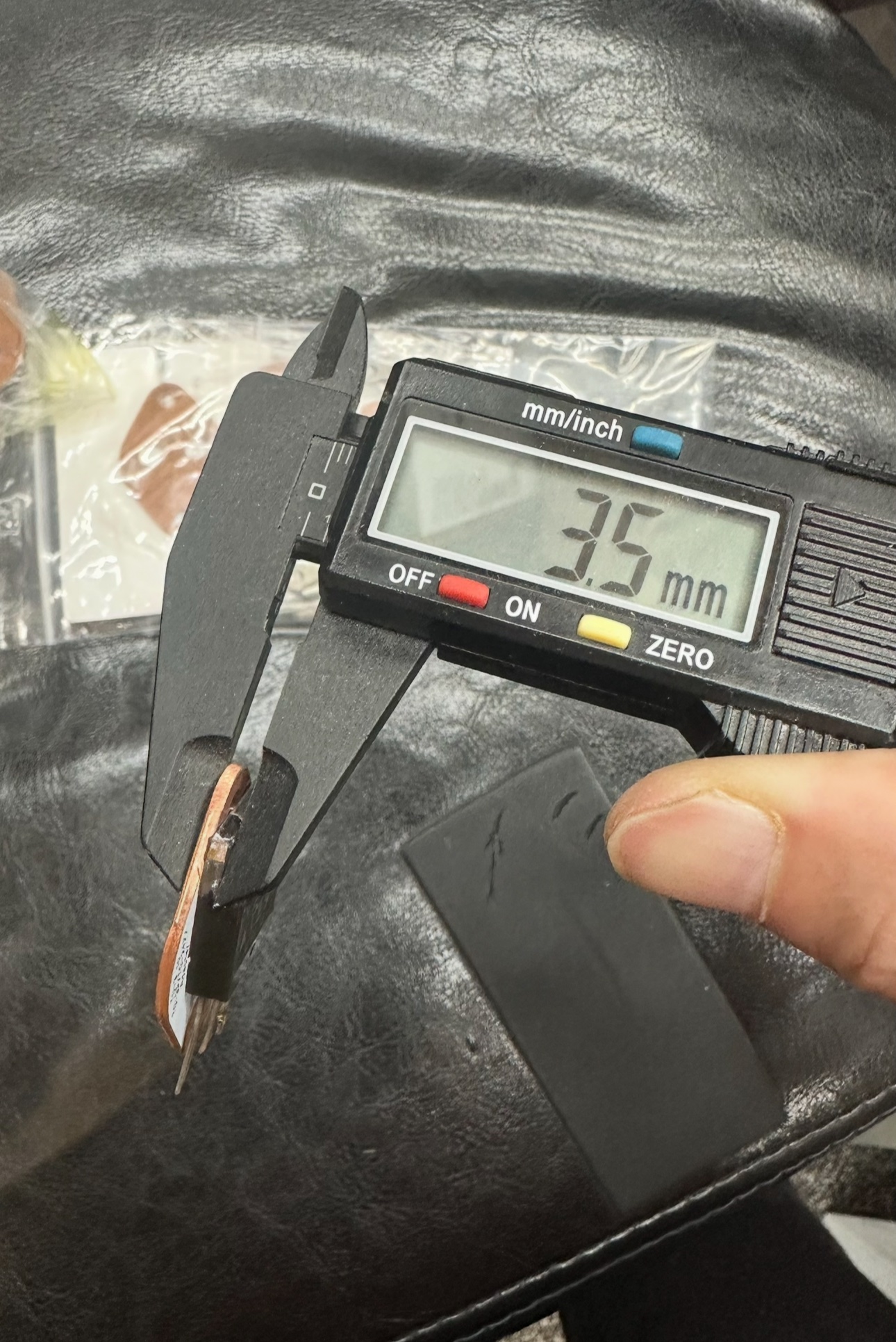

The backplates for MT200 are thicker than the adapters are. So that puts you somewhere in between. Better, but not equal.
MT-200's don't use the heat-spreader for electrical connection to the collector, like a TO-3 does.
However, you can actually use black-oxide coated steel hardware for electrical connections, it comes industry recommended, and they work fine on TO-3's. (This was a surprise to me too but I did some research.) Black-Oxide coating is Fe3O4, (AKA magnetite) not Fe3O3 (AKA rust) and has much better electrical conductivity. Additionally, the coating is extremely thin, around 0.5uM, and cuts through on tightening the fastener.
Brass screws conduct better than steel, but a few mm of M3 steel bolt is going to contribute very little to the circuit.
ETP Copper as used in electronics has a thermal conductivity of 390 W/mK, and 6063 and 6060 aluminum used in heatsinks is 201 W/mK and 166 W/mK, respectively. This is why MT-200's have so much more copper mass than TO-3P's. Heat gets wicked away from the hot-spot under the transistor die quicker, when there is more copper, not aluminum. The heat-spreader increases the surface area of the contact patch where the copper meets aluminum, and reduces the delta temperature difference between those surfaces, so the heat is transferrered more efficiently to the heatsink.
