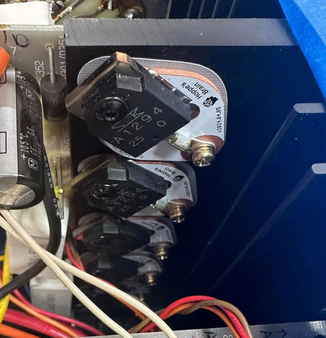

Which is why sometimes when I have the inclination, I do this... and LAPT out 😎.

I can see your points, but did I mention that the bjt is soldered on to the copper adapter, its not mated via an insulator.
The two variables that offset that a bit, are there are holes/ spaces underneath in the existing mounting holes, that will cause gaps in conduction. So a spreader is needed here. The other thing to consider is that the TO-3 heat spreader is one of the reasons a 150w wafer can dissipate over 250w in This package. Being copper, it will wick away heat faster than the existing anodized surface with holes… at least that’s what it feels to me.
The bjt is soldered on to the copper adapter, so decent heat transfer is assumed.
As for dual backplates, that’s what the Sanken MT200 packages were. The 130w rated 2sa1294, welded on to a larger heatspreader ( along with its own Native backplate) is what the big brother 2sa1295 was, rated for an additional 70 w using the same wafer… it literally is a A1294 welded on a separate MT200 backplate.
As for the bushing, I don’t use it anymore, the backplate is soldered to the copper adapter, it literally is the collector, all I need is a regular screw to complete the circuit just like all other TO-3’s do.
Well that’s what logic suggests. I am happy to be corrected.
Soldered is way better than using a TIM, if it’s void free. Not easy in a home brew setup. You have a vacuum reflow chamber? Hey, some people do, but not us through-hole holdouts who refuse to spend tens of thousands on “new tooling” to be able to use modern assembly techniques. Just properly weighted might be good enough here, but you still need your programmable pizza oven.
A bushing would be needed if a spreader wasn’t used. Otherwise the screw contacts the heat sink. That heat spreader could keep it aligned, especially if soldered because it removes a degree of freedom. Since my drilling is by hand and not CNC I tend to put sleeve bushings around the screws where it goes through, and pieces of heat shrink on the leads. I guess the Adcom heat sink was pre drilled so it should be pretty accurate.
Yes, predrilled holes and you are right, without the adapter, the bushing would help align. By the way I am a cheapskate, I use Solder paste and a hot air station to solder these together. Two alligator clips keep them in place as I heat them... Takes time and elbow grease but gets the job done.
Drill 2 holes in a piece of wood or aluminum using the adapter as a jig, and use it to support the bottom when clamping, or you may have space issue / damage the pins when soldering.
A blow lamp or heat gun may work for soldering the paste, but oven will be easier to control. And a coal fired BBQ is ideal.
