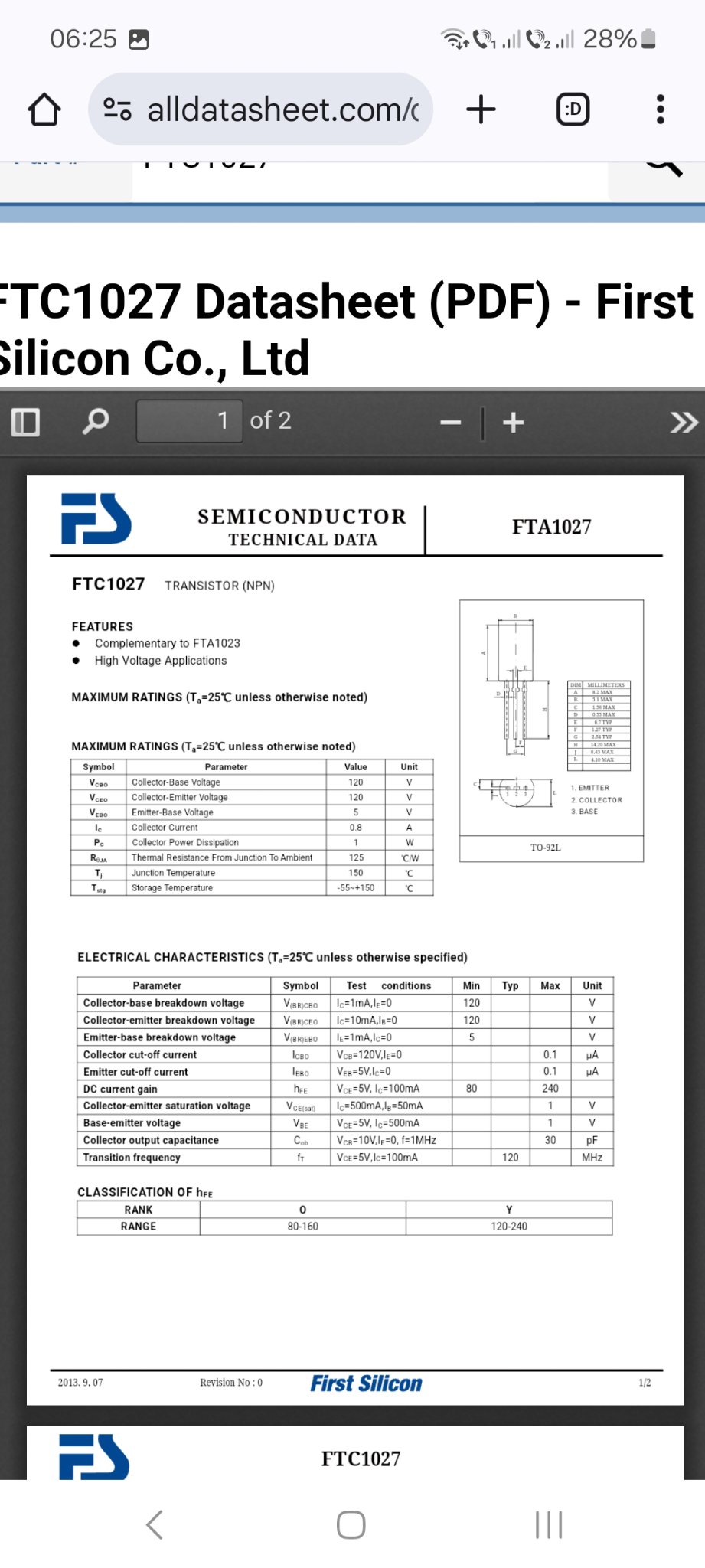

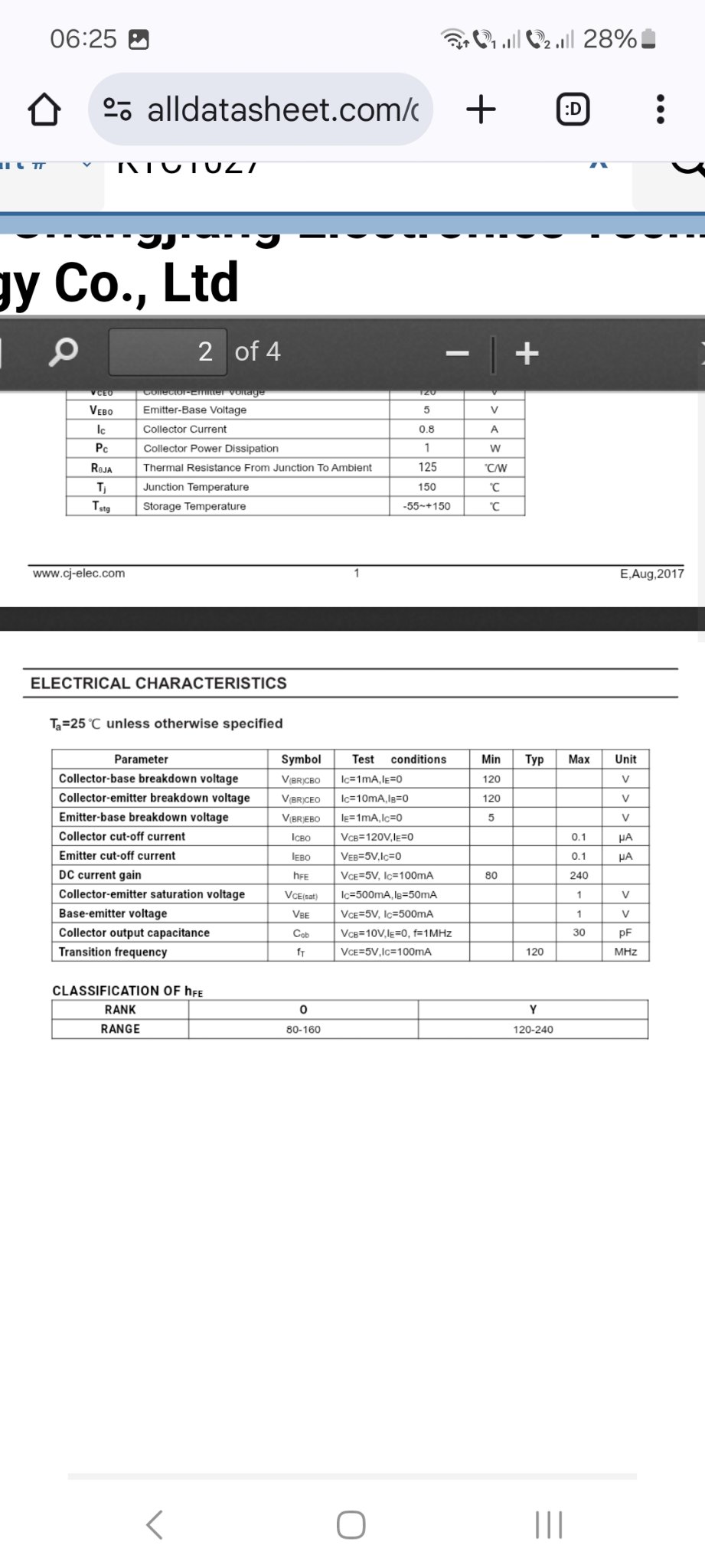

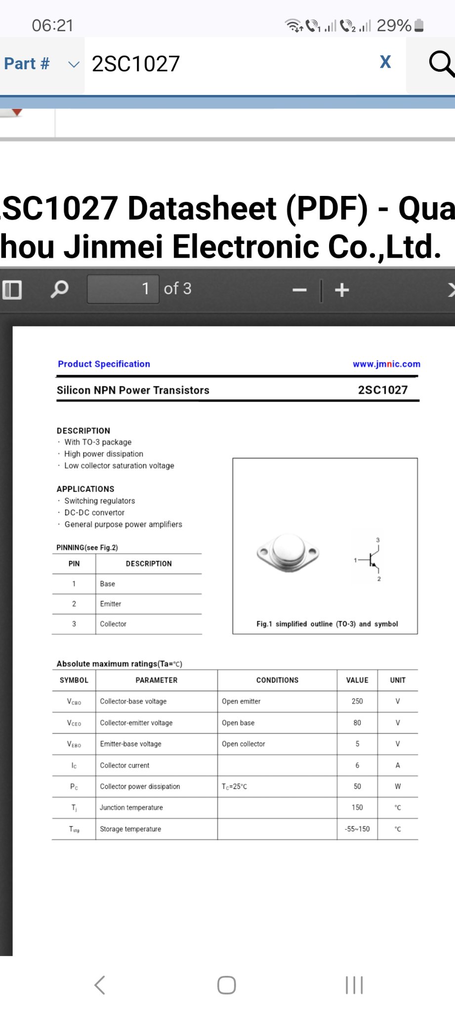

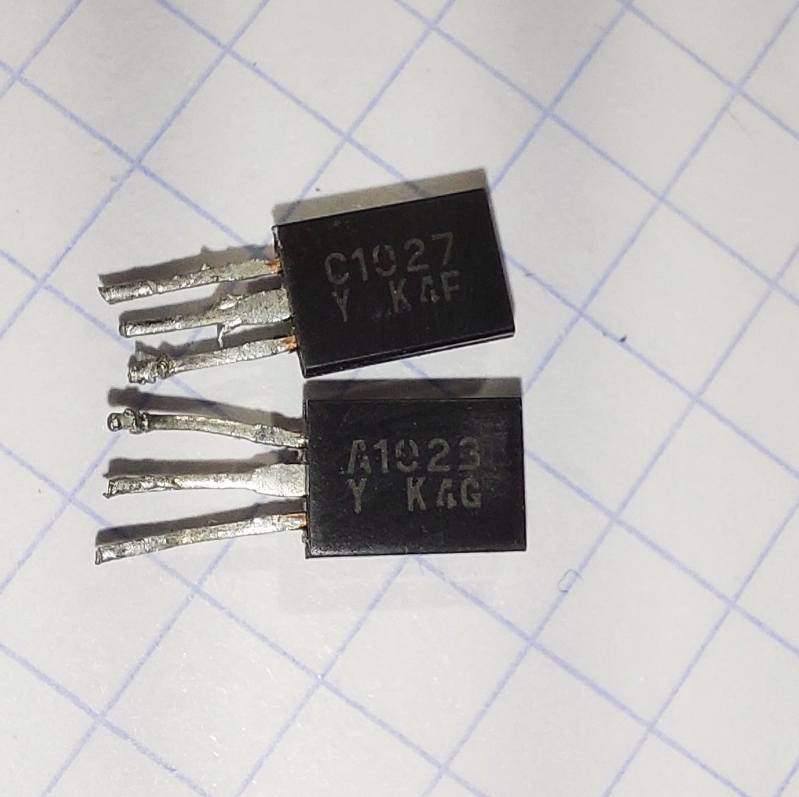

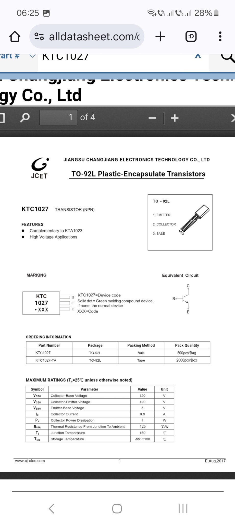

Hi, are these some re-named transistors ? Searching for 2sc1027 gives some power TO-3 . Only the 2sa1023 shows as it should . No datasheet tho.

I have noticed original data sheets are disappearing, now only "copy type transistor" manufacturing sheets are common. A lack of details means they haven't a clue what they are selling. That means the parts are garbage. To me, they are the same as remarked parts or factory rejects.
I don't think much of people willing to use that trash.
Unfortunately expect this more and more as originals evaporate. One of these days, perhaps in our lifetime, whatever becomes of ON’s core business will probably stop making all linear-audio-capable power semi’s and maybe even small signal parts - at least the pet stuff everybody uses. I am already well prepared for that day. But I may have at most 20 years of audio building left, and that’s under the best possible conditions. Realistically I expect 10-12. When they DO exit the market and sell only cell phone, EV, and energy-conversion targeted products, I sincerely hope they sell everything off to someone who DOES know what the f*** they are doing, rather than let the MJW3281 die. Like Motorola did with ON in the first place. When the only place you can get one is ISC, we are all in deep doggie doo.
