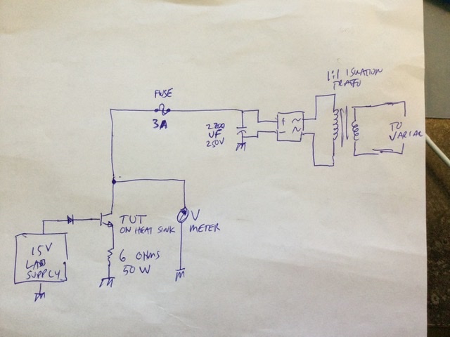

The fact that they are not known bad at least gives them a chance of being “good”. I would test SOA before using in any application where it needs to be that “good”. It’s not that hard to do - just a DC operational test at 2.25A, 80V for a second or two. You’ll find out in that second or two, although it takes all afternoon to set up if you don’t already have a jig.
No, they are not ISC for sure. ISC (or these guys whoever they are) might make a passable MJ15022 - they are not that hard to make these days. Where ISC fails miserably is when the device requires the original secret sauce to do well. Those Sanken MT200’s being the most obvious example and most often cited. They blow up in the applications, pure and simple. Other less demanding types do well. Drivers such and those Toshibas aren’t that hard to make these days either, and second sources for those types, which are rapidly disappearing from original sources due to lower demand, are coming out of the woodwork. Are they as good as original? Sometimes, sometimes not. Most recent I saw was for a new C4793, whose data sheet to me looked more like an MJE(F)15032. One could slap it in most places the original was used, and have it “work” reliably. Only the proper lab equipment would be able to tell you if the amp still met spec. Some people swear by the devices made by UTC and KEC. So far I haven’t seen anything “awful” out of them, but it’s not like I’ve used them by the hundreds or thousands yet so the jury is definitely out.
It’s just a CCS with a lot of degeneration, and a main supply you can’t kill with a short duration short circuit. Heat sink needs to be big enough that it doesn’t heat way up. If I want to leave it for a while I set the fins in an ice bath. Change the emitter resistor out for different current levels. I have a nice 6 ohm dog bone that works for MJ15024’s and a set of 4 4.3 ohm sand cast that give me 3A for a lot of other general testing (3A 50 V is common). Turn up the variac to get desired collector voltage, which is some 13-14V lower than the reading. Or tie it directly to emitter if you want to be precise. You don’t need to be.
