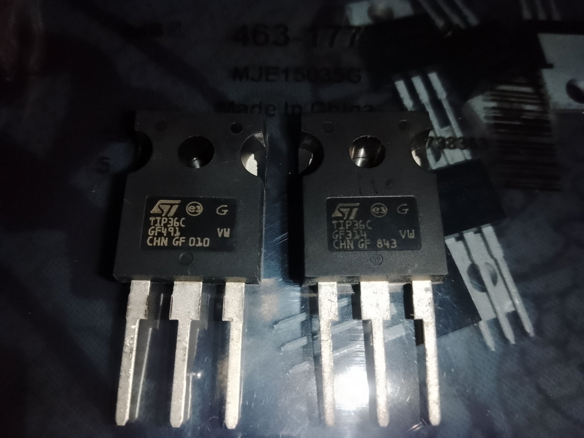

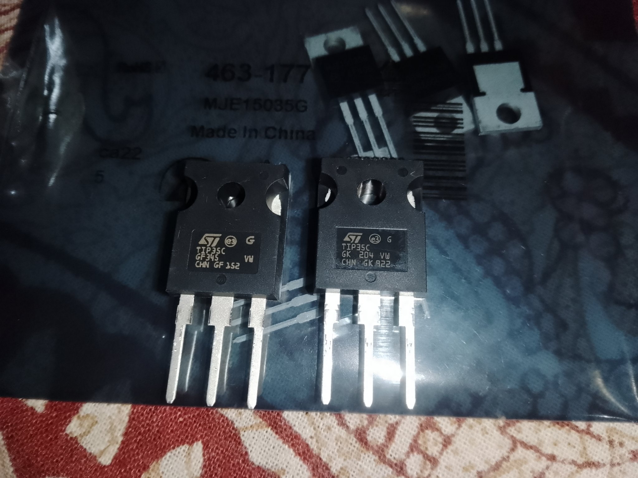

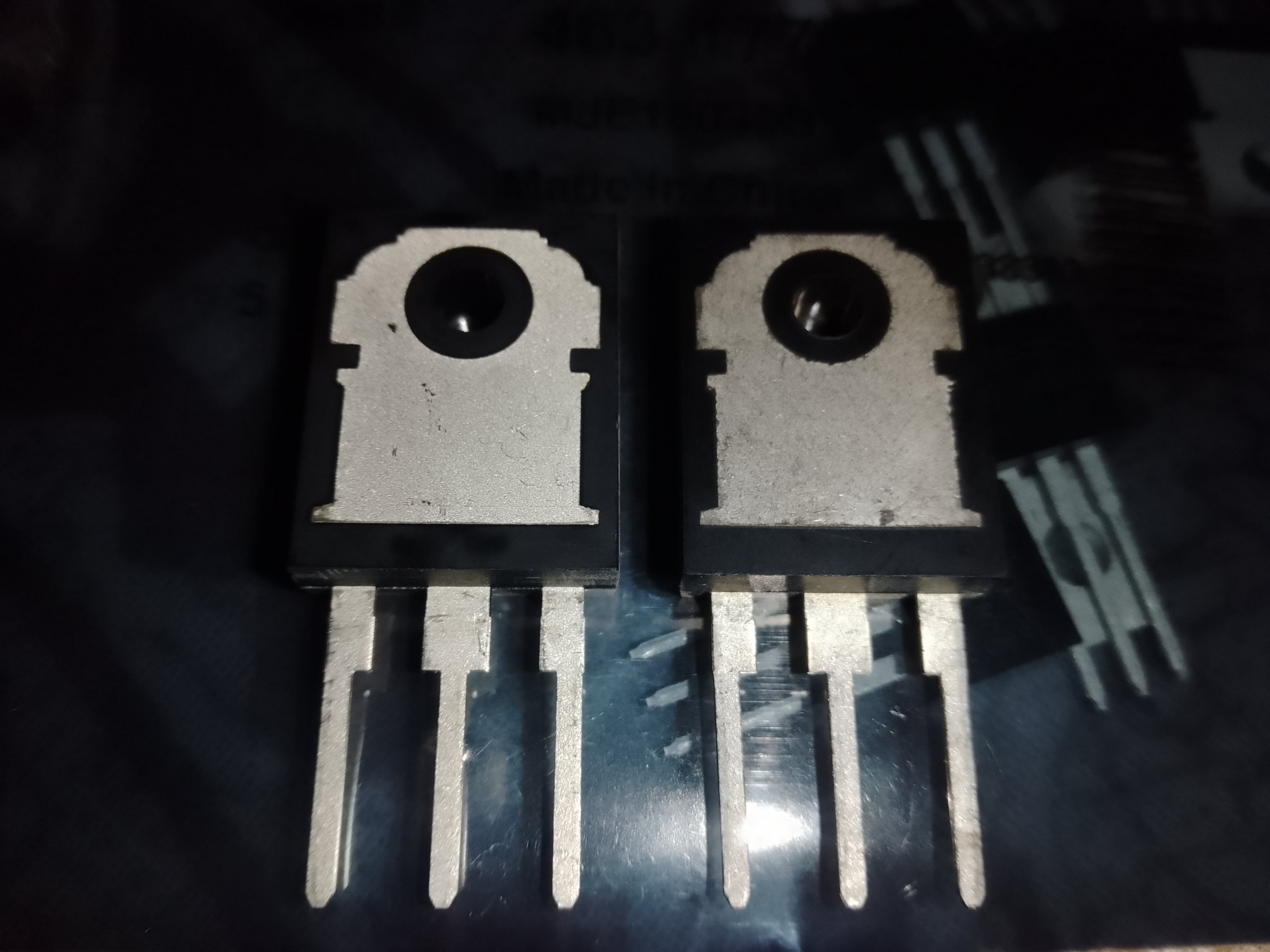

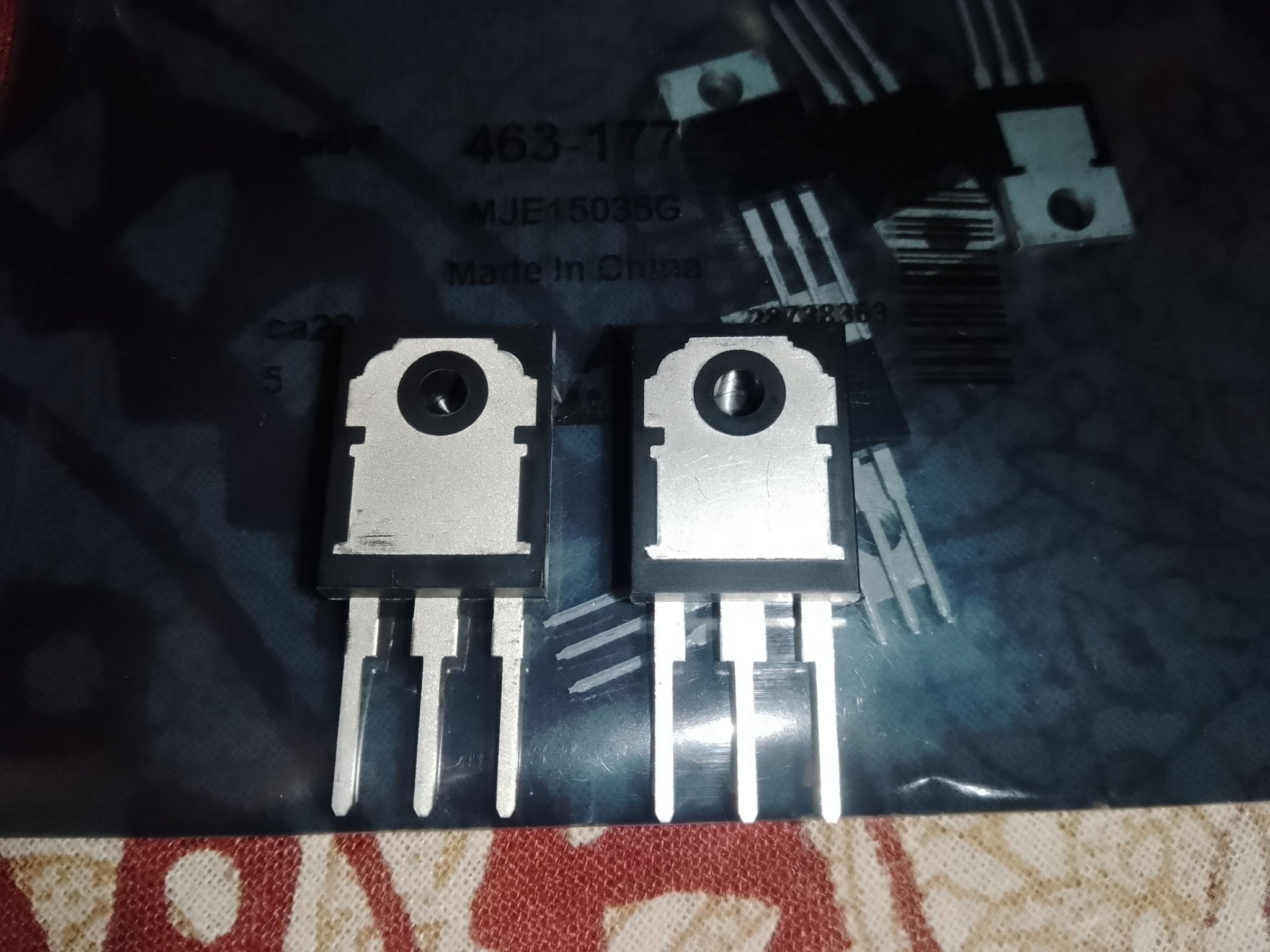

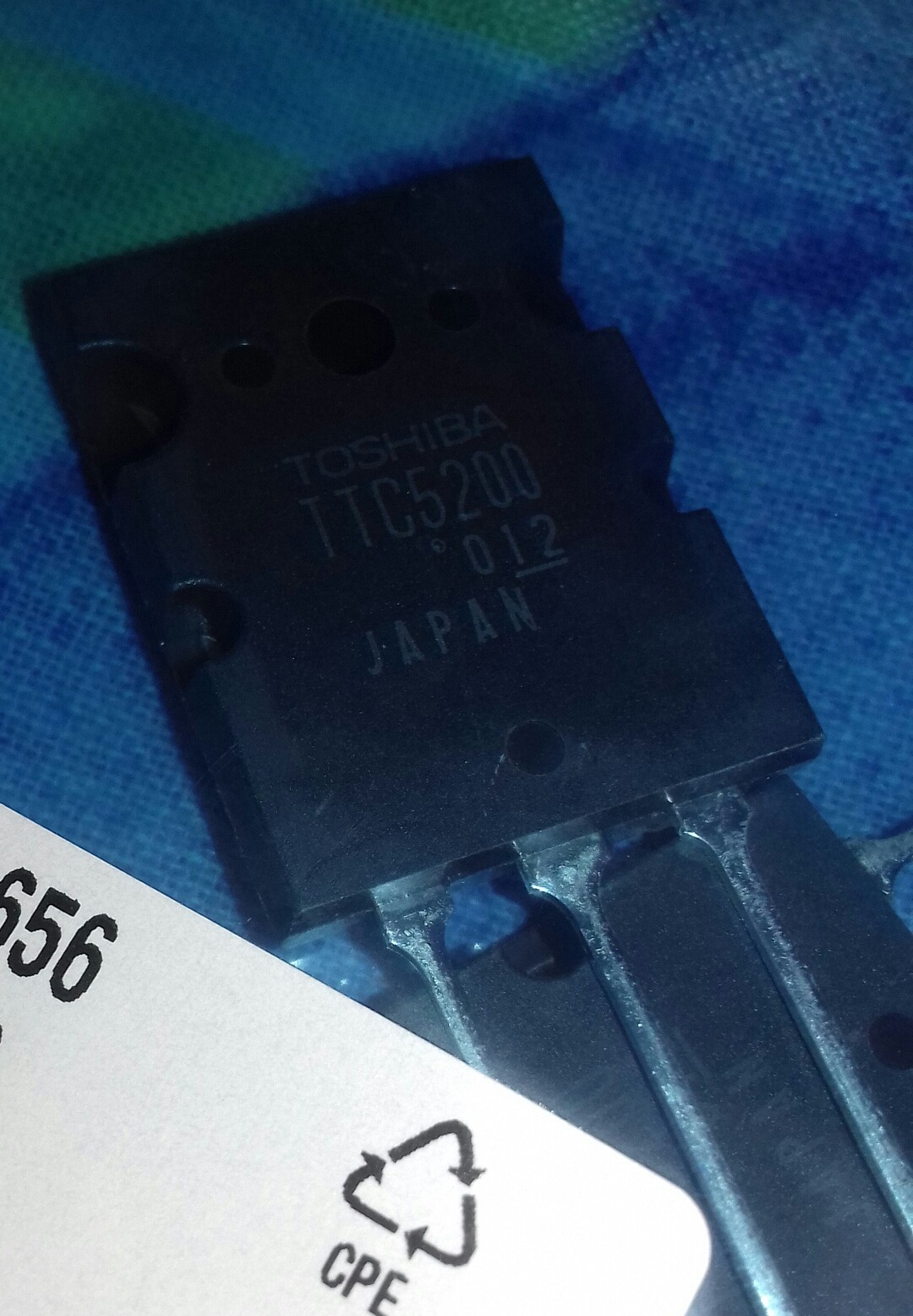

Hello good mornig for everyone! Hello wg_ski, the hFE of these dubious components is 25, things seem to be fine, but the strange thing is that ST did not publish anywhere, (or I did not find it) this encapsulation model, RegardsThat package is all wrong, but the innards dont look like what they put in fakes. It looks like a real OnSemi package. Markings do look like ST. My guess is it’s a re-mark. What’s the hFE on these things like? Real BUV/W48’s are pretty low (20 maybe 30) but linear. If it measures 50, 100 it’s probably really another type being passed off as BUV48. It’s just as common as outright counterfeiting with 2N3055 (or smaller) dies in them - and white goop.
That's why I purchased those from RS not alixpress & these(originals) wasn't available at our local retailers.
https://in.rsdelivers.com/product/toshiba/ttc5200q/toshiba-ttc5200q-npn-transistor-15-a-230-v-3-pin-2/8962656?query=ttc 5200
Maybe it was some limited run. The die size is right, and it doesn’t have white goop. The package LOOKS like OnSemi. So does the laser marking font. Somebody’s playing a shell game somewhere - the $64k question is are you the loser? The only way to know is to test one to spec.Hello good mornig for everyone! Hello wg_ski, the hFE of these dubious components is 25, things seem to be fine, but the strange thing is that ST did not publish anywhere, (or I did not find it) this encapsulation model, Regards
