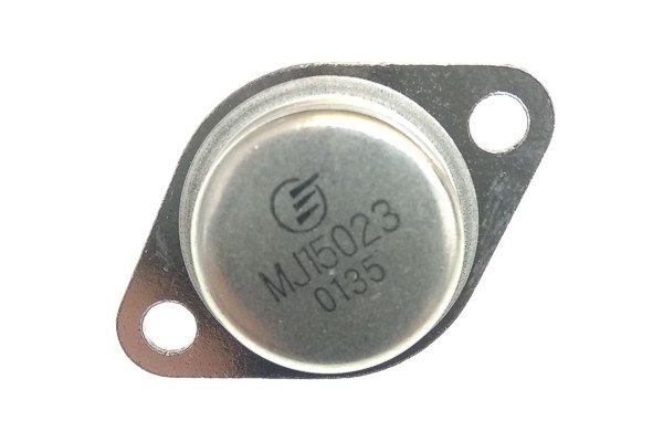

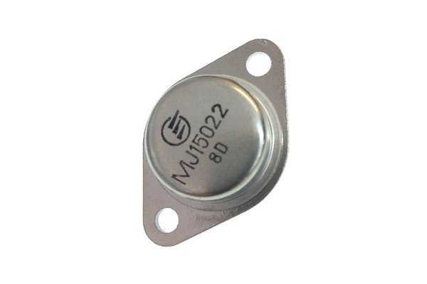

I can get these transistors at a local store very cheaply. They would be ideal for an amplifier that has MJ15003/04 in it. I wouldn't say they are fakes, I just don't know who the manufacturer is? They still have a smaller quantity in stock, which is probably why the price is low.
You can cut open one & see how the die looks like inside. Yes, you can use these instead of MJ15003/4.
The 15024/5 have lower gain linearity than the 15003/4. You are better off with the 21195/6. They are a closer match.
Who knows, I have two pieces, the one with 15024/25 sounds better. The power supply is +-60V, so the 15022/23 also fit. Just to replace the output transistors in this older one. There are original Motorola 15003/04 with Aluminum caps.
