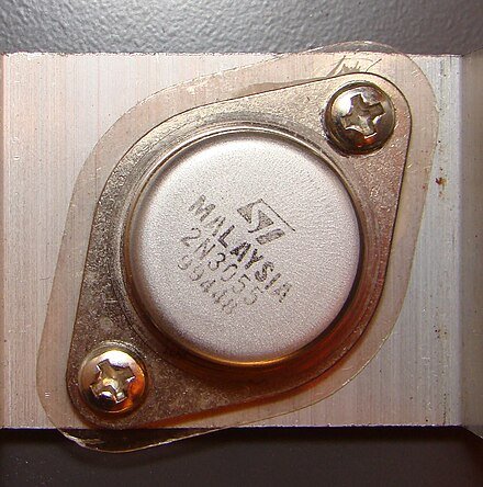

Anyway, this is how Genuine ST 2N3055 looks like (Laser engraved?) & i've never seen a new original one in my entire life (at local store or distributors) after ST discontinued it. CDIL or BEL make is available everywhere though.

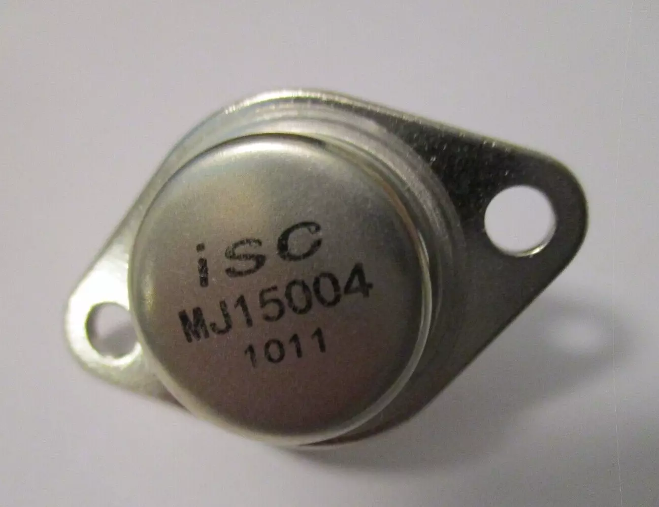

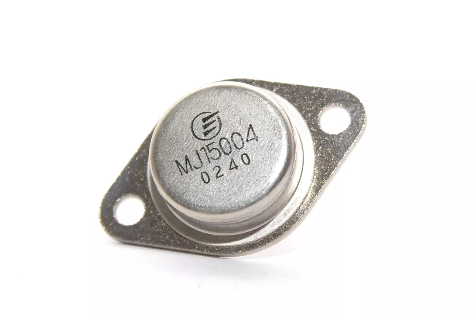

I found on ebay, ISC MJ15004 and this other one where I don't know which manufacturer has this kind of logo. I'm assuming this is considered a copy and not a fake transistor. It has the manufacturer's logo, they don't hide behind ON.

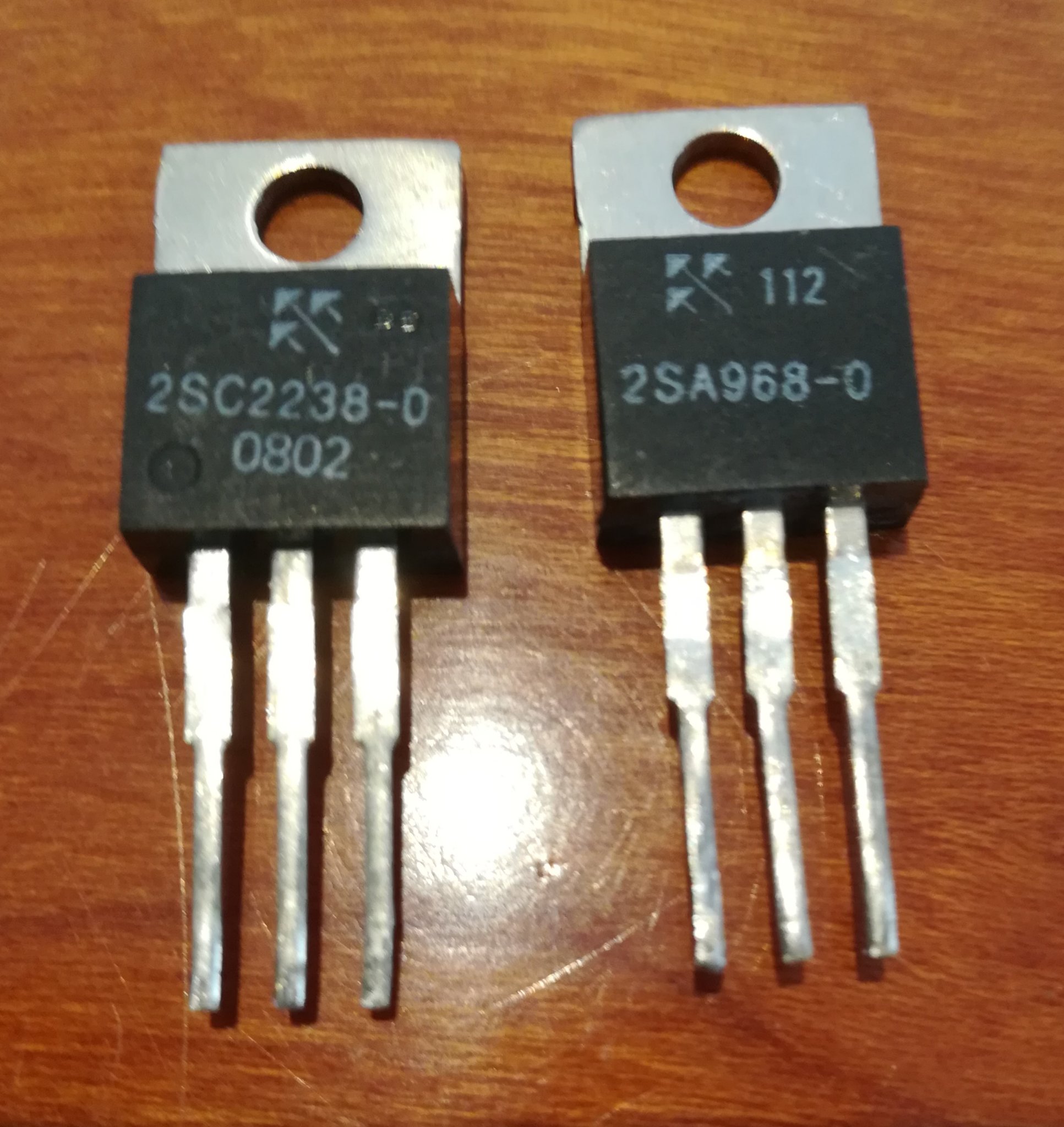

For example, these transistors in the photo are copies of the famous Toshiba stage drivers produced by MAGNATEC.
I purchased them from RS Components and mounted them in my 200W rms mosfet amplifier.
They work perfectly.
The amplifier faithfully reflects all laboratory tests and feels wonderfully good!

Those ISC MJ15004’s are probably as good as Mospec. Good as an old Motorola from the 90’s? Probably. Good (uniformity wise) as the latest batch of ON? I wouldn’t bet on that. The truth of it is, those parts just aren’t that hard to make, to older standards. Even sustained-beta drivers aren’t a stretch to make anymore - NONE of them have spectacular ruggedness, they never did. Properly sized, they don’t need it. Just a flat beta to maybe half an amp, respectable fT, 25 watts power handling to about 30V, and be able to block 200V or so at Vbe=0. Makers are coming out of the woodwork. Just don’t try it with a 2SC2922. Those from ISC simply blow up. To make one that good requires Sankens original processing and assembly technique. If I had to venture a guess I’d say they either put the same die in that as the metal MJ15004, or the one out of their 2SC5200 copy if they have one. The result of that is instant smoke and fire when using a single pair on a +/-70V supply. When Sansui, Pioneer, and others used the Sankens above ratings with their 90’s amps and receivers they at least made it through the warranty period.
When these things are all one can get in their country due to import laws, minimum orders, or even stuff ordered from Mouser not making it through customs, you’ve got to do what you’ve got to do. It also means doing your homework, and some things just aren’t possible. Kids with a $50 or $100 a year budget fall into the same trap. But they should be used to doing homework. At the same time as silicon processing is hitting full maturity and more available than ever, the market is flooded with outright fakes that will fry the instant you turn the thing on, even on a dim bulb.

I asked the local dealer who the manufacturer is, he also says ISC, which is obviously not correct. I asked an ebay seller about that 15004, he has no idea who the manufacturer is. There are just 9+13 pieces 15022/23 in the store. I won't take them, it's no use wasting money and time. About 2.2 euros a piece, but all the same, tooo risky. I thought it was some verified manufacturer, but no one knows that logo. In addition, another seller has CDIL 15022/23 a little more expensive, about 3eur a piece. It's not about money in general, I'll get Mouser ON originals at the first opportunity.

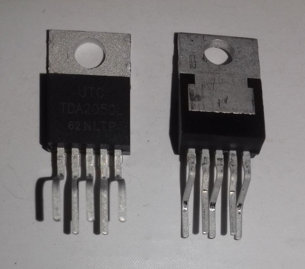

I have used these TDA2050 from UTC two times not long ago and they worked just fine , even close to the prescribed max voltage.Not only works, it met all the specs. It can withstand absolute maximum supply voltage of +/-25vDC with 4ohm load ! Although heatsink becomes super hot!!

I have read somewhere that UTC TDA2050L is somewhat better sounding than original ST part due to more 2nd harmonics. I have seen measurement data. I think internally they're not the same although their datasheet is identical.
