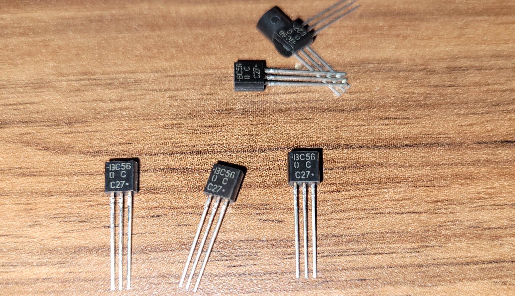

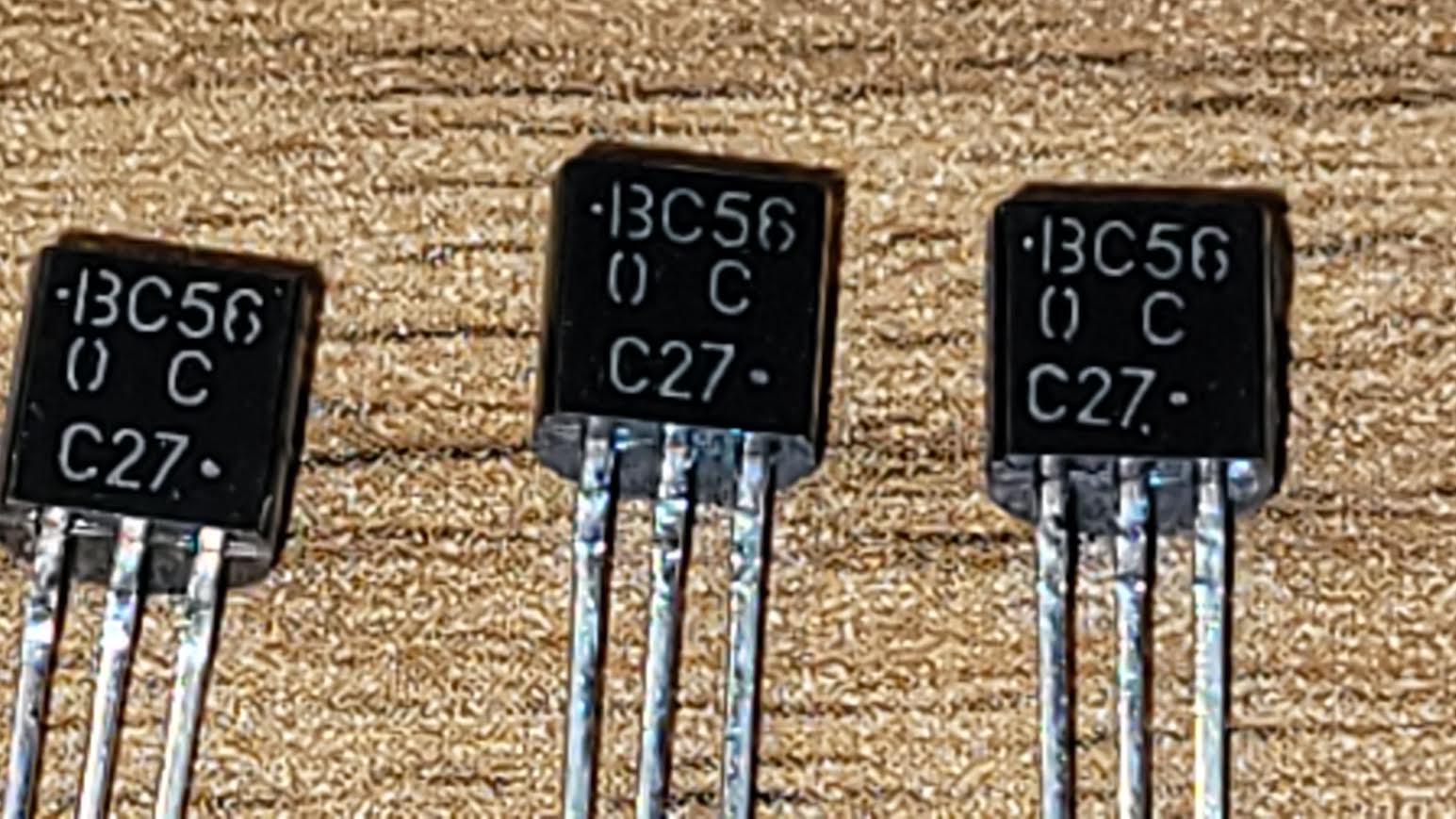

It seems odd seeing the number split between two lines.
BC
560C
Would be valid.
You obviously have doubts... eBay?
BC
560C
Would be valid.
To me they look authentic Onsemi bc560CG transistorsThey should be onsemi.
Can you confirm or deny this?
Thank you.
I'm not sure if those are from Onsemi but by looking at them I think they're of good quality or from major manufacturers.

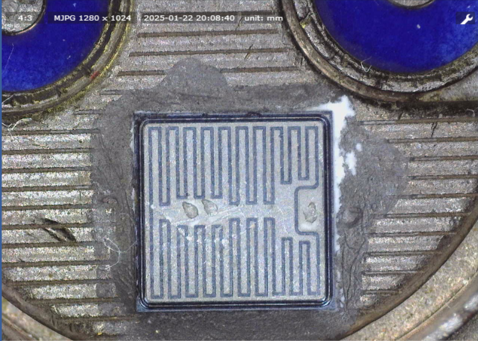

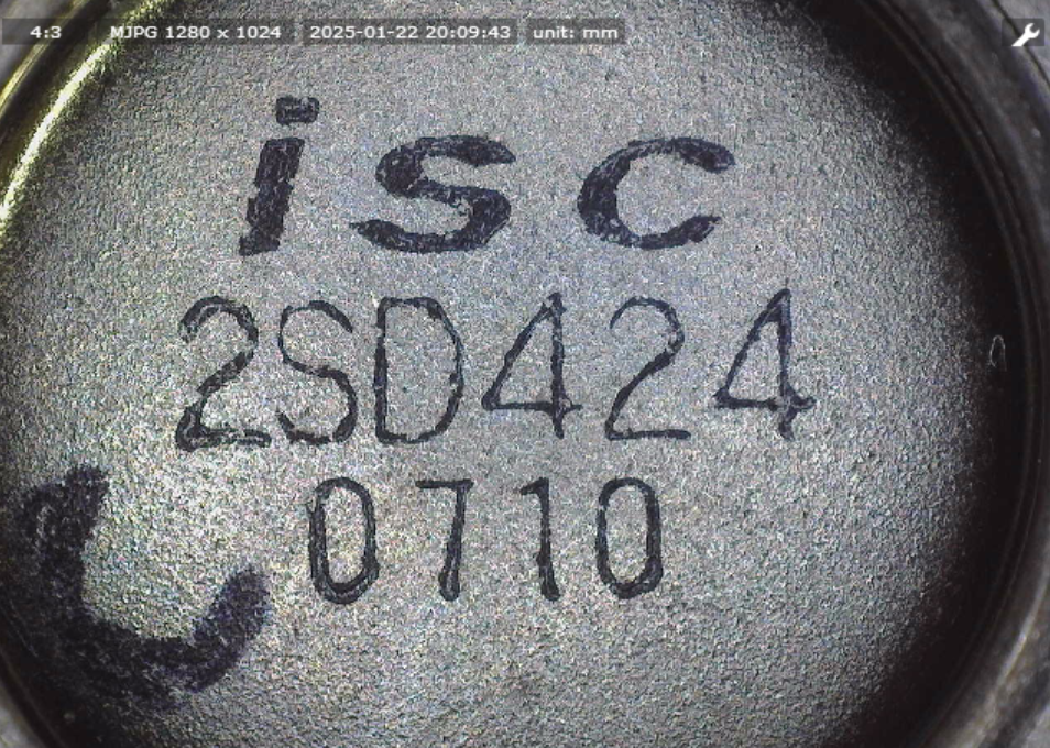

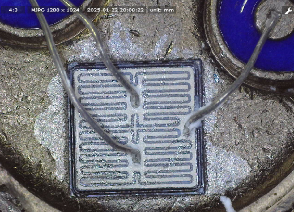

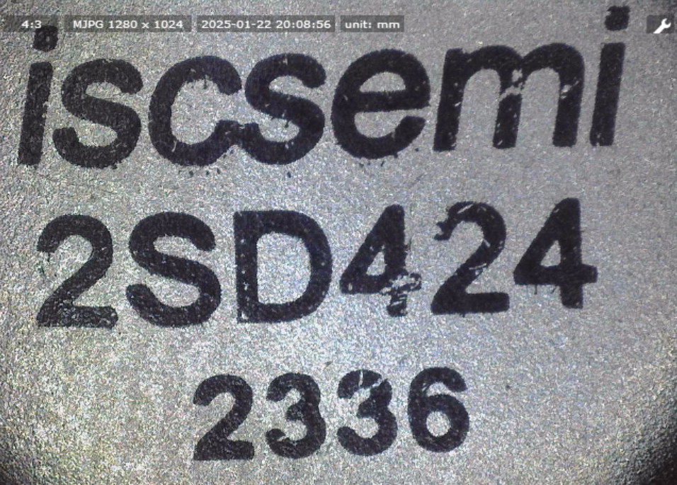

A bit off-topic: some die-shots of very old and new ISC/Inchange 2SD424s attached.
As you can see, the die itself has changed, both versions use heatspreaders (new one definitely worse surface quality), as well as two bonding wires for the emitter. The old die measures appr. 5,2mm, the new one 5,7mm in both dimensions.
Both were purchased from Reichelt.de, although some 12yrs. apart.
Now they sell them for €2,42 wich is a bit expensive, compared to that Reichelt.de currently sells original 2SA1941/2SC5198 for €1,21. And yes, I have no doubt that they are original Thoshiba.
kessler-electronic.de offers some CDIL 2SD424s, I'll get some of these too.
Bottom line - definitely much better than some of the ebay stuff:

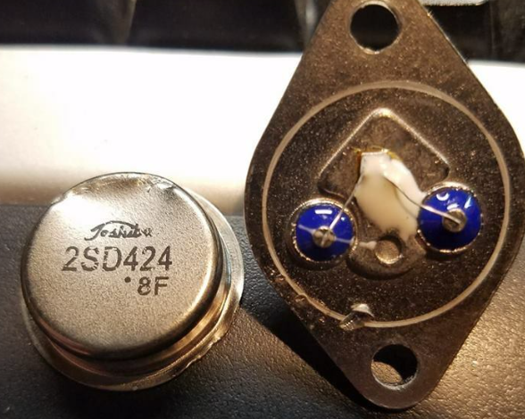

That “Toshiba” D424 is an obvious fake - doesn’t even matter what it looks like inside it the top hat just pops off. Even real innards wouldn’t last.
The ISC dies look plausible. Is it as good? Might be, might not be. Original is only 6 MHz, and an MJ15024 die would pass as a D424. It’s old technology, they might be able to copy it. And the “new” die does look like a better layout with two symmetric emitter regions like the original D424 did. We know their copies of Sanken LAPTs to be lacking, but if they can make something like an MJ15024 it would do the deed. Speed can usually be traded off for ruggedness, and the package looks to be up to snuff as a 150W TO-3.

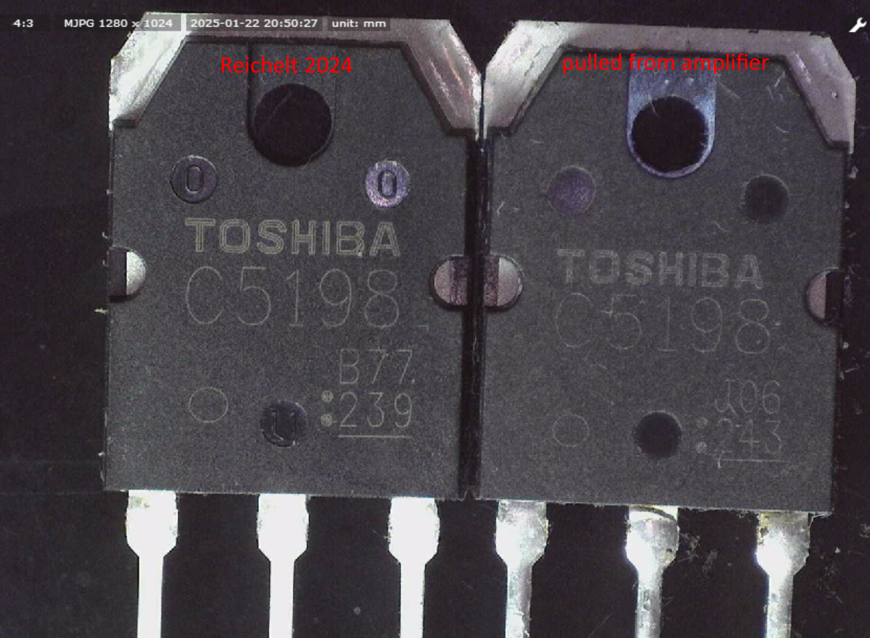

what i do not like at reichelt is that they do not write down the hfe group what they offer!So, just because I've mentioned it, a comparison of the 2SC5198:
I honestly can't remember from what amplifier I've pulled the right ones (maybe Thomann T.Amp T4-700... idk but for sure min. 5yrs ago).
For €1,2 they are a steal.
I'll brake one open.
