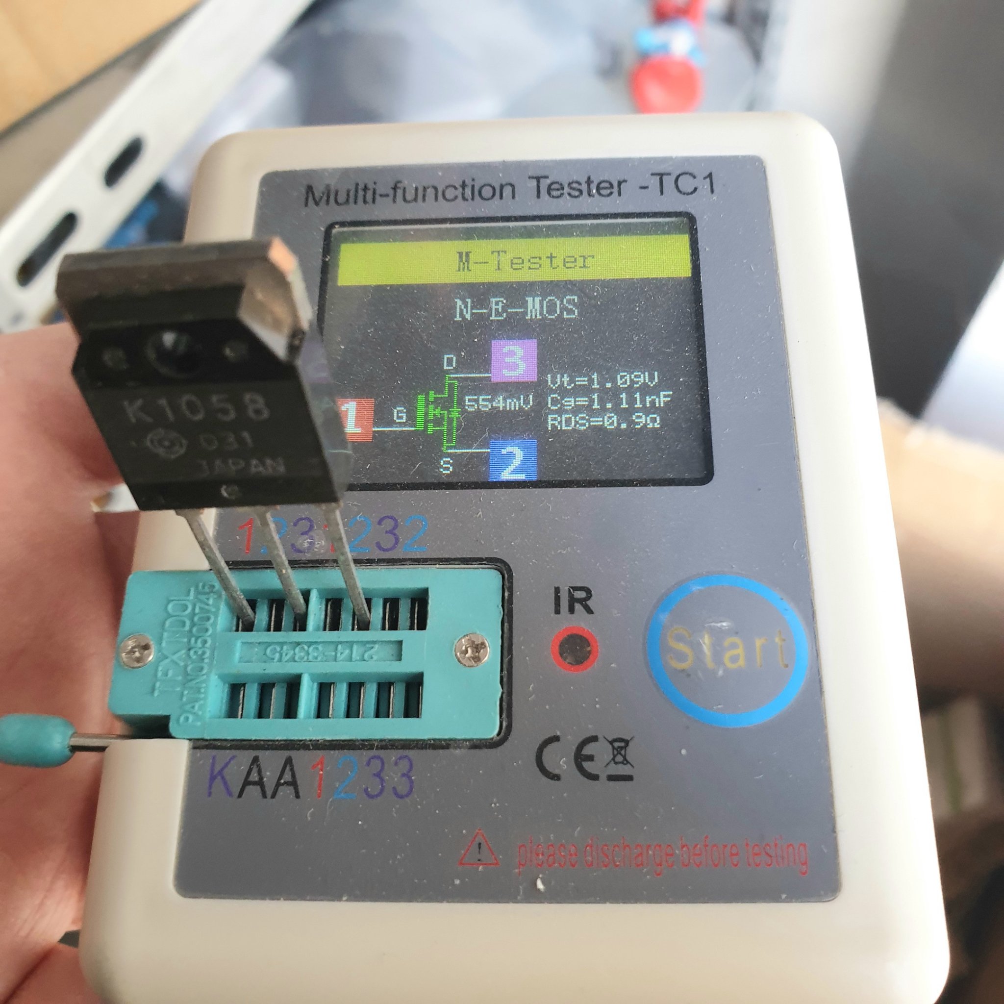

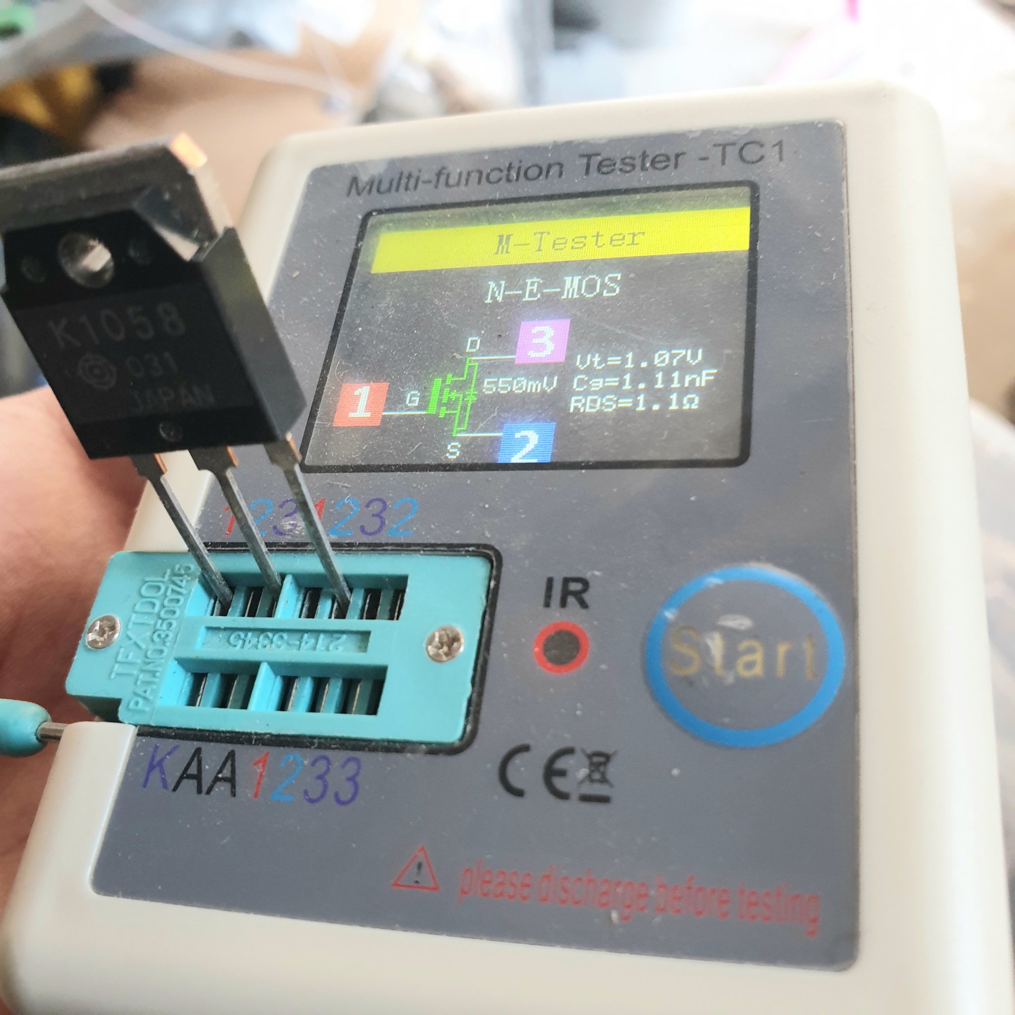

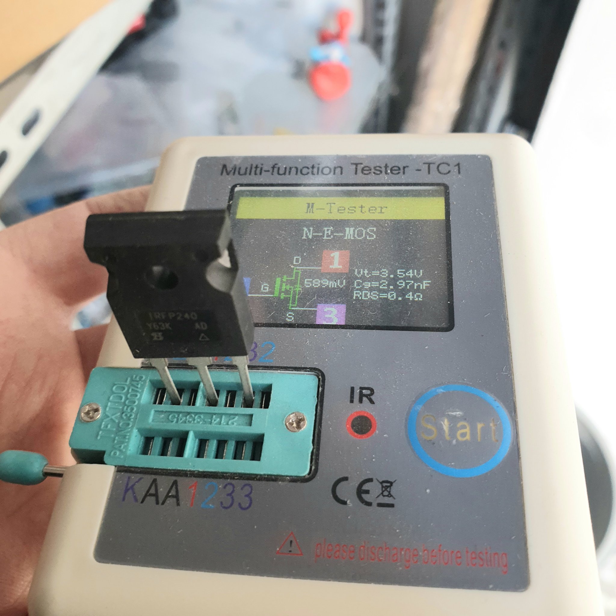

Hi. I bought 100pcs of these fets in the past from a seller, he told they are 100% genuine, I told him they look different than renesas and he told they are old products and he saw many different transistor cases than datasheets .But according to gsd test it seems they are fake /rebranded. What can be these fets? Specs are very different than Irfp240. Here pictures attached. Can I use them for audio apps?
Yes but according to tester pins seem different than original 2sk1058. I tested them idss test in the past but I remember they seems ok. Maybe tester tests wrong?
Many of those testers can't manage lateral fets. You may end up with very strange results.
GSD pinout if I remember correct, not DGS as you are used to with IRFP and the others.
Hook them up to a 10v bench supply, adjust Vgs with a 10k pot starting at zero ohm between GS.
Measure Vgs and drain current for 50, 100 and 150 mA.
Check measurements against datasheet and write up Vgs for every piece, then you have done a matching.
