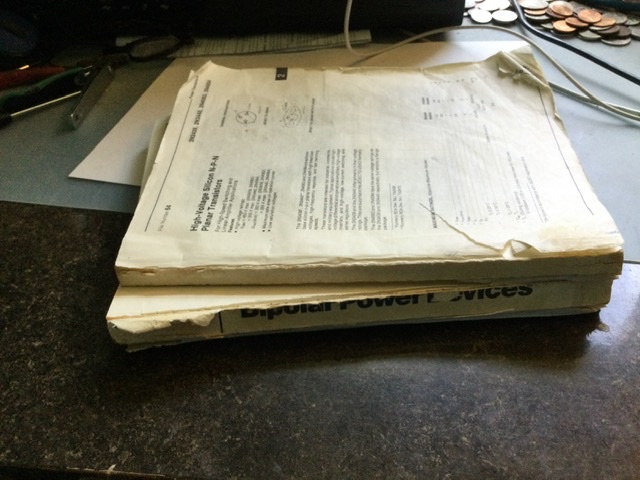

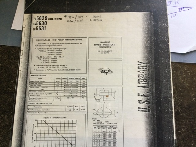

You can see where this old data sheet came from. I must have photocopied about half of it, and paid as much in fines for having it out so long. And what shape my RCA book from the same time frame is.
Now that is familiar ... and well worn!
I had replaced data books earlier in life due to that exact problem. I could get copies in better condition than mine at hamfests. I didn't help my books that other techs I employed used them too. I HATED it when they wrote in any data book or in a service manual. We had a photocopier, they were supposed to copy the page and write on that and insert the page in the book if it was important or a correction.
