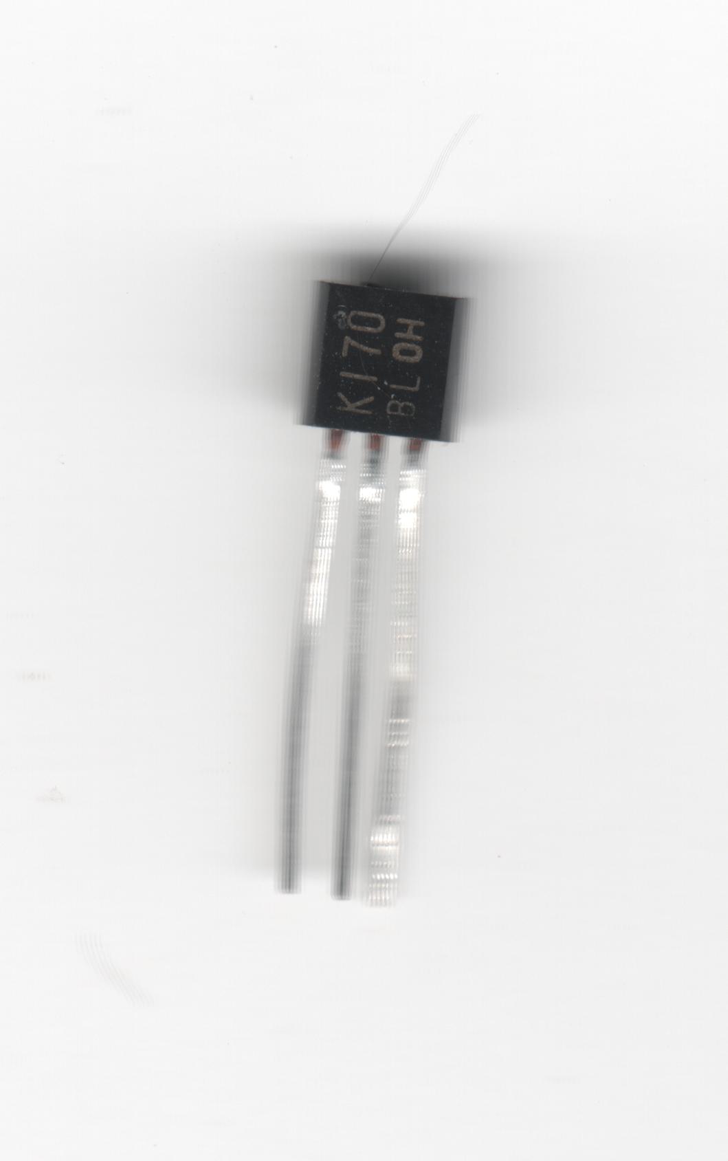

Zin,
the legs may be a packaging option.
The printing on the face is completely different from my 2sk170 batches.
AndrewT can you please post a high quality Macro photo of your genuine devices. I will do the same with the ones that I think are genuine.
The pirates and thieves are out there to get us poor mortals.

Back to my 2SK170BL fakes. I bought them for the going rate from Dalbani.com, a reputed distributor.
No-one is safe.
No-one is safe.
Im intigued as to what my Fake 2SK170BL actually are.
At a pure guess they are 2SK170GR - what is the best way to measure these devices for passive parameters ?
I've got a MM that can measure capacitance. I don't want to go to too much bother in testing them, but if they are 2SK170s I might still be able to use them.
