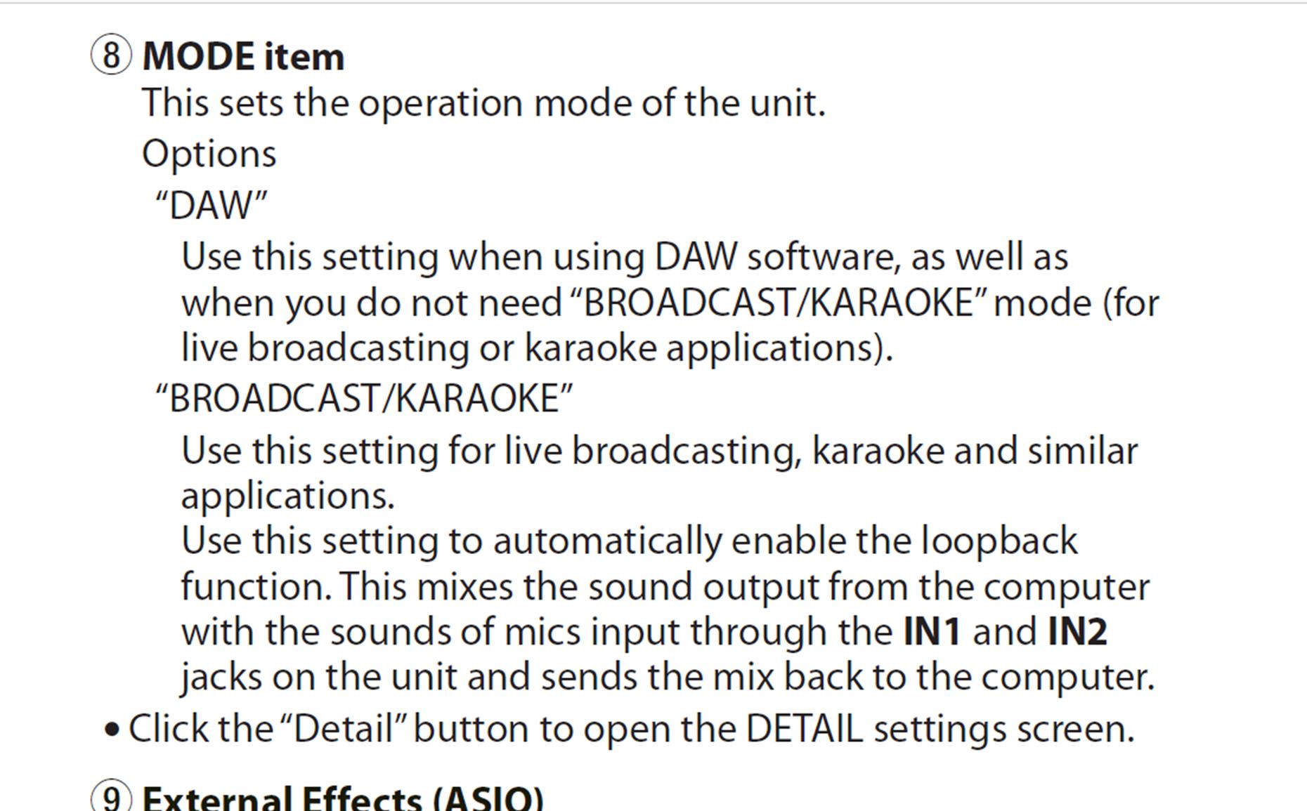

Yeah, I really had my blinders on; I must have really wanted those graphs to be real. Its perfectly clear in hindsight.
So the deduction was correct. As soon as I unchecked karaoke, the pretty picture disappeared.

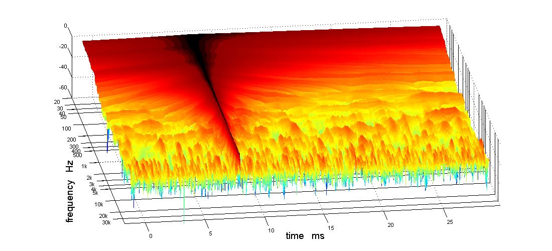

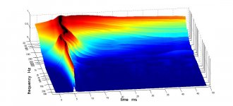

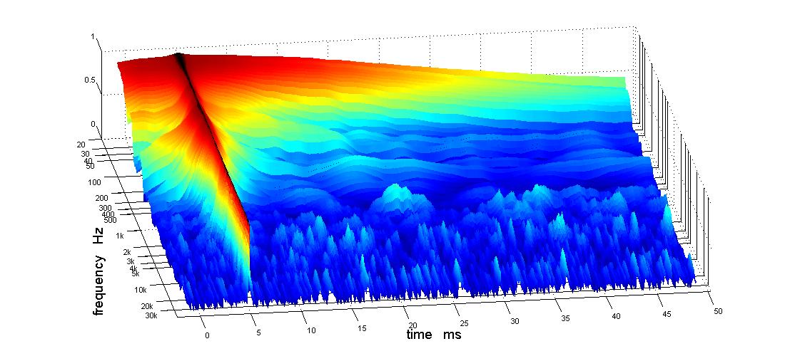

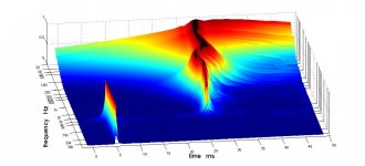

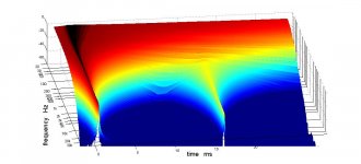

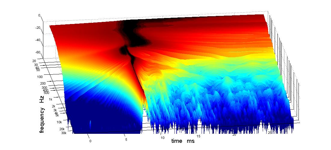

the promised figures
The key was configuring the sound card to stereo input and from Karaoke mode to DAW mode. In mono, it summed left and right to produce a single input stream and in karaoke it will mix input and output.

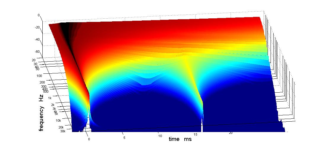

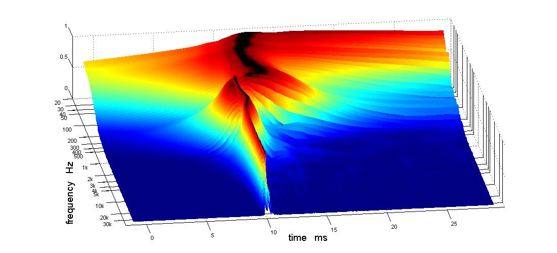

Here is a measurement with both mic and loopback unplugged and APL processing the mic input:
APL is in extended dynamic range mode and the display is offset in time to show both before and after. I think we are looking at crosstalk of the line output into the input stream and that its at a pretty low level.
I get essentially the same picture with just the mic unplugged, although this time I didn't offset the graph in time and I should caution that levels are relative.

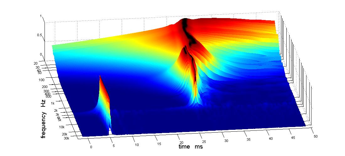

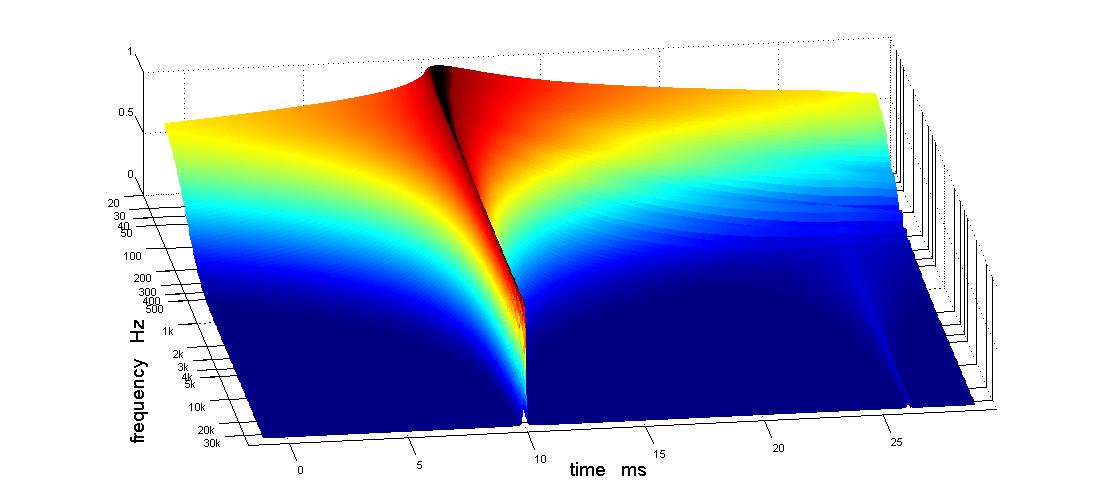

Here APL is configured to use the loopback instead of the mic input:
I don't know what that is out at 16 ms. Here is another view of the timing reference, shifted in time, and with now just a shadow 16 ms downstream from the primary signal:

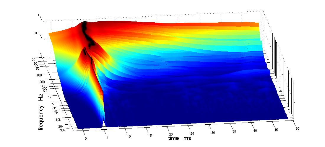

Switching APL back to the mic, I get this measurement of the speakers:
APL measures the reference delay at 7.448 ms in this particular mic position. Earlier with the mic in a nearby position I saw a REW IR peaking at 7.15 ms. I should have retaken that REW measurement but it didn't occur to me until too late. At any rate, I've shifted the display far enough to the right that if there were any reference leak through, it would be apparent.
Here is an extended dynamic range APL display. With this time offset, the reference channel leakage, if any, should be at t=0.
So where are we?

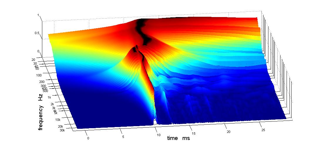

I think I've got the timing reference out of the APL measurement. There is still a trace but its very low level and off scale to the left. I wouldn't even be aware of that trace or the shadow out 16 ms unless I had gone looking for it.
I still have to show correlation with REW. I'm going down to the garage to do some of that right now.

TDA 3D ext dyn rng both mic and loopback unplugged APL set to MIC input left.jpg79.7 KB · Views: 483
TDA 3D ext dyn range mic unplugged apl configured to loopback input.jpg53.3 KB · Views: 477
APL 3D of timing reference in right channel wo using timing reference.jpg48.3 KB · Views: 479
APL 3D left channel using timing reference Tzero eq m10.jpg54.7 KB · Views: 476
TDA 3D extended dynamic range with just a hint of loopback in lower left.jpg68.7 KB · Views: 478
Wow, famous last words. I go back down to the "lab" try to run REW measurements and the speakers get severely abused by clicks and clacks, lound noises, and the howl of feedback. MIC gain and Line Out levels are apparently incompatible between REW and APL. At high MIC gain, there is apparently some feedback. It might have been due to the mixer application which might still have been alive from my prior APL runs.
They both use the same sound card but different drivers. I have to be careful to kill the Teac Tasman mixer software app and drivers I use for APL before starting REW and to start them again before starting APL. But the speakers survived.
I ran a REW measurement using timing reference and found the IR peak at 7.547 ms. I then carefully started APL ran a measurement using timing reference with it and it came back with a reference delay of 7.583 ms. That is a pretty good start at correlation. I took those measurements with the car in the garage right in front of the speaker so there isn't much point in processing that data much further. Its surprisingly good though considering.

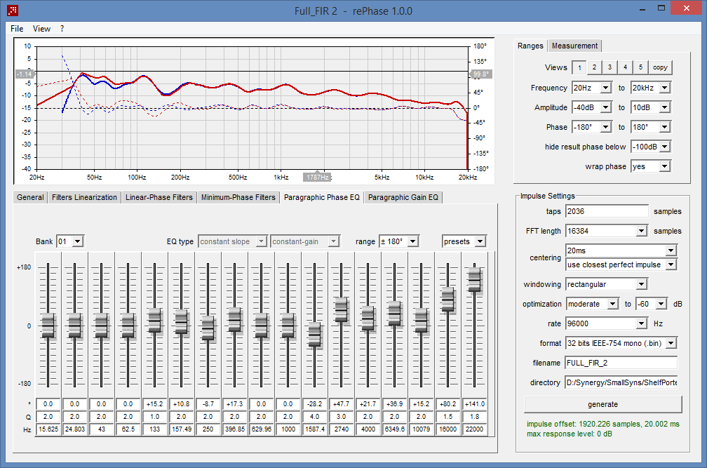

Rephase is EASY. Take your measurement and save it as an .FRD file (with a phase response column included). Import it into Rephase. In Rephase, set the sample rate and FIR size (depends on what your hardware supports). Click on the "Phase EQ" tab (or named something like that) and adjust the sliders, starting at the highest frequencies to set the curve to 0degrees at that point. You can set the "Q" of the sliders, but I've found the default works pretty well. Go down the line and pull the phase toward 0 (remembering that the phase is "wrapped", so look at the curve to know which way it has to go.
You'll run out of sliders, but on the left of their location on the form, just open up another bank of sliders and keep pushing the phase curve toward zero. You might not be able to get there at lowest frequencies because of limited taps or data that is room rather than speaker (phase EQ ONLY the speaker, not room effects).
You can also tweak the amplitude response with FIR, but I'd do that with IIR PEQ using the miniDSP's app (not RePhase) to reserve the FIR for phase use. Adjust magnitude to where you want it in real time while measuring and watching the curve. Get the magnitude where you want it first, then do the phase.
Last, generate the coefficients as a .bin file. Import that into the FIR part of the miniDSP to both output channels Measure response again and make sure it is doing what you wanted -- done. Rephase won't likely give you a perfect fit to the phase you dialed in (it will show what it can come up to on a new red trace in its display) but it will be tremendously closer than you'll get via analog or IIR. After you've done it once it probably won't take you 20 minutes to do again from scratch.
There are probably lots of variations on the process, and different views on how to get the measurement (a sliding window is a good idea), but the above will get you going quick.

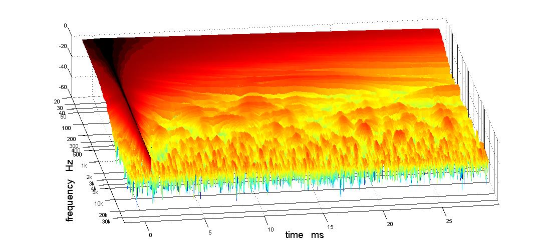

Judging the APL-Graph:
I'd first optimise the timing of the drivers and the crossovers in general, to me it seems your mids fire a bit too soon and doesn't "flow" with the CD. You can get a smoother phase hand off i.m.h.o. (*)

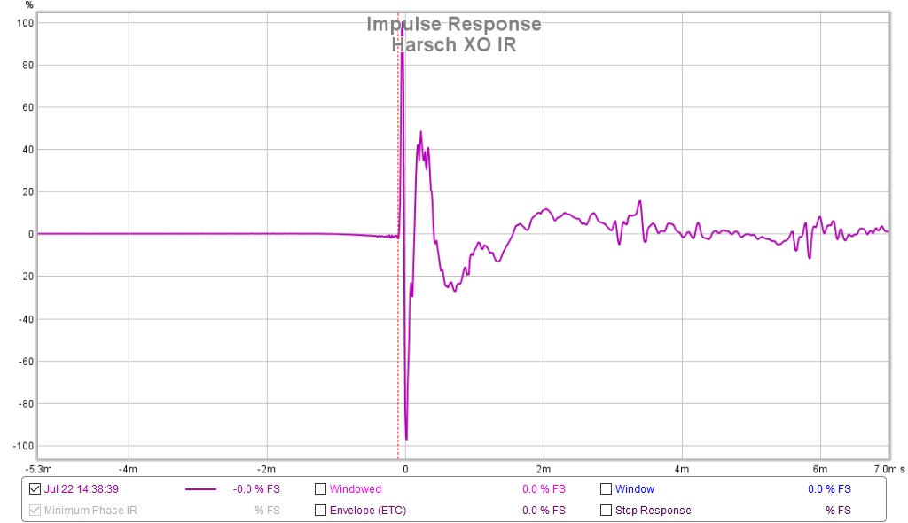

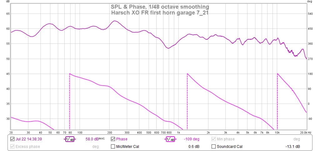

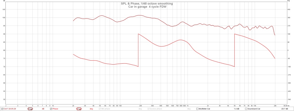

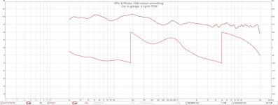

I was going to say playing with sliders is easy but the hard part is knowing what to correct and what smoothing to put on the measurement that you correct - but you said it for me and gave me some guidance.
I've been using REW's 4 cycle FDW measurements for all my XO work so far.
I did try the Harsch in the XO for my first horn. Reviewing the IR and FR, I think I should do another implementation. The IR is cleaner than what I have now - without that low level ringing after the initial tall peaks.
With the right delay on the tweeter/mid you can get pretty close to transient behaviour. The rest could be ironed out with FIR.
