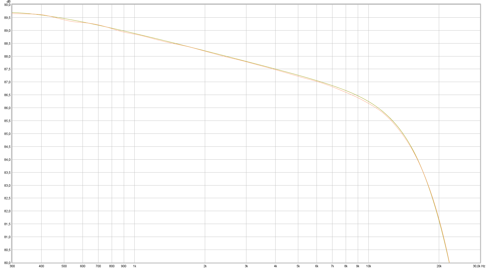

Another thing is think got some fantastic precise EQ correction up running using TDA_EQ v004, as seen below even live measured acoustic curve starts look as smooth as its synthetic textbook curve with REW gate set as 1/6 FDW. One of the keys to get there was feeding various correction curves to TDA_EQ process although admit create those curves take quite some work, another is above 24kHz what TDA_EQ suggest is corrected by hand. Share the info here because thanks your sharing here was the one push me get a licencse and think precision is superior compared most manual correction.

I have to admit I got distracted from TDA_EQ when I tried RePhase generated FIR with my OpenDRC from MiniDSP. That did a good job but I ended up with enough latency to give me a lip sync problem. I also corrected phase down to too low a frequency so I've been meaning to repeat that process. Now that I've got more bass damping in the room I should give TDA_EQ another try measuring at the LP.
But how do you use REW measurements with TDA_EQ? I've only used it with its own built in moving mic measurement process.
Correction is up front forming planned slopes, for my part listening position correction will have to wait later down the road, REW measurement is on its own what shown there is quality check that even acoustic slope end up being close to as smooth as a perfect synthetic target curve, inside TDA_EQ process use the build in method and set it to lowest setting that is 2 pulse sweeps and for HF part set Q at 8 is okay, but feeding it wishes of slopes and excess responses from chain that only will be there when measure-ring process takes place really help it can output some high precision results compared what my manual handmade corrections can think of, its correction is pure minimum phase so any wishes for linearize XO points have to be somewhere else. Think my point for sharing is the smooth high quality of precision on par the good quality wesayso do manual with his own hands, how to get it implemented per multiple band pass is harder but think not bad to dream of.
I don't think anyone can argue with the smoothness of your curve. In case anybody didn't notice (like me at first) you plotted 0.5 db steps!
Its nice to have the software do the EQ automatically so you can focus on the higher level tasks.
