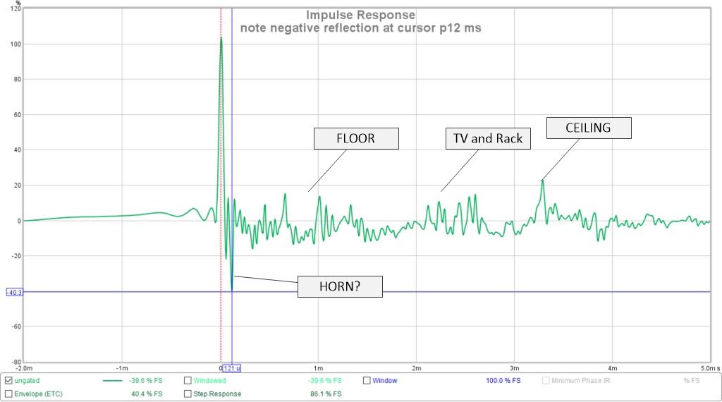

Identifying reflections
Between TDA, IR, gated sweeps, and geometry, I think I have the reflections pinned down.
The IR shows the close in stuff best:
attachment.php

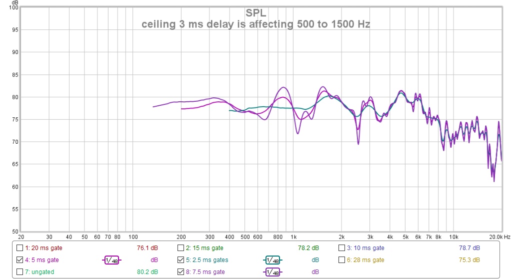

The measurements I'll show next are all without any FDW but with various gates. I'm comparing responses with different gates to see when reflections arrive.

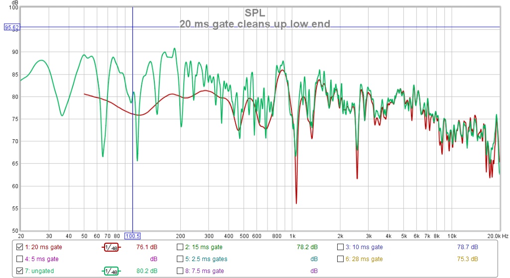

The nastiness around 1 Khz seems to be due to the ceiling, which comes in at about 3 ms delay. With a 2.5 ms gate, circa 1 Khz is nice and smooth.
attachment.php

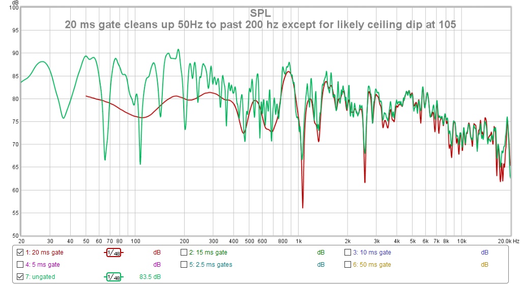

Similarly, a 20 ms gate cleans up the low end, except for that broad dip centered at 105 Hz. Edit I no longer think the dip there is due to the ceiling. SBIR says predicts a ceiling null at 140 hz which we see in the ungated
attachment.php
The easiest thing for me to do is add more bass damping by building corner bass traps that match the footprints of my horns and extend almost to the ceiling, filling them with pink fluffy fiberglass. This should give me twice the absorption of those 4" panels I've got across the corners now and frees up those panels for use elsewhere. More floor absorption and ceiling panels aren't in the immediate future.

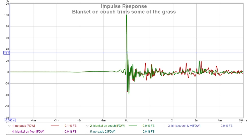

One of the things that discouraged me from treating the room was doing some measurements with a think blanket over my listening couch. It turns out that while the couch may be good for damping the bass it is anything but that for higher frequencies.
This picture overlays IRs taken at the center couch LP with/without the blanket on the couch.
attachment.php
About half of those early reflections are off the couch. We just bought it a couple of years ago. One thing in my favor though is my wife hates it.

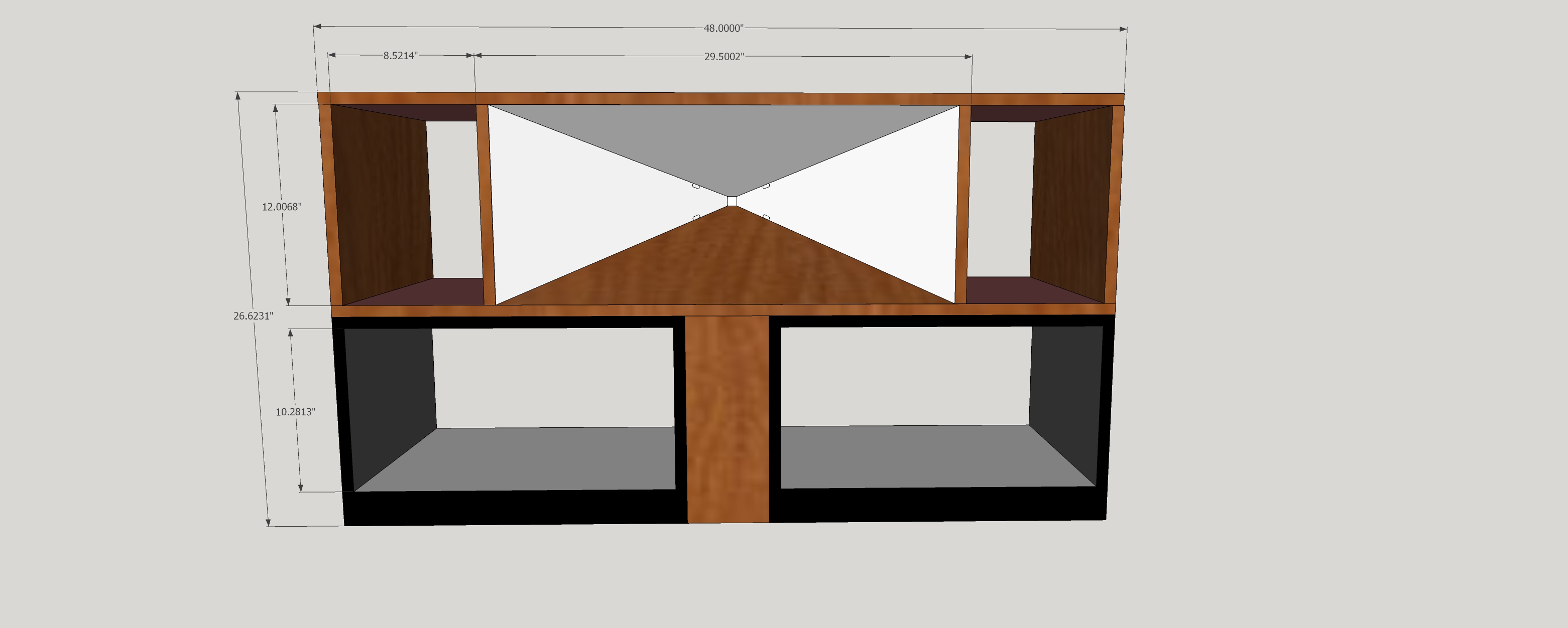

I'll just post a concept dwg now. Its the same horn but repackaged 48" wide so that a fairly large TV can sit on top of it. The design includes 8RU or rack space as well as some half rack space. The mids are 8FE200's vented to a 60 Hz tune but high passed at 80 Hz.
attachment.php

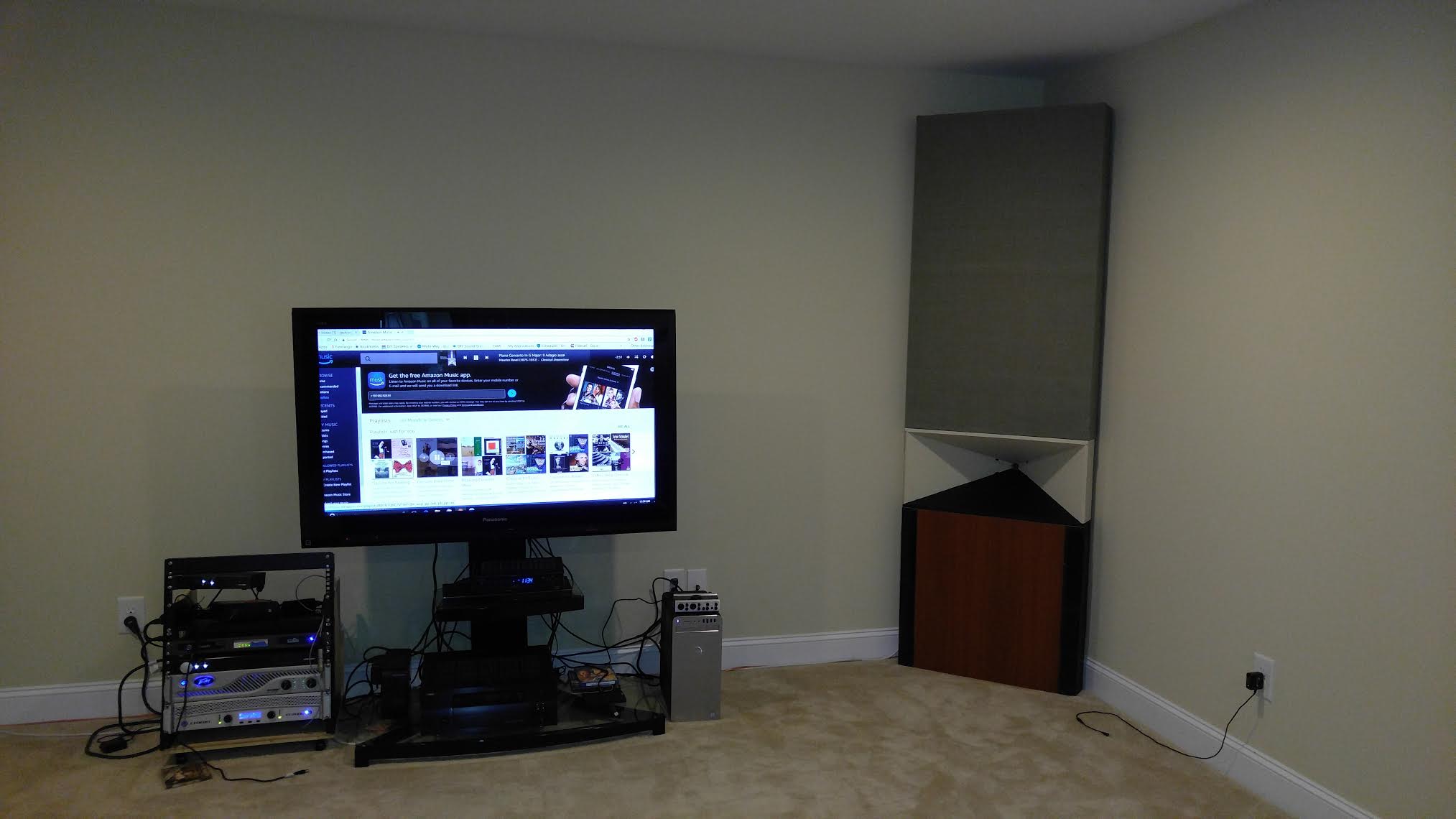

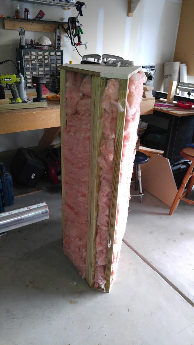

I had a burst of energy and built a bass trip to sit on top of the horn, maximizing absorber volume. This should have almost 2x the absorption of the 4" of 703 panels I have across the horn corners now. Unfortunately, I only had enough material on hand for one of them.
attachment.php
attachment.php
I'll post before and after measurements shortly

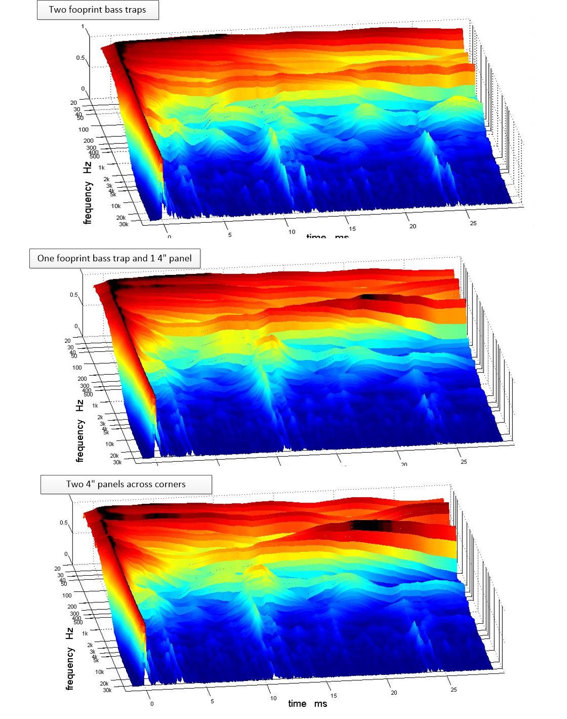

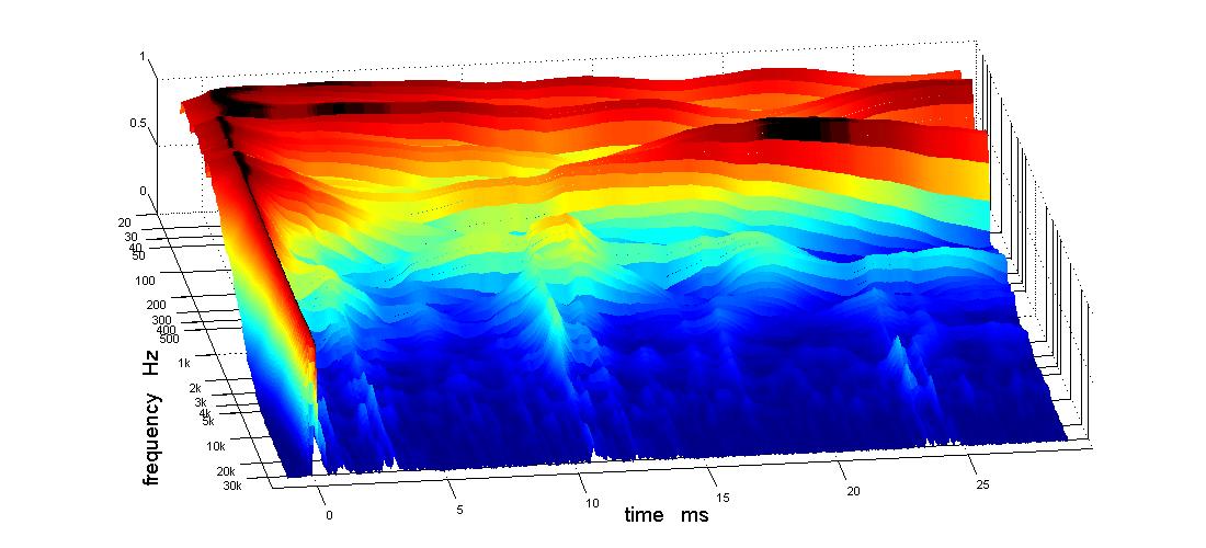

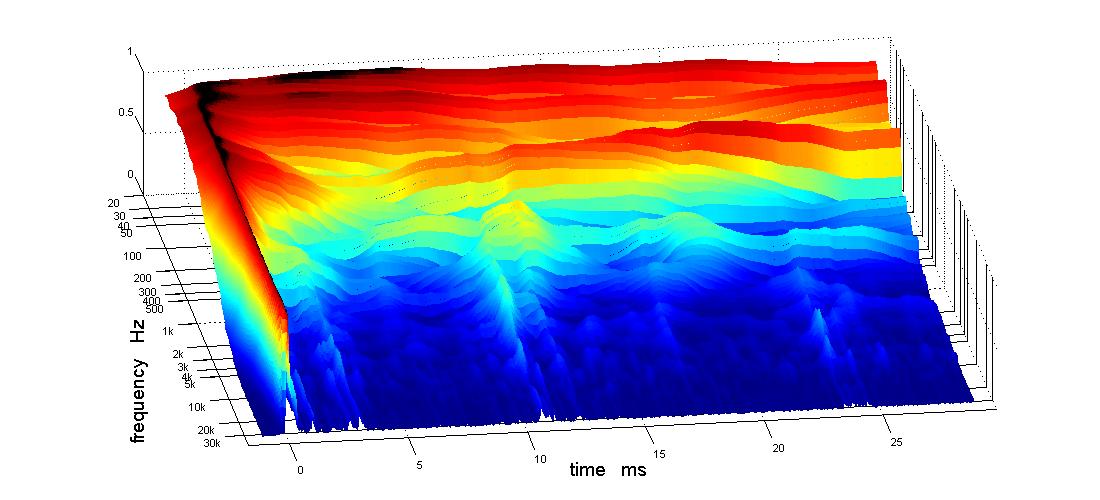

Here is tda 3d "before"
attachment.php
and after, with the freed up 4" panel now in a back corner
attachment.php
the level of the circa 200 Hz resonance is knocked down noticeably

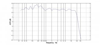

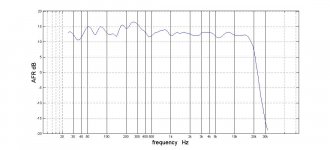

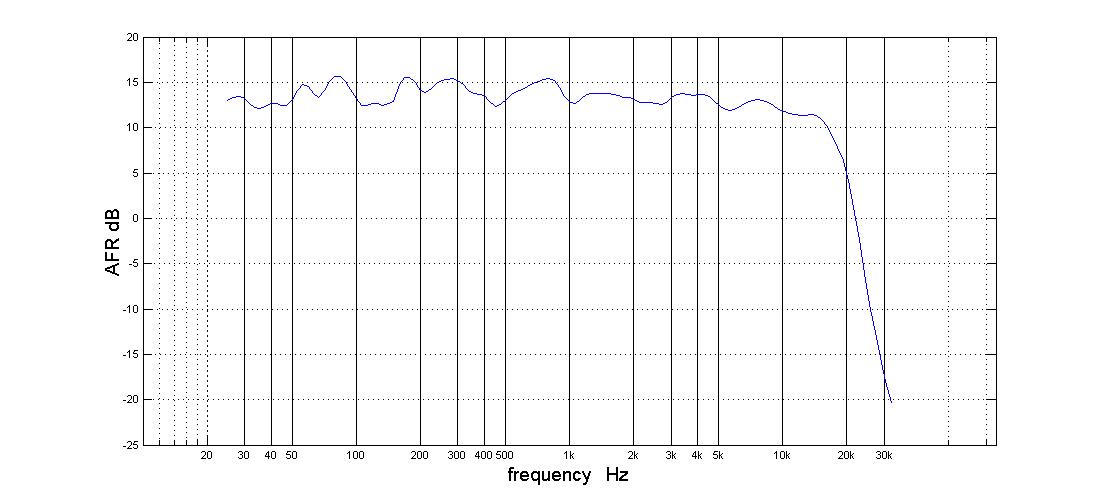

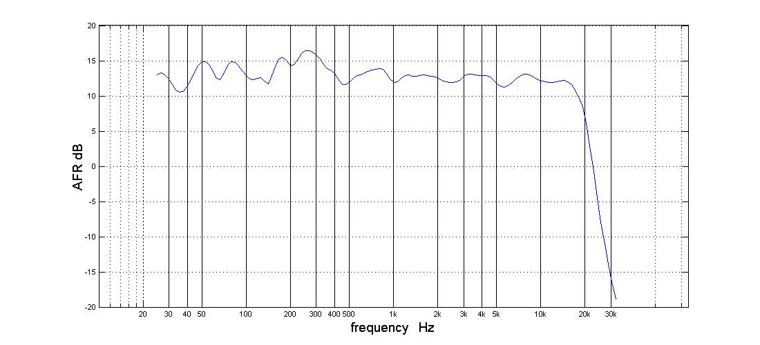

Here is the AFR before
attachment.php

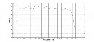

and the AFR after
attachment.php
In the AFR's I see changes in the 150-300 Hz region.

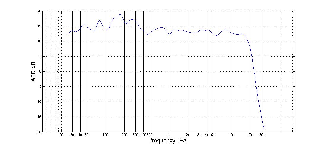

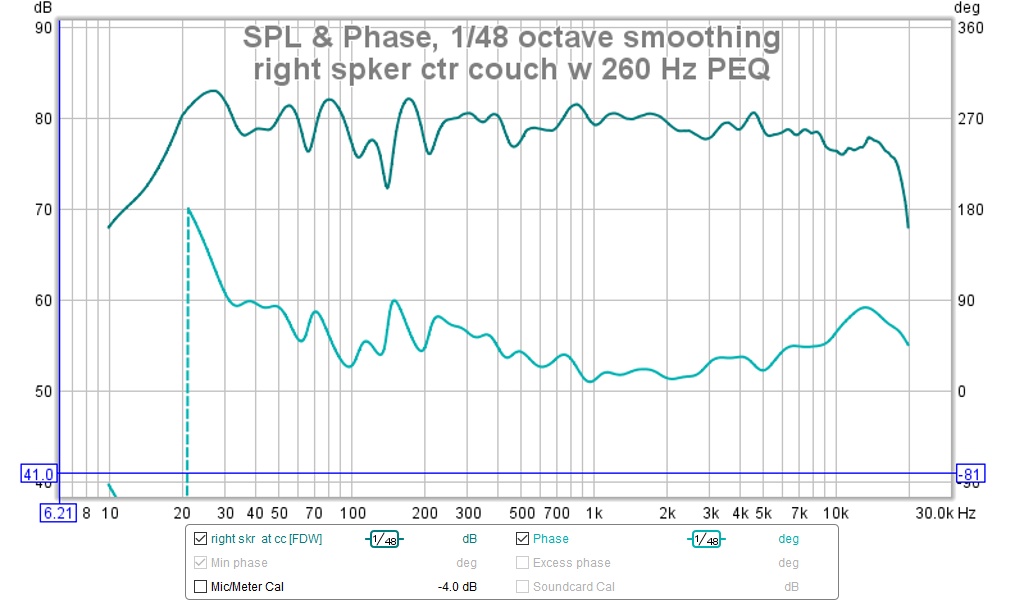

With the room attenuated that little bit I felt emboldened to try a little "room eq" - to knock down that peak around 260 Hz. It took just a minute or two using the TDA AFR as a guide to add a 260 Hz, -4db PEQ with Q=4 to the OpenDRC. This is the AFR with that PEQ in place
attachment.php
That is the magnitude response of the direct wave as perceived by TDA. It includes the near reflections that we hear so is a good guide for EQ. Its not the same as what REW sees, 5 cycle FDW:
attachment.php
This seemed worth listening to and that is what I did for much of the rest of the day - it was delightful; more so than before - but perhaps that is just me liking my speakers.

I completed a 2nd horn footprint shaped bass trap. Here you can see the incremental improvement from the initial pair of 4" 703 panels across the corner to the larger bass traps.
attachment.php
Some, not dramatic but that 200-300 Hz region is flattened and I think I can hear that.

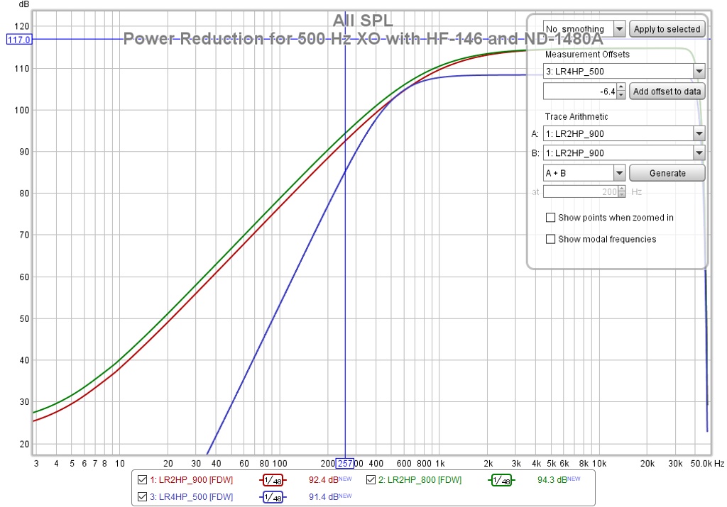

No real progress on my center channel speaker other than several partially completed competing designs.
I've decided that my center channel speaker will use a 1.4" CD and be a 2-way reaching down to 40 Hz or so. I have the two questions re' the CD: which one and how low dare I cross it over. The Faital Pro HF-14x series of CDs have gotten good reviews and I've heard of them being used in home environments crossed over at 500 Hz. The ND-1480A from 18Sound looks good on paper. I would prefer an answer from the data sheet as regards the minimum XO.
attachment.php
Above, I've plotted a 12 db/octave roll off curve for the HF-146 from its 900 Hz minimum recommended crossover and also from 800 Hz for the 18Sound ND1480A. On the same graph there is a 500 Hz high pass curve with a 24 db slope. Clearly, no more power is input to the HF-146 at any frequency with a 500 Hz XO if the max power is reduced by 6.4 db from the specified maximum. The 500 Hz XO demands less excursion from the CD below XO because of its steeper slope.
The required power reduction for the ND-1480A is 5.4 db. With these reductions the HF-146 can reach 121.6 db at its maximum AES power rating and the ND-1480A can reach 124.6 db on whatever horns they were measured on for the data sheet. Unfortunately, the ND-1480A lists at around $500 and I don't know where to buy it in the US. The HF-146 is readily available at ~$250.
This little analysis identifies a safe power limit for a 500 Hz XO. By remaining well below that power limit, I hope and expect they will also sound good.
