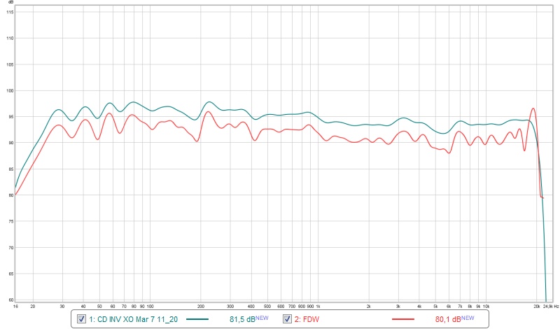

Here's the frequency dependent window from REW compared to the one I use in DRC:
Easy to see which one gives us more detail.

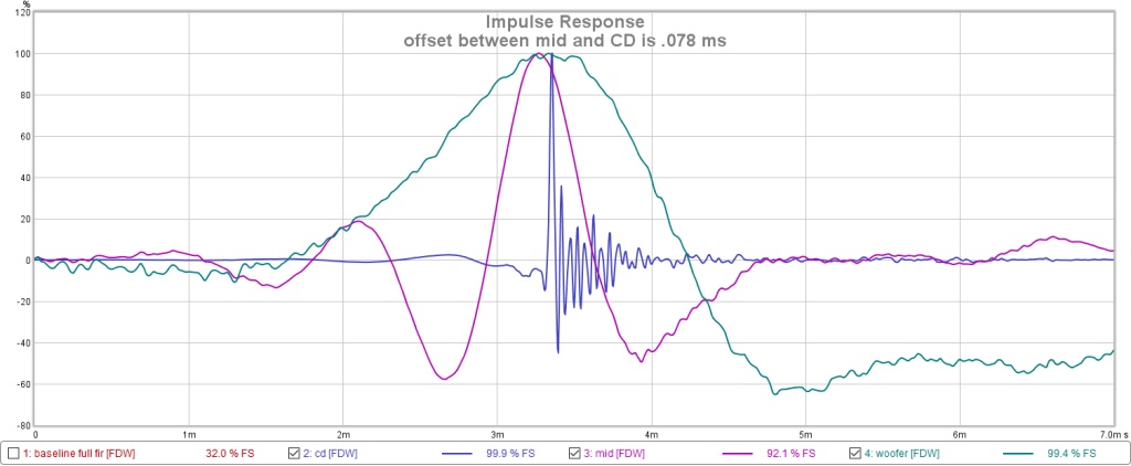

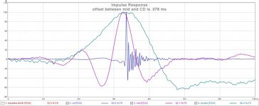

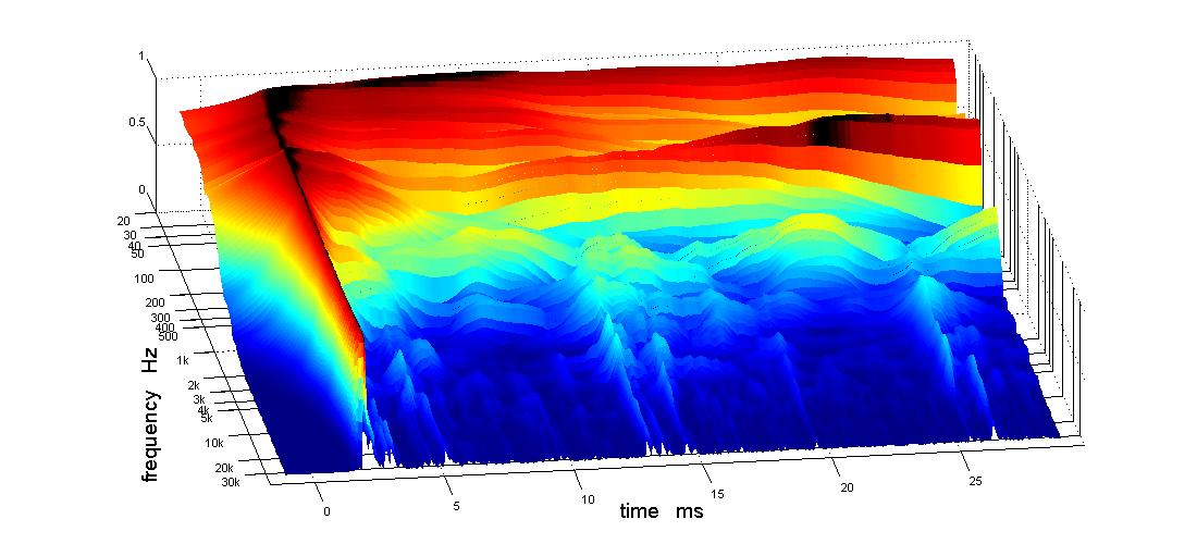

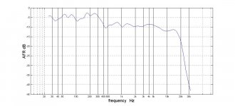

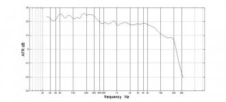

Well, true; but I haven't been completely idle. I decided to find out how much the IR aligment changed due to adding the paragraphic phase EQ to the XO filter linearization. After filter linearization, I had carefully aligned the IR peaks. The picture below is the alignment I had two days ago after adding the phase correction on top of that and probably tuning a PEQ or two:
The CD is correctly centered in the woofer response but the mids are early. Of course I corrected it and then I couldn't help myself and did some re-eq of the treble and that is what I ended up listening to. Fortunately, the timing changes only had a small, easily compensated effect on the frequency response. I think its marginally better than what I had before.
But I see that I'm in a non-converging process. Every time I tweak something, I end up finding something else that needs to be tweaked and I drift further away from the once flat phase. Moving to a linear phase XO might let me break out of that loop. With linear XO filters, I go directly to align on IR peaks and would have more EQ resources for matching the driver target curves.
But before I go there I want to start over clean and see how hard it is to get back to this point. The setup I have now should work so long as I'm careful to realign after each change. What I really need to do is to make all needed changes at one time instead of incrementally. It seems to me I should be able to do a paragraphic gain eq at the same time I do a paragraphic phase eq, with REW doing an auto-EQ of the gain and then me manually EQing the phase of the same measurement.

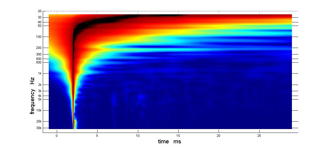

Comparing my latest TDA 3D to Wesayso's what stands out is the clean color band edges around the direct response vs the ragged edges in mine. These no doubt speak to the smoothness of his correction vs the relative roughness of mine - likely due to my manually EQing with limited resources. I'm hoping in that doing a paragraphic rew-assisted auto-EQ will fix some of that.

On the gain EQ? whenever you do gain EQ, if it's not linear phase you should correct phase as a second step. I think you are talking about linear phase gain EQ, which would let you do it all in one step.
As I said before, aside from crossovers regular IIR PEQ would be all that is needed to correct most FR problems. It would immediately fix phase as well.
One more thing: you can do better than auto EQ from REW, trust me. Just make sure you EQ with a FDW of about ~5/6 cycles at the most. As long as you can handle that amount of manipulation in your FIR engine I'd do the EQ manually.

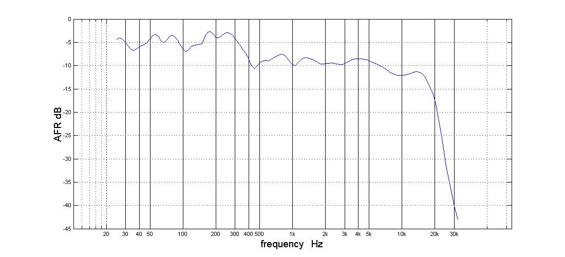

I have to say that the elevated bass and lower midrange is exactly how it sounds. That looks like something that TDA_EQ could fix pretty easily.

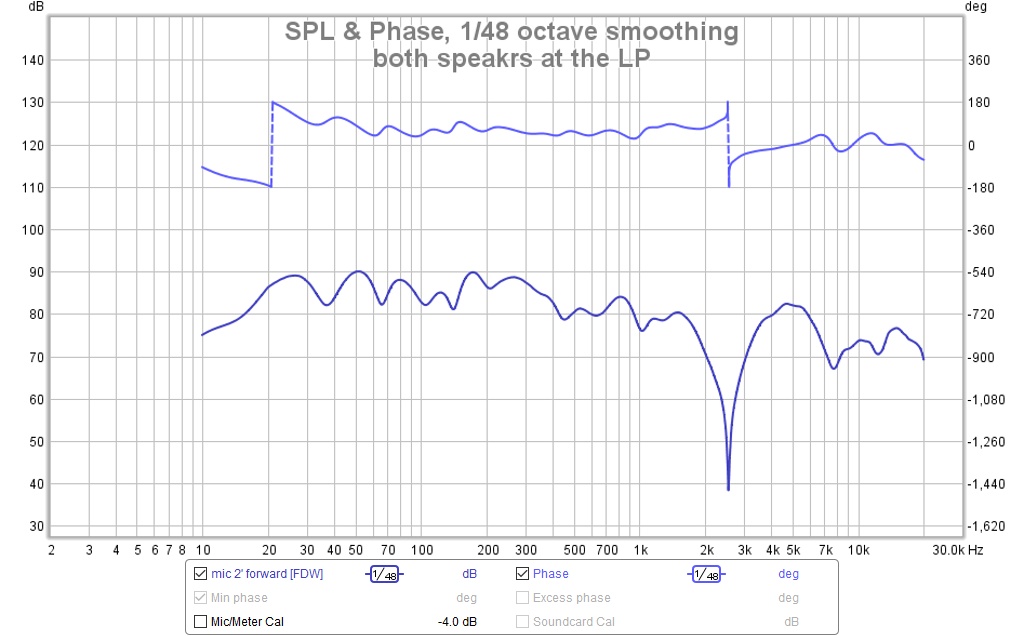

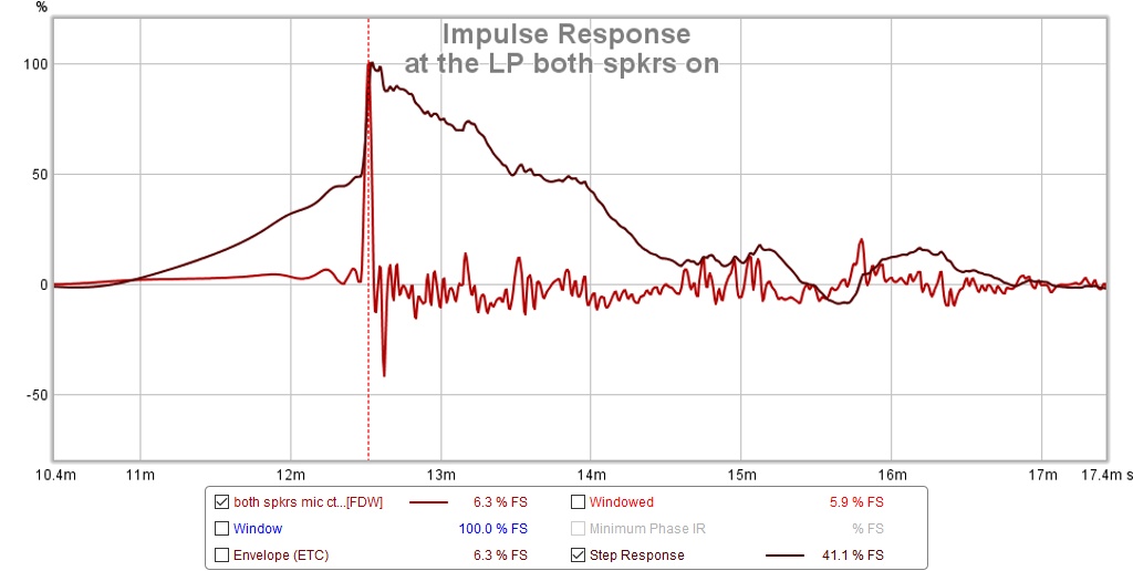

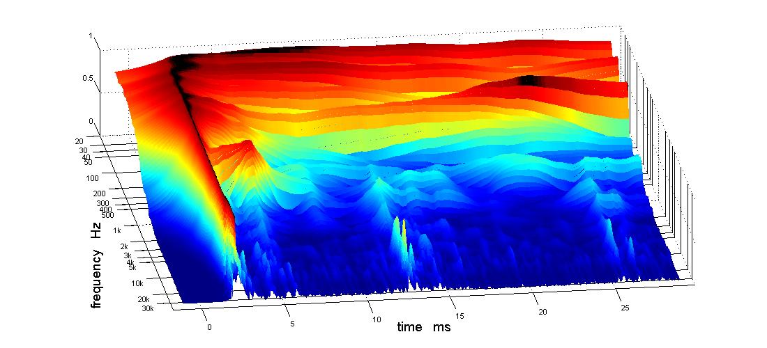

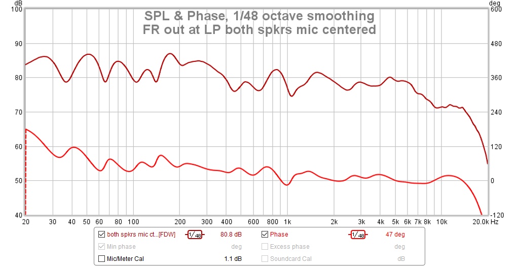

I took a REW measurement out at the LP but with both speakers on so it shows some combing. Those FR ripples in the upper bass smooth out with ERB or psychoacoustic smoothing.
Line up the impulse peaks at the listening position and the combing will go away. Just move the mic till you see one peak in REW. Then rerun APL to see the difference. I'm a bit amazed to see a quicker bass than in the close measurements. As said earlier that might sound weird or off on some material. I'd rather have the plot as in the up close measurements. It will sound more natural.
Thanks for the tip. I should have thought of that.
the cancellation null is gone. I dialed back the woofer level about 3 db but no new EQ
The IR is interesting. That early reflection is now coming in out of phase

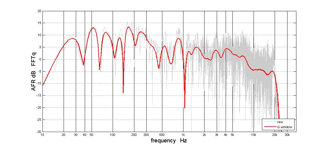

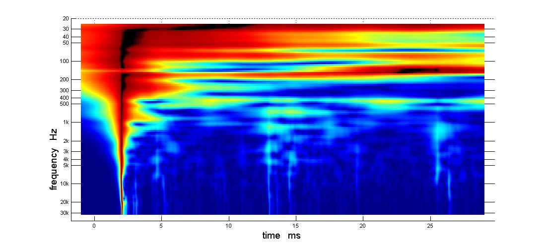

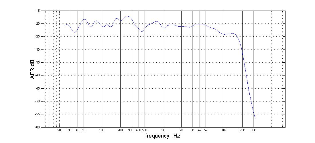

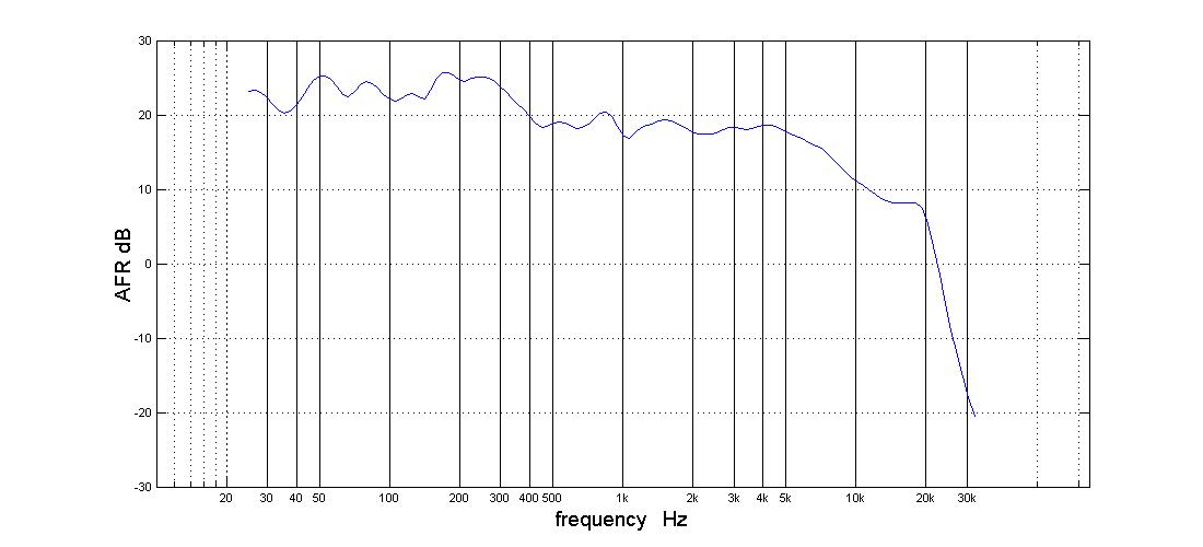

TDA
TDA pl. What is that at 1 Khz?
The direct response has a small dip at 1 Khz but the AFR-Q had a narrow deep null
TDA

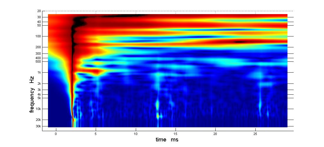

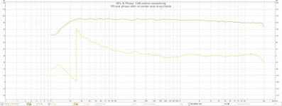

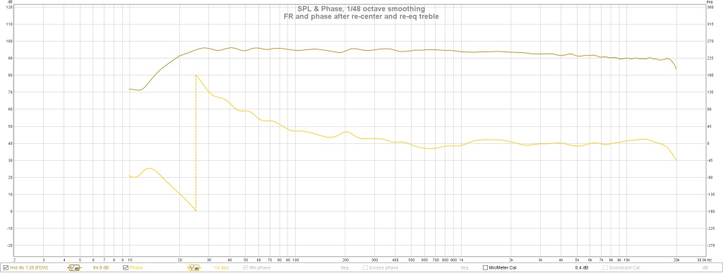

Those TDAs were done before I trimmed the bass level. Here is where I ended up.
I definitely need to do some EQ at the LP. I did a TDA+EQ run but its results were disappointing - overwhelmed by the room modes. For TDA_EQ to work I need to need to get out of the null of that 150 hz or so room mode and I didn't find the right spot today. Considering to average some measurements in REW and use the remaining PEQs in the OpenDRC
This sounds like a plan for now. I'd suggest averaging the measurements with the (A+B/2) done in pairs. That will preserve the phase part and gives you an opportunity to use windows if needed.
You've got to make sure the measurements are all timed alike (for instance at 0) before averaging them though. I'd do it separately for left and right speaker and then check the summed result.
Just a few thoughts...
how detailed an EQ would you do?This sounds like a plan for now. I'd suggest averaging the measurements with the (A+B/2) done in pairs. That will preserve the phase part and gives you an opportunity to use windows if needed.
I was thinking to just try to smooth out the worst several bumps
At the listening position? Just use global EQ, nothing too detailed. Get the general shape right. To really accomplish something you'd be better off finding and solving the reflections themselves.
