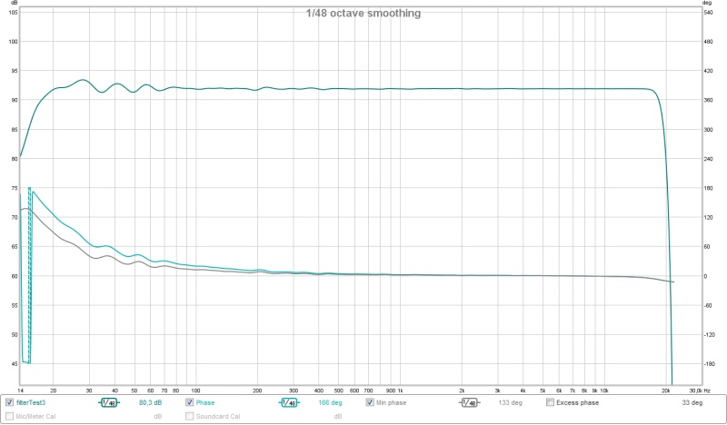

Your new wave file does not seem to be a complete or a valid measurement. DRC-FIR is unable to process it completely with my current settings. How was this file created? I don't feel like investigating this as it does look suspect in REW. That's not a real measurement, is it?
But what it does: Adjust FR as good as possible to the (chosen) target curve and phase to follow minimum phase for a 1/6 octave frequency dependent window (which shows a lot more detail than the same window size within REW). In the low end a different (much shorter) frequency dependent window is used to remove excess phase.
That's it in a nutshell. It's way more complicated than that though, but for that just read the DRC-FIR documentation first: DRC: Digital Room Correction

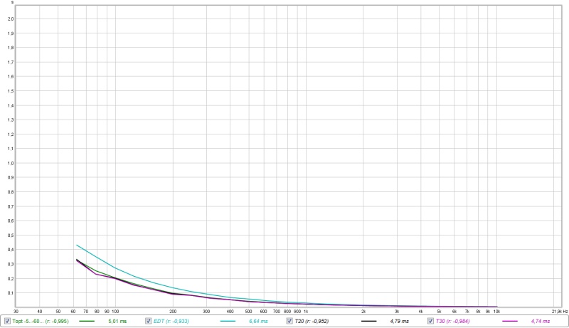

What room did you find that gives these kind of RT60 graphs
I bet record producers as well as speaker designers everywhere would like to know .

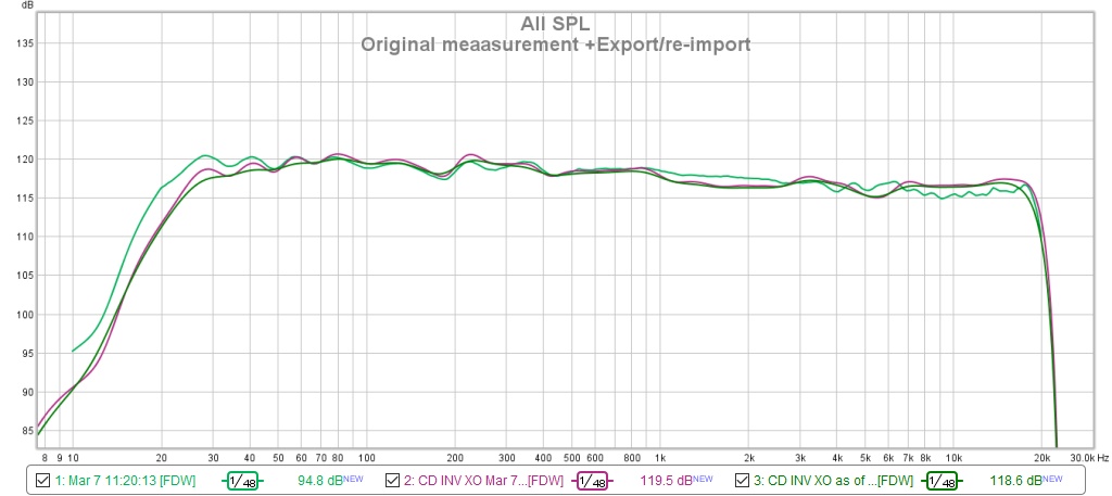

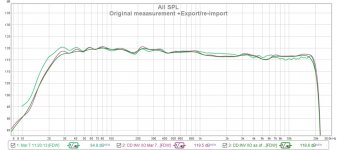

I'm relieved to report I'm not as absent minded as I feared. I re-imported the exported IR to REW and it looks like a highly smoothed version of the measurement. I then repeated the process this time not checking the box to apply IR windows. This one looks less smoothed but still somewhat smoothed compared to the measurement. My IR window is doing its default 5 cycle FDW. The windows reference time might have been off for the original export. This one I for sure hadn't touched it. New export attached.

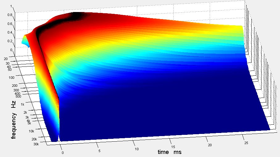

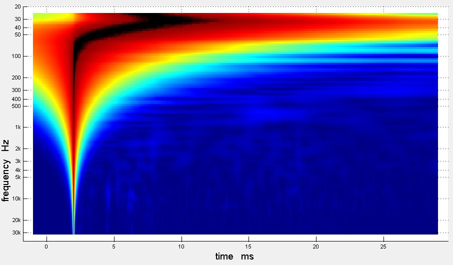

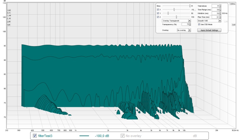

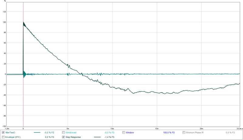

Here we go:
FR graph:
IR:
Waterfall:
P.S. The ringing in the IR is the conversion between 48000 and 44100. No pré ringing anymore though.
Imported in APL:
The strange bottom end is because the predicted result in DRC-FIR gets cut off. In real life you'd a more gradual bottom end.
Disclaimer: While this result was obtained with DRC-FIR it is using my own templates, none of the standard stuff. I've worked on it for about 6 months and continue to tweak it. It is based on personal preference in listening tests, non standard windowing and exceeding some values. I've shared a previous version once, it should be available in my thread. I've continued working on optimising it though.
