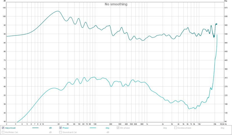

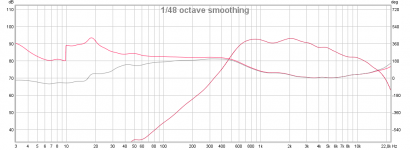

For me it would still be interesting see another tweeter measured in exactly same chain because they don't track close and from about 4,5kHz absolut phase start lagging direction but minimum phase doesn't.

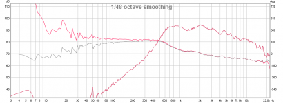

Here is my raw 2426H 1/48 smoothing:
attachment.php
Here is my raw 2426H 1/6 widht in octaves FDW:
attachment.php
See how they track above even phase change between the two 🙂

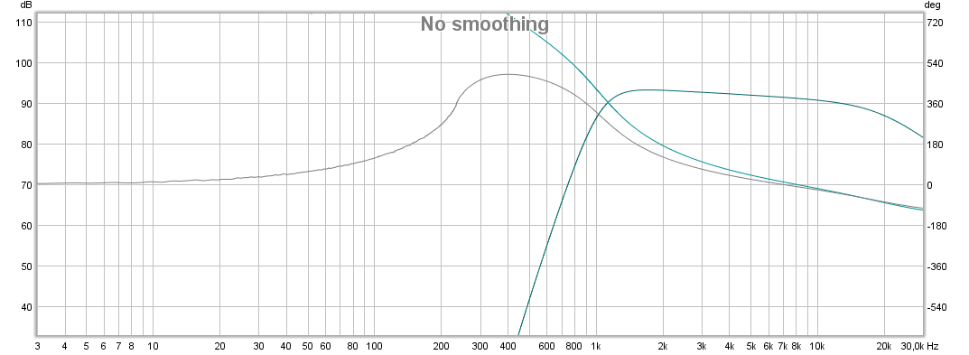

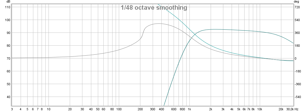

Here is reference IR for your tweeter bandpass no FDW:
attachment.php
Here is reference IR for your tweeter bandpass with FDW 1/6 widht in octaves and interesting how knee of slope gets softer:
attachment.php
Here is the reference FDW 1/6 widht in octaves verse live BMS:
attachment.php
By the way some versions of REW can introduce some errors here and there, any chance we fight a unfortunate version here.

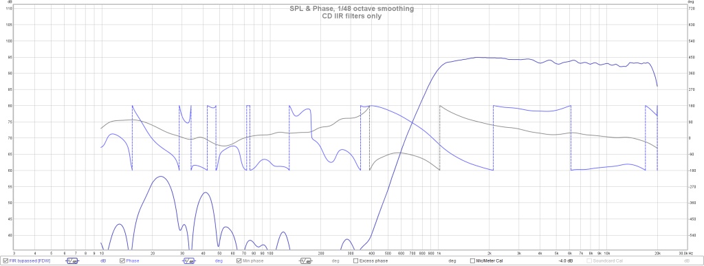

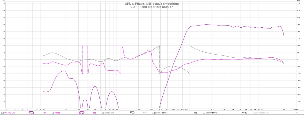

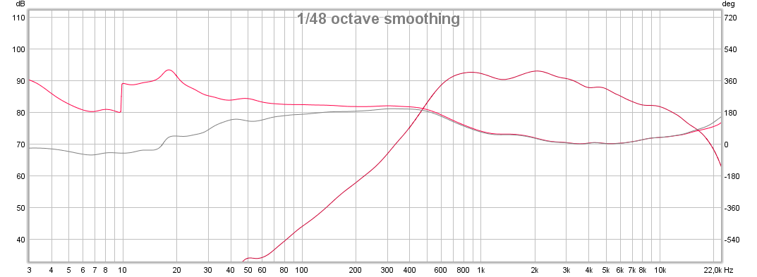

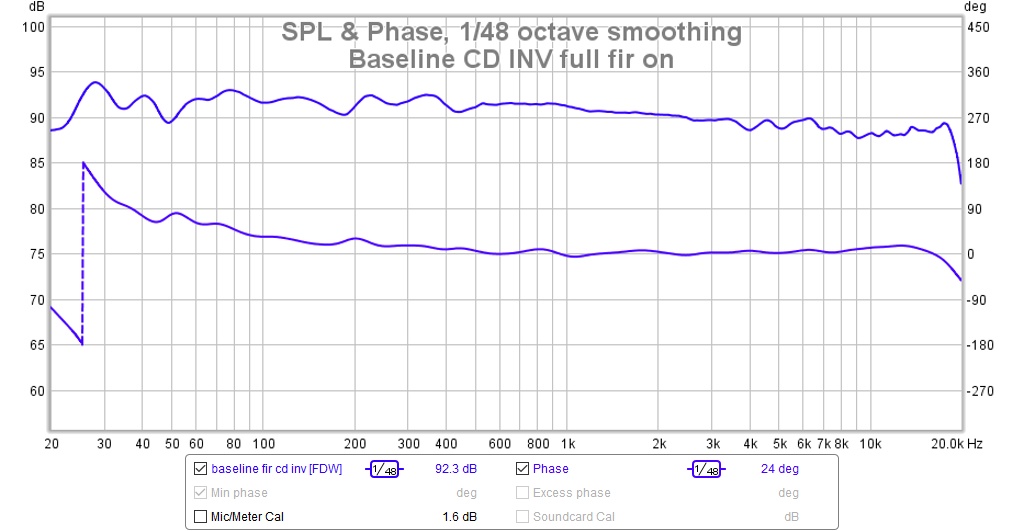

I know, that LF noise is suspicious. Let me remeasure. These are hot off the mic. Filters are from yesterdays CD INV XO that uses both XO filter linearization and phase correction from just under 1 Khz up.
This is with FIR on
attachment.php
This is with only IIR filters
attachment.php
There is still some LF noise but its a lot further down
This is with FIR on
attachment.php
attachment.php

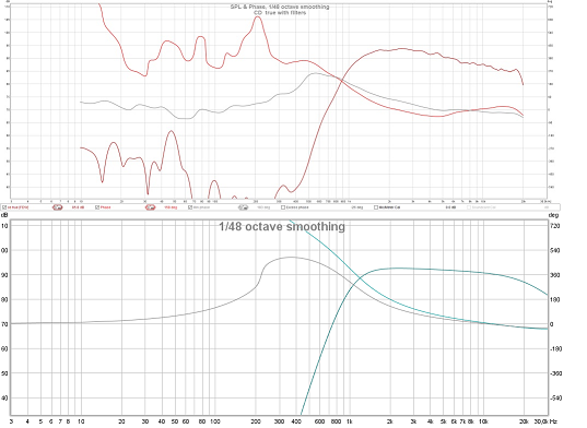

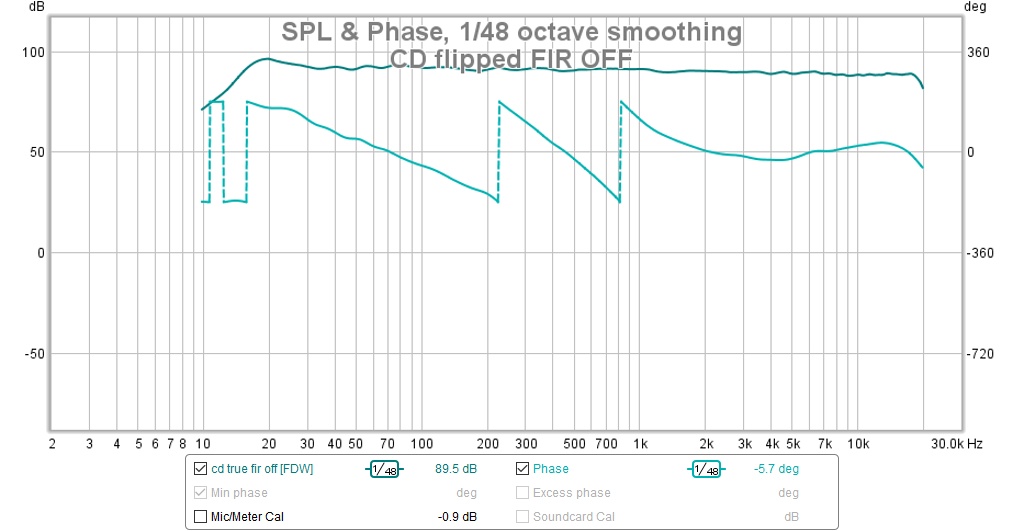

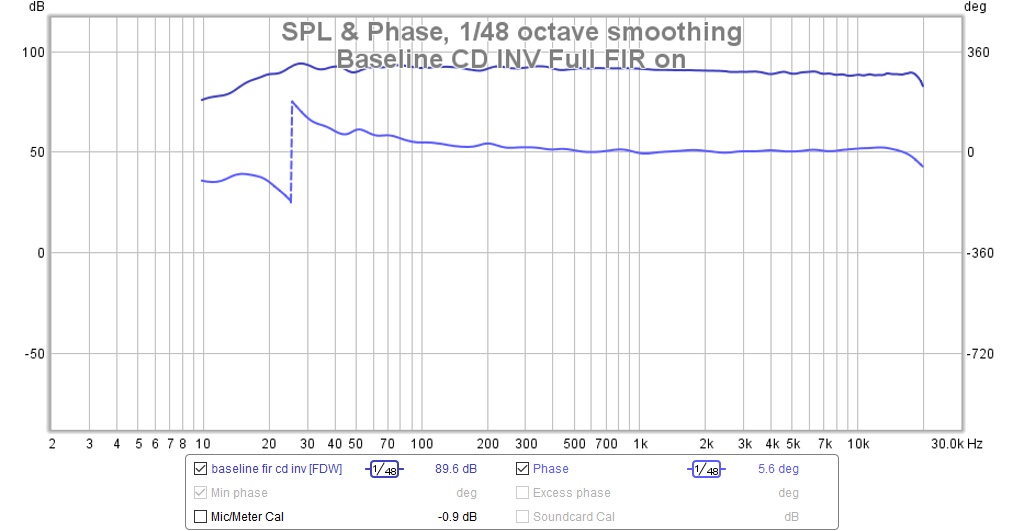

Here is the baseline measurement for CD INV, filters linearized and phase corrected
attachment.php

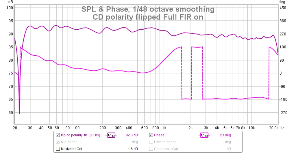

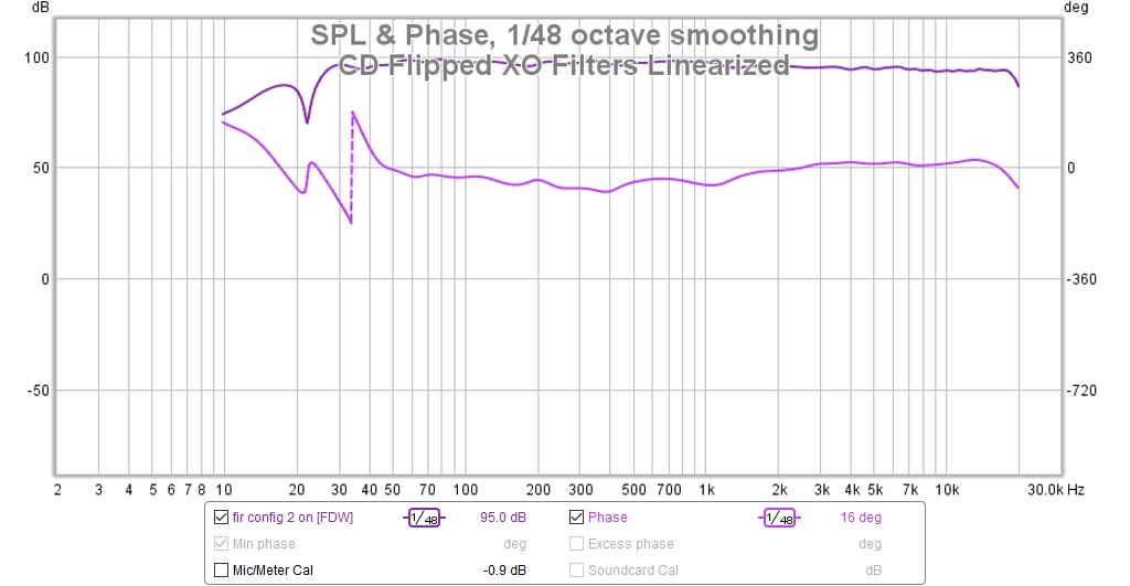

Here is what it looks like with CD polarity flipped back to true. Surprisingly to me at least no DIP in the FR at xo results
attachment.php
Let's now turn FIR all the way off and see two phase turns where reference shows 3
attachment.php
Now lets turn just the XO filter linearization FIR on
attachment.php
Next I'm going to export that last measurement to REW and make a phase correction for roughly 1 khz up. I'm not sure what that will do for the step but right now it needs some help, as you can see below.
attachment.php
I should also check IR peak alignment...
I have no idea why that 20 Hz null appears with CD polarity flipped to true.
Let me repost these figs at better scale

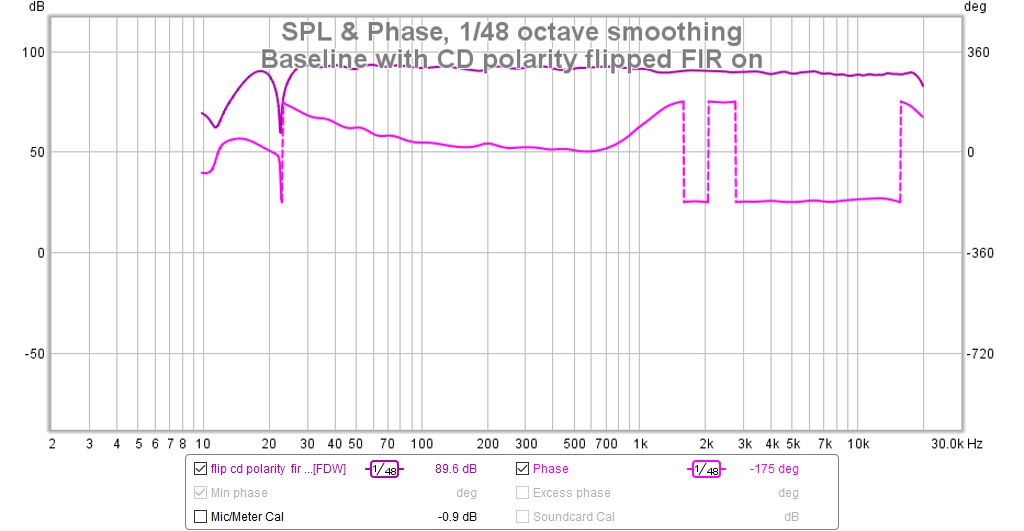

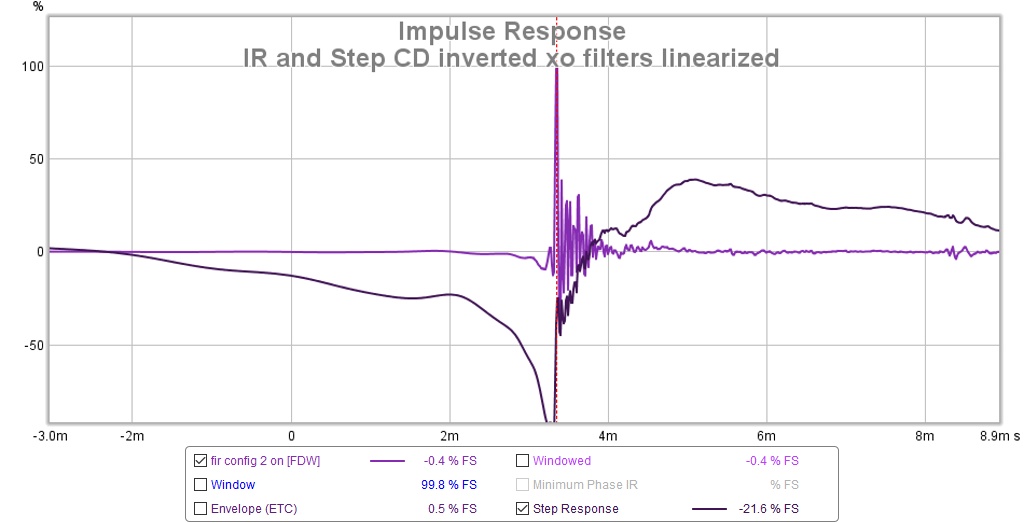

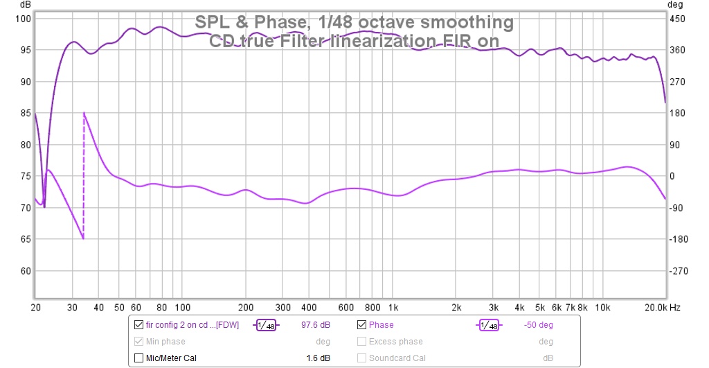

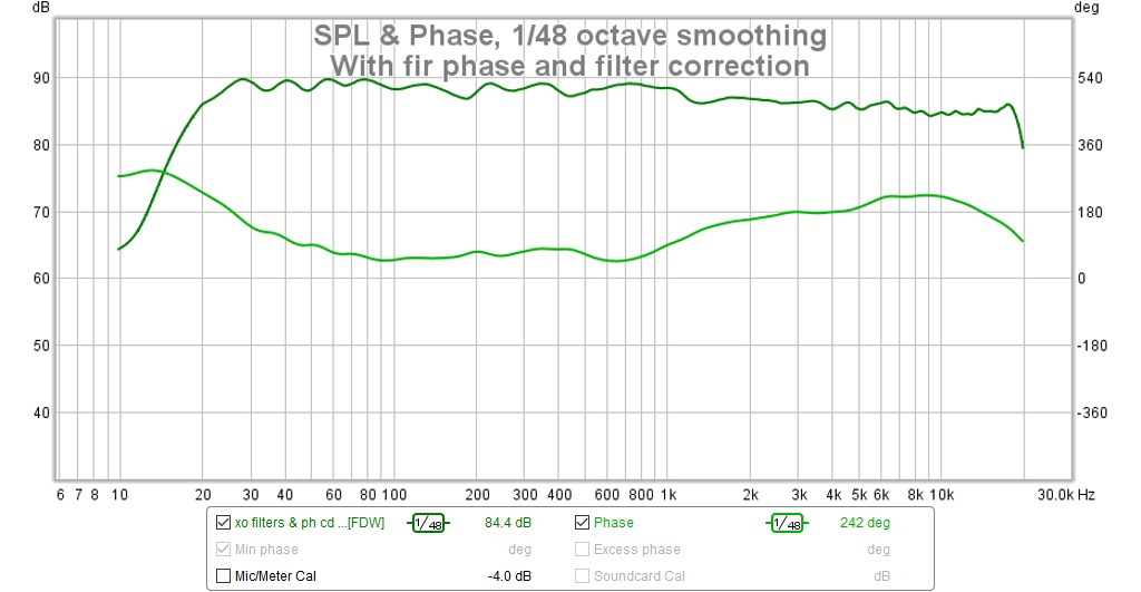

I got interrupted but I did complete a trial run of correcting the phase for the CD true case. Results indicate need for more detective work.
Here is the FR and phase. Phase did not come out flat and there is a 1.5 db dip just past the 1050 hz XO, likely easily corrected by PEQ.
attachment.php

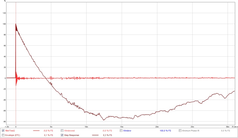

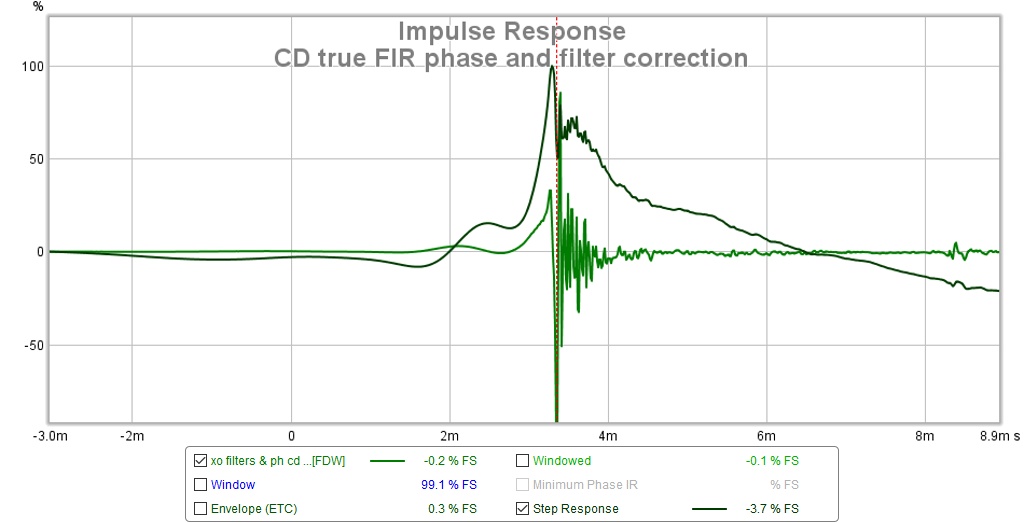

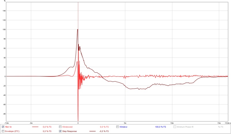

Here is the IR and step
attachment.php
It looks to my uneducated eyes that the CD is firing late and in the wrong direction. Perhaps the phase changes upset the driver alignment but there is still the polarity issue. I have to dig deeper but I can't do that right away.
Only the top end fires late, which will dominate how an IR is shown. If we correct this top end phase, the IR should look better.
Here's the convolved correction for that older wave file you uploaded:
attachment.php
As can be seen it corrected the phase of the top end compared to the mid/low end. (and a lot more)

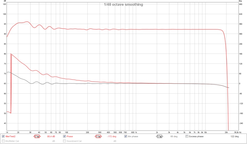

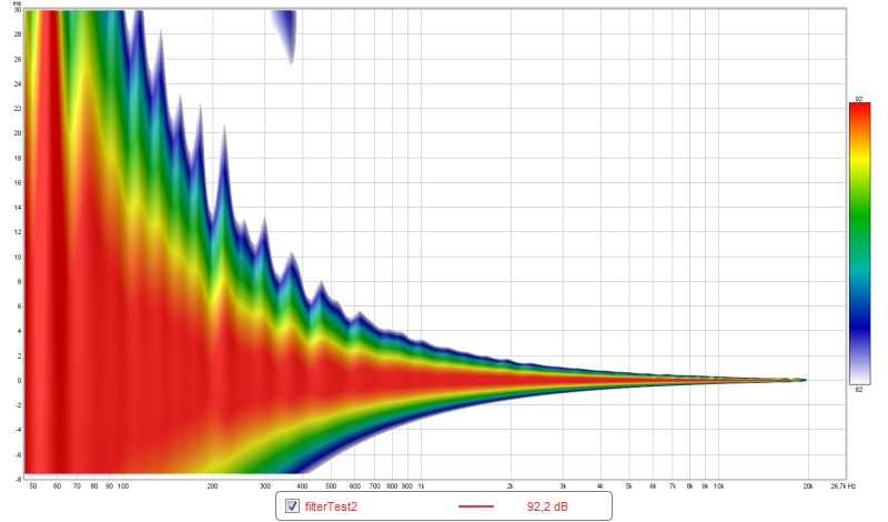

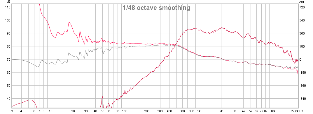

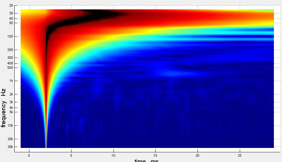

Just ran my correction again on that older wave file you posted, this time with a flat target.
In no particular order I'll show the pictures:
attachment.php
Frequency, phase and generated phase
attachment.php
IR and STEP
attachment.php

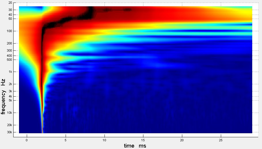

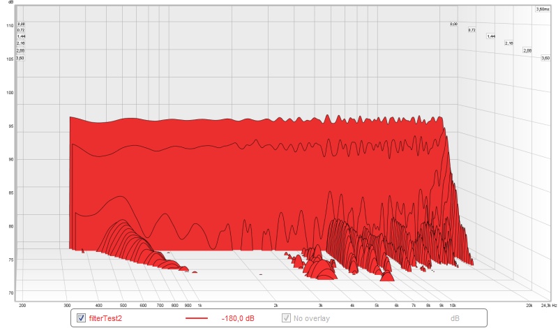

Early waterfall plot
attachment.php
Wavelet showing no dents...

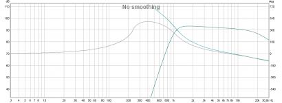

Based on this IR/STEP:
attachment.php
I had to convert back and forth between 44100 and 48000 because I simply don't have my templates set up for 48000.
This still is with specific settings for my arrays. Gentle clean up based on very short frequency windowing. That's why the bass doesn't get cleaned up entirely I suppose. I have very conservative settings, feathering the phase response into shape.

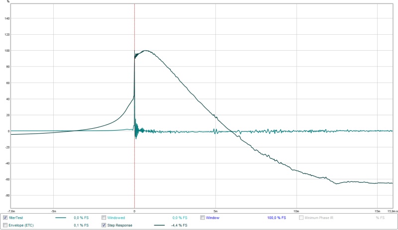

This is what I started with, your wave file as viewed in TDA:
attachment.php
And the IR/STEP:
attachment.php
