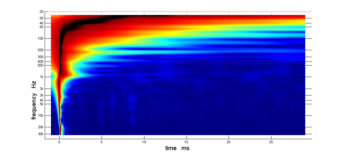

MY IRs have shown ringing since day one. Its been passed off as one thing or another but we've never really focused on it as there have been higher priorities. Its good to know that at least some of it is cleared up by EQ. I have been concerned that it might be due to the unterminated horn mouth or throat imperfections.

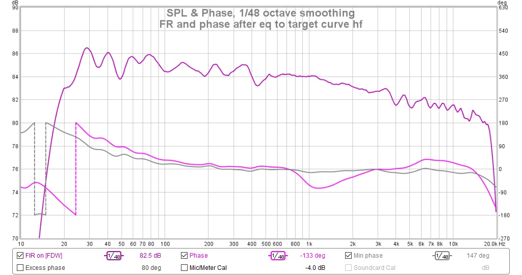

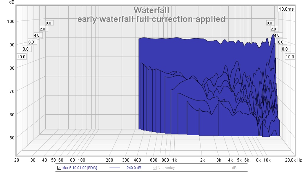

something to show after changing several things one thing at a time and recording all my steps.

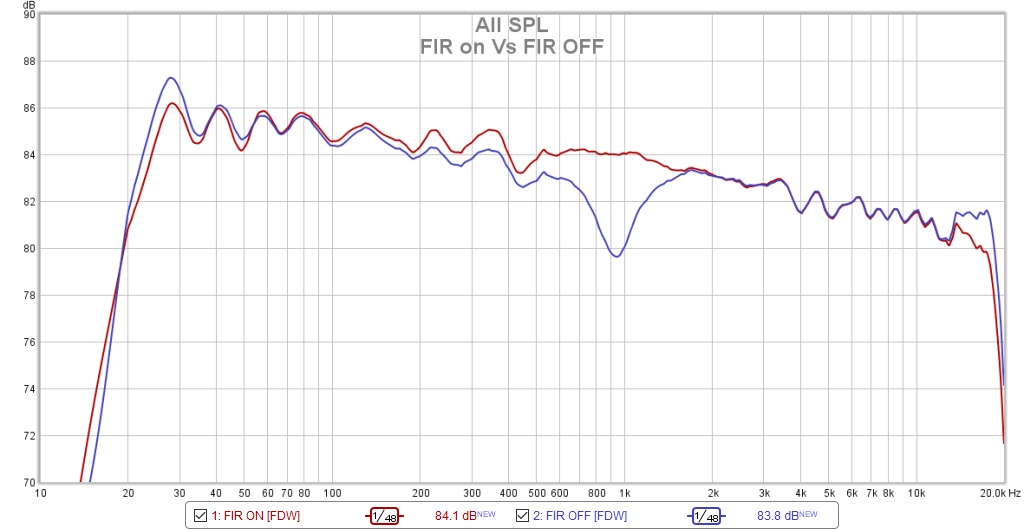

First thing I saw was the HF didn't match the xo software prediction. I re-eqed it, then compared FIR on to FIR off. The FIR is doing some additional attenuation at the high end and a little boost at the low end. The dip in the middle is the reason why we've had so much difficulty finding time alignment.

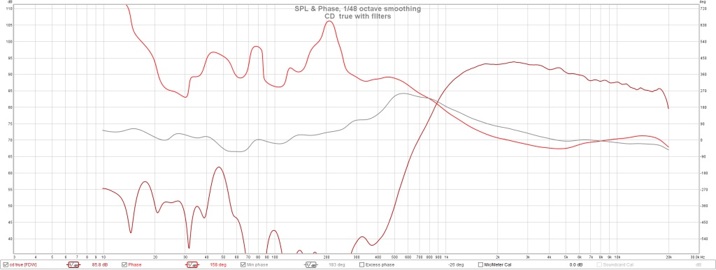

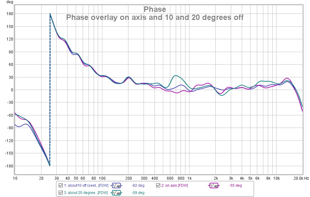

here is what the phase looks like in REW
You can see that I've shifted the IR to zero to remove the excess phase.

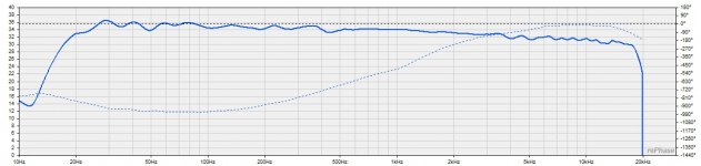

Here is what the FR and phase look like imported into RePhase
It looks like the excess phase is still there. How do I get rid of it?

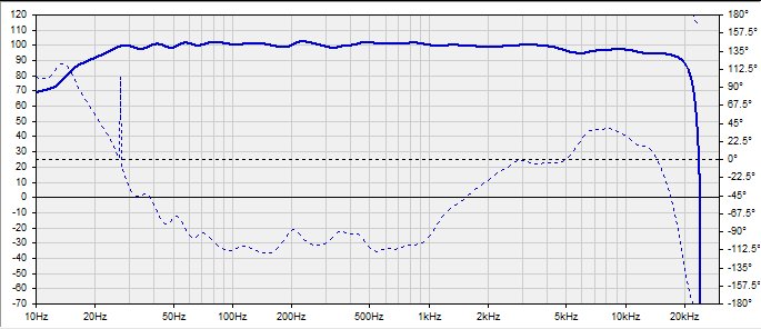

Based on your wave file from earlier I made an frd file to import in RePhase:
So I'm not seeing what you are...
Set the impulse peak at zero in REW from the measurement you want to export. Export the IR as 32 bit mono wave file and re-import into REW.
Check if the impulse is still at zero. Export the IR you just imported as a measurement in frd format and import in RePhase.
That's my suggestion. I couldn't find how to export the FDW version though, even though I told REW to apply IR filters it still saved the entire unfiltered IR. I'd want to have the 6 cycle FDW version in RePhase or I would be equalizing the room instead of the speaker. I know of a way to do it, but that would involve using DRC-FIR to do the frequency dependent windowing. I'd even prefer that option as DRC-FIR is showing way more detail than REW's version of frequency dependent windowing.
thanks. that worked the 2nd time I tried it - after restarting Rephase

It could be worthwhile to look at off axis at this point to see what the IR looks like there.
Solving those early wiggles in the IR will make imaging more clear.

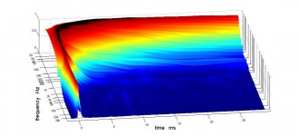

Generate an early waterfall for your current settings and it will be obvious things don't line up right now.

If you ask me, the reason for the deviation is the CD when placed in a horn, making the top end drop which causes a close to one order difference once you EQ it back into shape. I guess that's what BYRTT was getting at. The twist in phase in the CD. Plus the output of the mid is probably boosted on its band pass top end to make it reach that high?

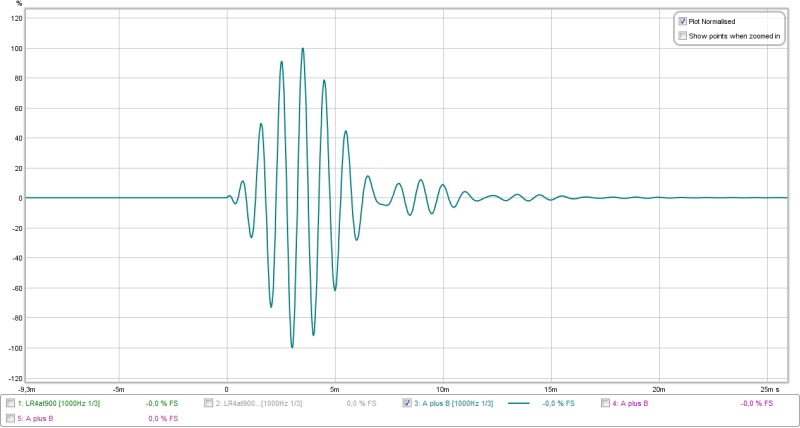

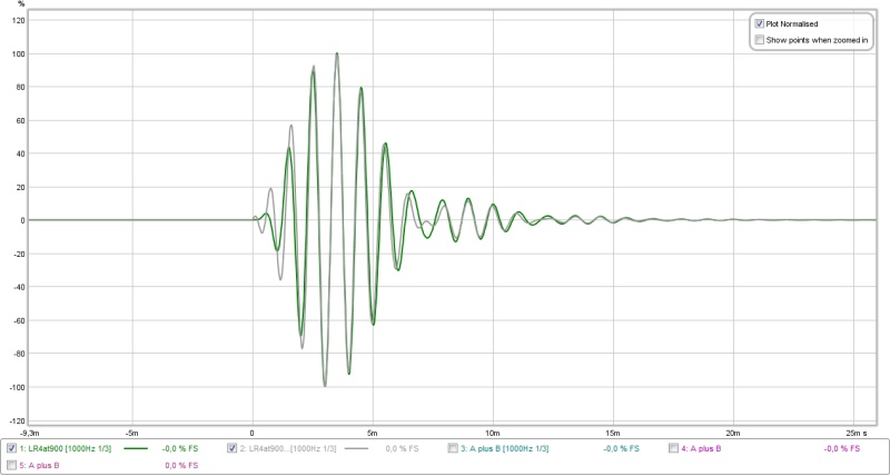

Now I said we need to align the wave shape at the crossover a few pages back. Lets look at what happens slightly above the crossover, both drivers will sum there to form our wave shape.
Looking at each part separately we see both drivers still line up there (using overlays window in REW):
See how both drivers add up to form the sine wave at 1000 Hz? Here we see them both add their part.
To view this I chose a 1/3 octave filter for each separate driver at 1000 Hz (just above my crossover at 900 Hz) and looked at the IR's in the Overlays window in REW.
If we look at it in the summed LR4 filtered at 1000 Hz (also filtered 1/3 octave at 1000 Hz) it looks like this:

If we get the separate parts within 1/4 wavelength of each other they will still sum. As your example does above 1050 Hz. But once you get past that quarter wave distance between each driver's wave shape it will create a shallow dip, like the one in post #463.
If you force that back into shape, it will create that wobble with extra energy at one side and missing on the opposite side, like we see in the APL_TDA plot just below the crossover frequency:

Perfectly corresponding in frequency placement to the dip in the FR plot without the FIR correction applied.

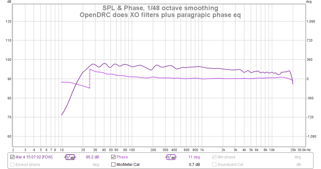

Well, I kind of hoped that I'd get to listen to enjoy this configuration for a couple of days before the other shoe dropped but I knew something would be coming as soon as I saw the TDA phase plot. Its hard to imagine the sound being better.

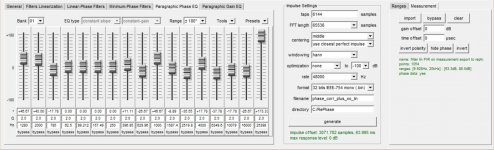

I recall when doing the final phase correction at/around 1 KHz, I needed to set the sliders to +/- 180 degrees to be able to do the correction. I think this is the correction and if you can read the fine print, the slider at 1000 hz is correcting 46 degrees. The 3 leftmost sliders are also correcting this region.
So that is the counterpoint. If that is all the phase change it took to get flat phase and a good step, then the CD must have the correct polarity. I still have more of my AM ritual to get through before I can go through your post point by point. I came up here to look at Rephase expecting to find that I had used more than 90 degrees of correction

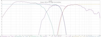

Here are the 1050 Hz driver target curves plotted against the drivers measured with filters in place. This is from the original 1050 Hz XO, with CD not inverted, which also had issues. The full range curve is a REW ((A+B) + C) computed sum of the three drivers. Edit: Actually its two separate overlapping (A+B)s
re'
edit: mid didn't need a boost. There was big peak circa 800 hz from horn gain and bandpass chamber that needed to be cut. Yes constant directivity horn needs +6db curve to flatten HF

I still don't know why we moved to LR8 as LR4 should work as well.
The compelling reason was noticing that the CD's raw response was LR24 and additional roll off was needed to protect it. Switching to LR48, eliminated the harshness I sometimes heard on loud passages
This means the phase of the CD and mid does not line up as it should
Before I corrected it in Rephase, yes.
In the miniDSP, do you have named crossovers set?
Yes
While using PEQ to make sure they follow the expected slope?
Yes
Right now the top part of the slope works, crossover is at 1050 right?

This TDA plot makes me think you were better off without the CD inverted and dealing with that twist in the CD phase with RePhase of this plot:
You might think so until you look at the step response 🙂 Seriously, all the work of the last few days was trying to get a good step response.

Off axis response
All the recent measurements have been with mic in line with my sweet spot, which is about 10 degrees off axis. Here are looks either side of that
Keep in mind its a simple conical horn, not a SEOS and that the scale is 2 db per division. It holds pattern down to 328 Hz without aid of the corner but does suffer waistbanding in the octave or two above that. This is a little worse than I expected. I had hoped to get within +/- one db of the center measurement when sitting on either side. Maybe I will get there with the 2ndry flare I have half finished down in the garage.
Here is the phase:
Its a point source from 300 Hz up so I expect the phase to behave. I don't know how this compares to other Synergies though. I'm actually surprised to see phase tracking through the woofer passband since it has a physical offset from the horn
Here is the phase:

But this measurement of the CD alone, with filters on, shows the phase tracking close to the min phase. (Ignore anything below 200 Hz as there was low frequency background noise during the measurement. Washer/dryer is in the next room.)
