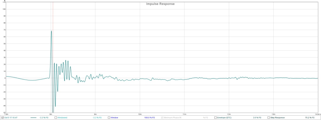

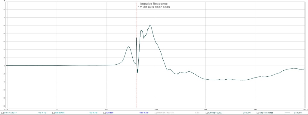

You are on the right REW tab, but the legend shows the STEP is chosen.
Remove the [v] from the STEP and choose the first in that legend (Oct. 5 17:10:47)
Then zoom in on the first ~ 20 ms or so. That should show us an IR.
It should also show the reflection at 8ms as a peak. The second set of APL plots at 3 meter show a much later reflection, at 13 ms, right?
So it moved 5ms while you moved the mic back 2 extra meters.

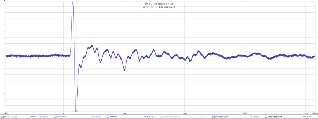

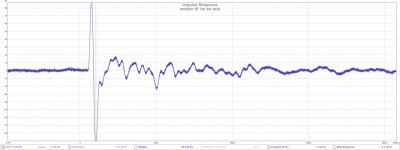

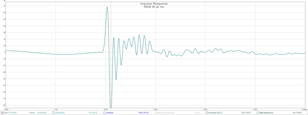

That is more like it. Thanks! Here is the 1m IR:
zoomed out:

So much for that theory🙂
Here is the real woofer IR:

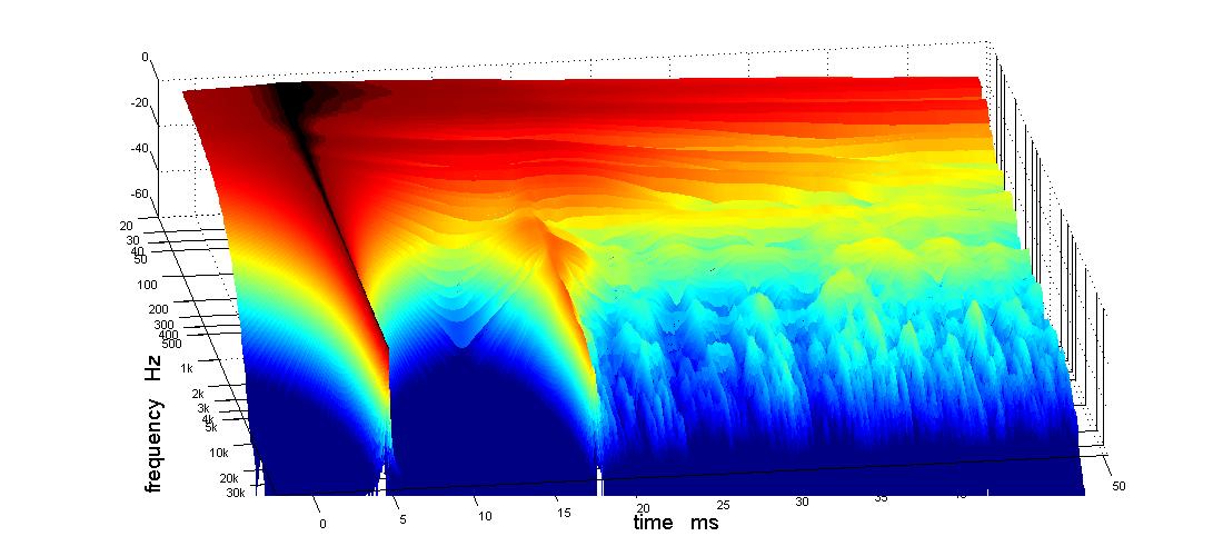

REW and APL should agree on what's happening, but you've got to keep in mind that APL uses a series of frequency dependent windows to plot it's output. So to get an REW comparison you should also use a frequency dependant window for the two to agree.
In REW you can also use a Wavelet within the Spectogram tab. This should present similar data to APL when you set Time Range (ms) to ~30 ms.
In my case:
And it's APL equivalent:
See how they agree? Just a different graphical output based on processing very similar data. Taken within a few minutes of each other. If they don't agree with each other I'd look harder to find out what went wrong.
You're in a room. if you plot a 500 ms window in REW that room is in there. Below ~200 HZ it's in there anyways. APL filters in small frequency dependent slices to see what happens over time. REW can do frequency dependent windows but they tend to be overly smoothed. It does not use the same way of plotting APL does.

Y The second set of APL plots at 3 meter show a much later reflection, at 13 ms, right?
Yes, I see that now; need to think about it. I've got another view from another position that shows it at 16 ms. Maybe I can triangulate.
That first IR plot shows us about 6 ms after the main pulse? If there wasn't anything beyond that 14 ms point you don't have any additional reflections, yet APL did show us something there.
They definitely don't agree so far. They shouldn't be able to each tell a different story. So something went wrong. It's way past my bed time, I'm gonna go now. I hope Bill will show you his IR now that we actually see yours.
Something is fishy with the APL plots. They should confirm what REW tells us. Just look at my 2 plots, the REW Wavelet and APL's 2D plot... both show something in my room at 6 ms and ~5 KHz. The wavy shapes between 100 and 200 Hz are present in both plots...

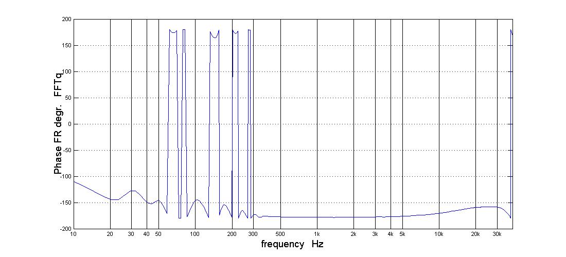

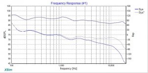

NC535 -
A phase of 180 degrees is exactly the same as -180 degrees, so everything in the new phase plot
is within about 25degrees of flat. Invert the phase (via software or swapping speaker cable polarities) and you should see that.
Which I don't think is likely to be true using just IIR filters, unless you got the timing between tweeter and mid and their crossover roloffs rather amazingly right (in which case, I'm impressed). Is that maybe a "minimum phase" (Hilbert) converted version?

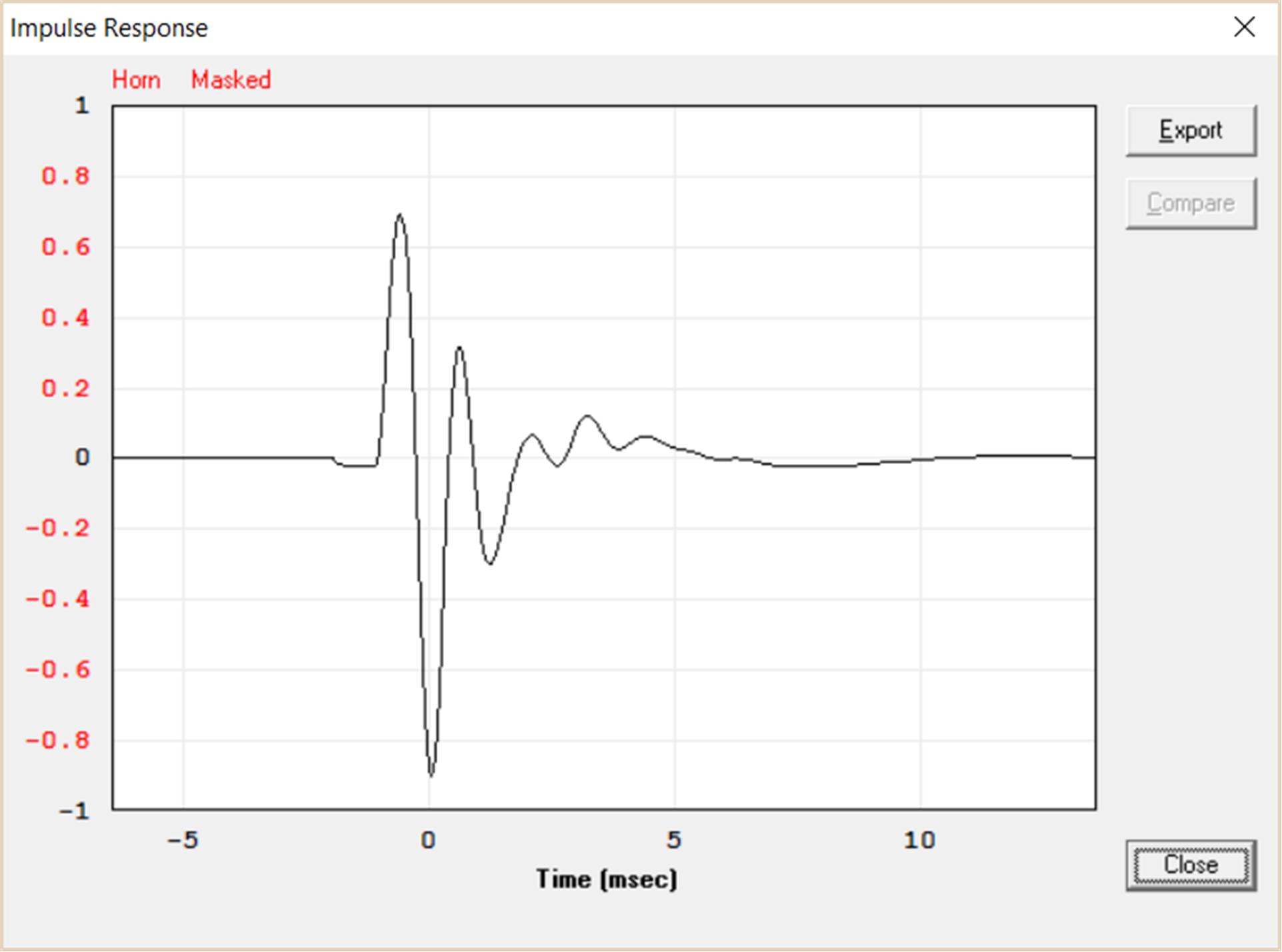

I was looking around and couldn't find a pic of the IR of the most recent passive crossover for Cosyne. But here is an earlier one
I think there's a more recent one somewhere in the thread there, I have company coming in a few minutes, but here is the thread link:
DIY Synergy/Unity spreadsheet | Page 3 | HiFiCircuit
The one that is further cleaned up with FIR is cleaner (as you'd expect). The Step Response (which doesn't just emphasize high frequencies like IR does) isn't as pretty, but still decent.

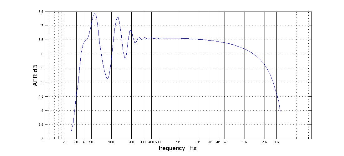

One more question from me, in APL, what does the AFR plot show? That's it's frequency plot. I'll look at it in the morning 😀.
No that is a real IIR result . The only DSP I'm using is MiniDSP 4x10, which isn't capabile of FIR. I ddn't do a minphase conversion or display. What I did was spend hours literally dialing it in.
I was also surprised at the result. But if you get a flat frequency response, don't you then expect a flat phase response? ...Except where its not minphase.... When I ask TDA to subtract the minphase components, the phase plot flattens out. Its seem to be the same plot with those phase flips removed.
If +180 and -180 are the same, and they are obviously the same on a circle, and I do recall the rotating phasor diagram lecture from EE 101, why does the phase plot flip back and forth? I know - phase wraps where the delay that phase integrates to is a full cycle. If I ask TDA for a minphase corrected group delay plot I get something that asymptotically approaches a perfectly flat line as frequency rises, visually flat above about 80 Hz.
You can see in the REW plots that no data is taken above 20 Khz. TDA apparently sweeps to about 32 khz but you can't really see amplitude response in the 3D TDA plot. Parallax will get you if nothing else. Here is what APL calls the AFR:
and yes, the response is indeed tapering off in the high end, making it fair to ask why is the phase flat. There may be an explanation in the way APL does things. I look to REW for timing info. TDA is better for visualizing group delay and room impacts. It also has proprietary mechanisms for deciding what to correct and for doing the measurement and correction but I haven't got to them yet.

If anything is suspect, it would be APL but only because APL is more of a black box, no reflection on APL or pun intended. APL doesn't have a preferences screen for example or much control of the sound card. From the APL screen, I can see I've set its output for mono and input for "left". I need to do another APL measurement with input set to "right". One of those two is a direct wire. But a wire would be perfectly flat and the APL results are not those of a wire, even though the group delay is impressively flat.
Your theory looks pretty good but how do you account for my first two TDA plots, those taken at 1m both with and without floor pads?
How do you account for that ghost reflection if we are looking at the response of a wire?
There is no way REW could be showing me the response of a wire. Yes, I've produced a trace that looks flat, from a distance at any rate, but that is the result of hours of tweaking. What I started out with was anything but flat and in no way resembled a wire.
This is not a wire! (high dynamic range option)
and if I should turn out to be wrong, just remember that I started out by saying it was too good to be true🙂

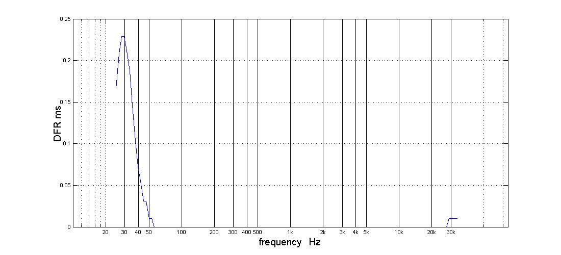

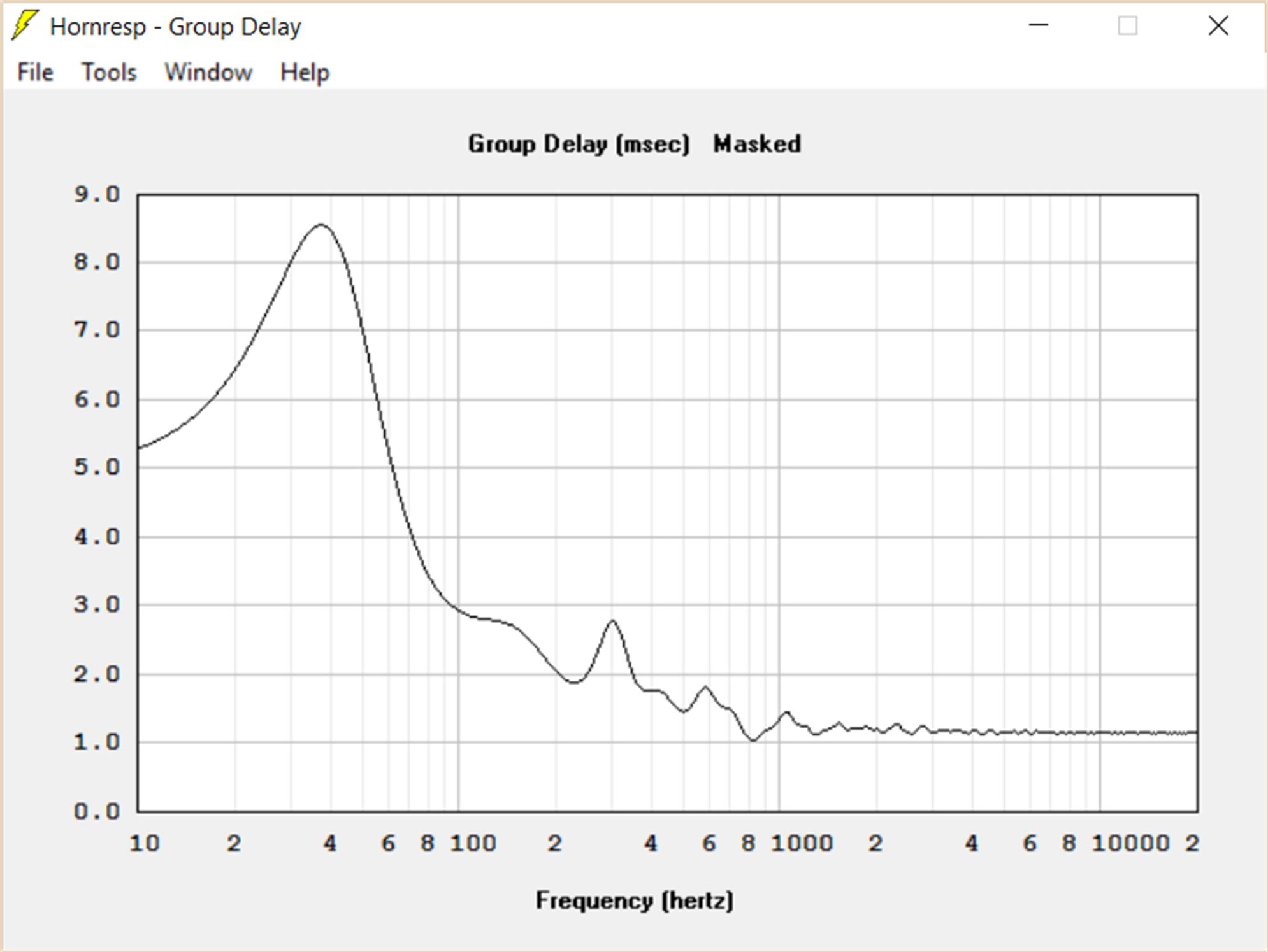

Here is a HR plot of the bass bin group delay. I have dsp delay dialed in to match group delay at the 210 hz XO to the Synergy.
Here is group delay from APL.
They are not inconsistent with each other. The slow rise of GD between 80 and 200 hz that we see in HR is hidden in the thickening of the trace in the APL 3D plot.
Only for a single driver or device.
I'd about NEVER expect a flat phase response with a multi-way speaker! Unless the designer went to an immense amount of trouble. Even Danley's SH50 isn't all that flat in phase. (I don't count the first order crossover speakers using non-concentrically placed drivers, which can show a pretty flat phase response but only if the microphone is at a very precise location).
It doesn't. If the phase moves from -179 degrees and then to +179 degrees, then it has only moved two degrees, but that graph will make it look like it went all the way around the clock because it is set to show phase as "wrapped". Meaning it will never show anything below -180 degrees or above +180 degrees. Actual change is from -179 degrees to -181 degrees, i.e., -181 degrees will be shown as +179 degrees, and the software plotting routine is playing "connect the dots" between its calculated or measured frequency points. Take any angle and add any integer multiple of 360 degrees to it and you have the same angle in every way except for the number shown and perhaps how it might be graphed. The concept of phase is based on sine waves, and looking at a single frequency, you can never know how many whole periods of a sine wave it might have been shifted from one picture to the next. Look at a continuous graph of phase over a wide range of frequencies, starting from 0Hz you can, but we can never see speaker response at 0Hz nor do we ever really get a continuous graph of phase (it is always at a series of discrete frequency samples).
That is actually feasible (to get near flat phase with tapering high end). Another thing about phase response measuring is that it is usually shown in a relative way, IOW, it is shown with enough delay added or subtracted to make the phase look flat over some range or to minimize the number of phase "wraps" (which often signify not much of anything, as discussed above). Adding a fixed delay is the same kind of thing you'd get from moving the measuring mic closer or further from the speaker. Phase is never really flat at 0 degrees because that can only be at a place where there's no room for a mic - it is at best 0 degrees plus-or-minus the effects of some fixed delay! Since phase is "periodic" (the -180=+180 thing), most software will remove delay to make the phase plot more comprehensible by minimizing jaggy looking wraps or best flattening the curve at HF.The response is indeed tapering off in the high end, making it fair to ask why is the phase flat.
Another display option is "unwrapped phase" display, but that tends to give poor display resolution as the vertical scale can get to spanning thousands of degrees, so is seldom used.
For example, here are some phase responses of the same magnitude response, of the same speaker in fact, measured with different amounts of delay included. The difference in delay here is equivalent to moving the microphone 2 tenths of an inch!:
