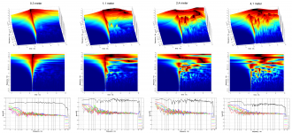

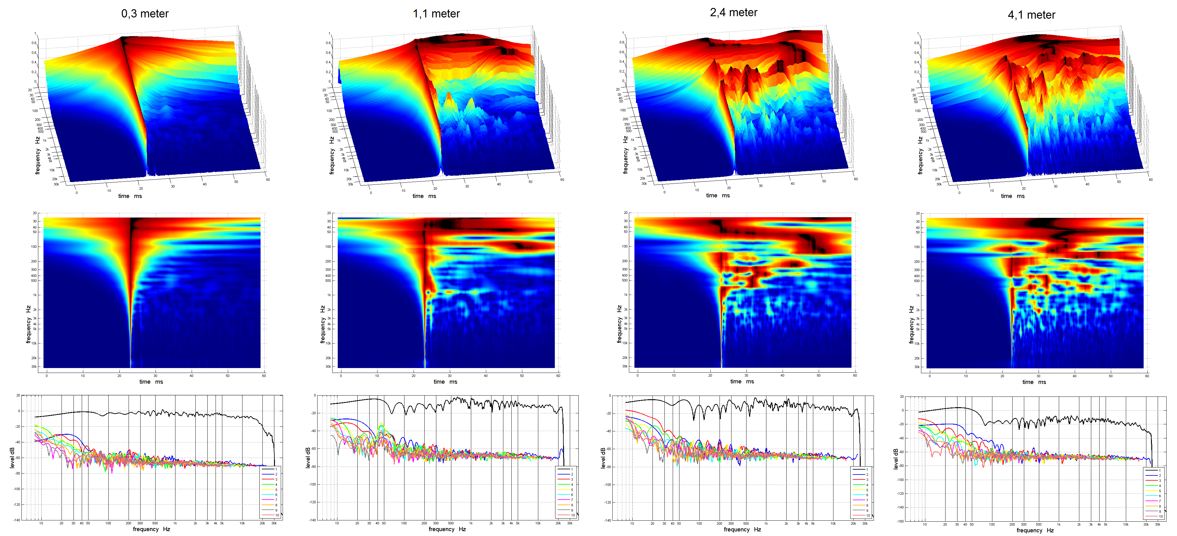

Re' Bill's guess about DFR in a spectrogram
Yes, you can see the DFR in a spectrogram, most clearly in the TDA 3D spectrogram attached to my previous post, as the black, highest intensity, line following the top of the ridge. You don't need to extract it from a spectrogram; things like REW and OmniMic can produce it directly and I've seen correlation between REW GD and TDA DFR or GDR when using the same windows.
APL_TDA can produce raw frequency response (AFR) and delay frequency response (DFR and GDR) and windowed curves. The processing for the latter is called FFT Q window analysis. Q windowing is said to limit the ringing of particular impulse response to value of Q set by the user and to eliminate most of environment’s reflections. Below I'm showing the raw AFR for my time aligned 3 driver sum w/o XO followed by windowed AFRs at Q = 2 below the raw graph, Q=8 to its right and Q=4 in the upper left.
As I mentioned briefly before, the Q-windowed curves can be produced with or without minimum phase subtracted. By comparing the with/without curves you can see in phase or group delay domains what is non-minimum phase, and thus likely to be something the room is doing to you, provided you are at least close to time alignment.
