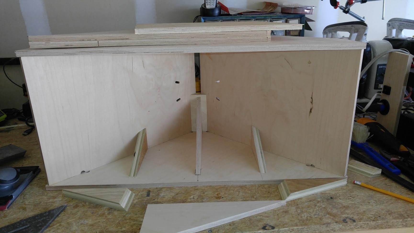

Here is one set of braces laid out on the bottom plate of the horn:

here is a test fit. It doesn't lfit well but I haven't cut the angles on the sides yet.

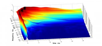

BTW: I finally did get all 3 drivers time aligned, just this afternoon. The attached graph is w/o FIR, in fact no XO or filters at all; just three drivers with precise DSP delays of 2 ms on the mids and 2.19 ms on the CD.
Those DSP delays should be a good starting point for the XO (tomorrow).
Using the 3 measurement method, each driver separately and then both together, I just couldn't find alignment. I may not have looked for the CD to be delayed more than the mids, that is somewhat counter intuitive. The other thing that made it hard is that both bass bin and synergy are horns that have significant group delay that varies with frequency. With APL you not only can tell when you have it right but you can readily see the effect of small changes of delay.
