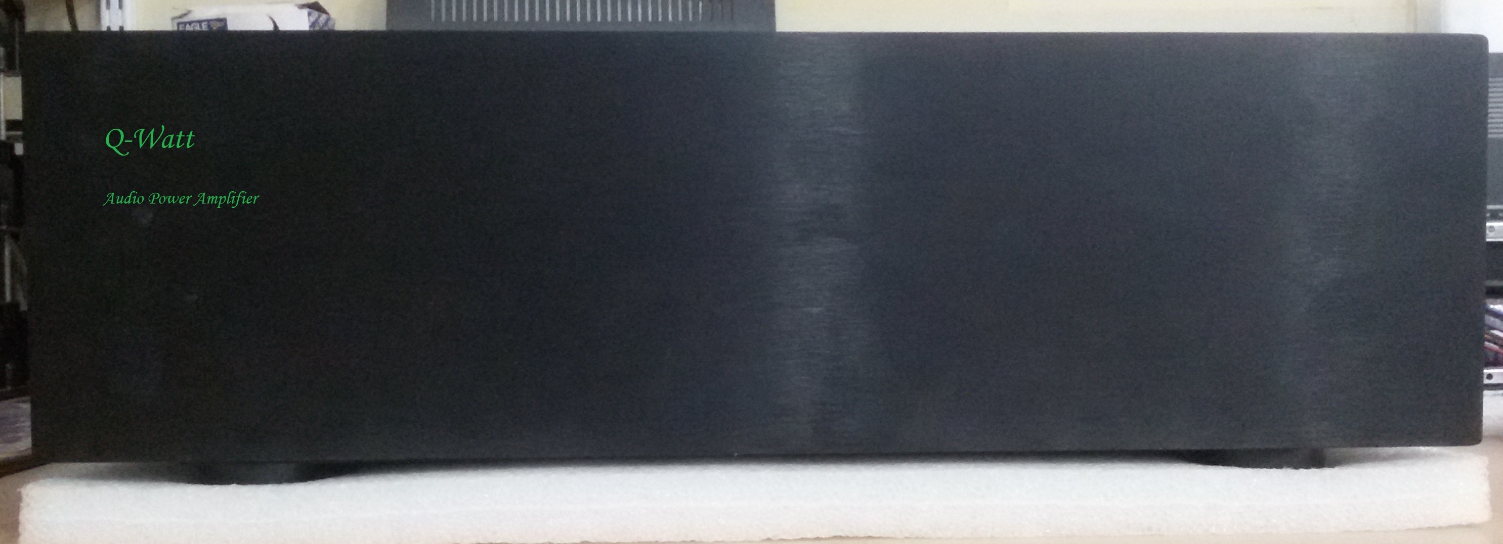

My life and my Q-Watt project that i constructed were in my hands when i begun this project, I'm still alive and my Q-Watt is working and sounds fantastic! 😀

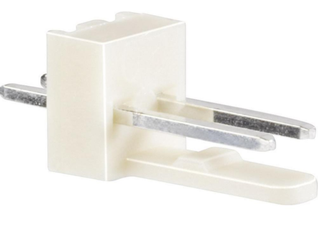

Thanks Calpe. Did you all use the small black 0.1" connectors supplied by Elector for audio IN. They look quite fragile to me. But then I have been known to overengineer everything...
They are indeed quite fragile. I used a different connector (see attached picture). That connector works very well and it gives me peace of mind 🙂
Hi Delange I found a similar male pcb header made by Molex. Did you solder both ends of this or did you use a female plug on your input cable? Thanks!
I soldered the male connector (header) to the PCB and used the female connector on the sommer cable. This way I can easily disconnect it should the need arrise.
If you look carefully in the pictures I posted you can see the assembly.

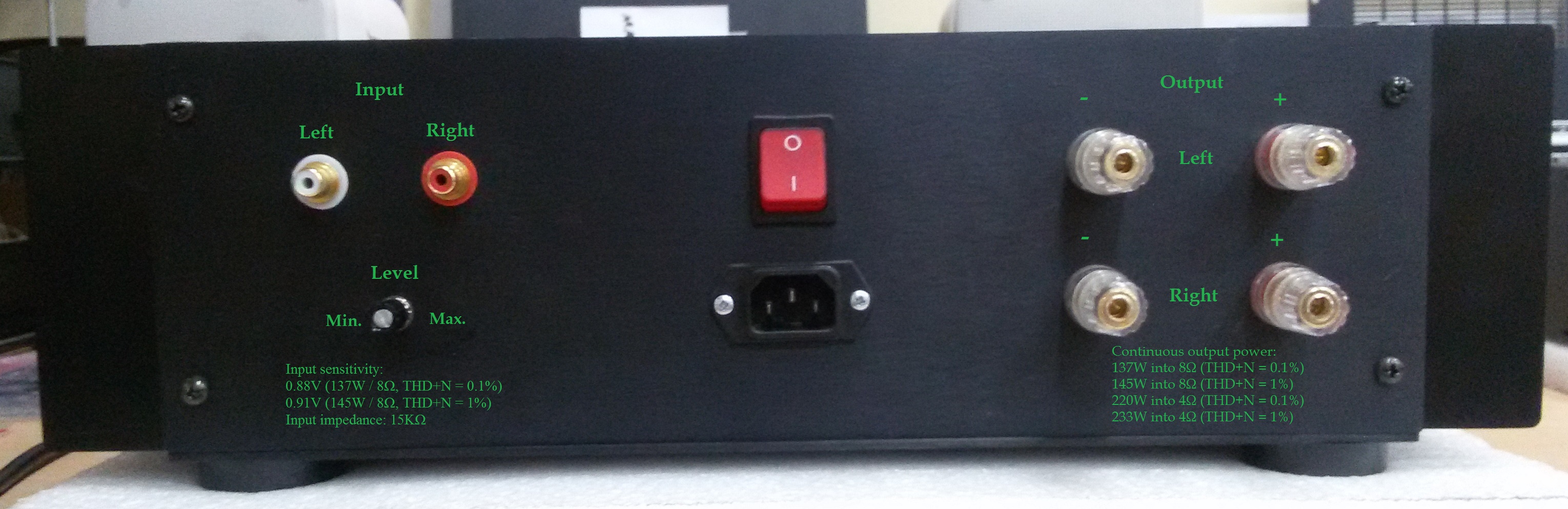

If i may delange (or any other Q-Watt constructor), could you please give me some ideas how i can label my rear panel as you have done in you #382 post, thread page 39?
See Delange's rear panel image
The panel was constructed by Shaeffer: https://www.schaeffer-ag.de/en/
It is also possible to use their Front Panel Designer software and print the panel on adhésive paper. Apply that label to the panel and the cover it with adhesive plastic foil for extra protection. That's what I did on the design of my first channel (see initial pics).
I've located from the numerous local Graphic Designers to do what Delange suggested and only for about £10, so i'll probably go for it.
Just need to sort out wording, an example ive posted here
Not forgetting that i still have to fit the front led indicator...
KiloOhms should have small 'k'. Otherwise it's KelvinOhms...
Is this for machining (etching) of the aluminium or for a stick-on label?
I would prefer to omit the THD specs. I also like using lines to link related connectors say from the word Input to Left and Right.
You could give some guidance on what level of attenuation is provided instead of min/max.
