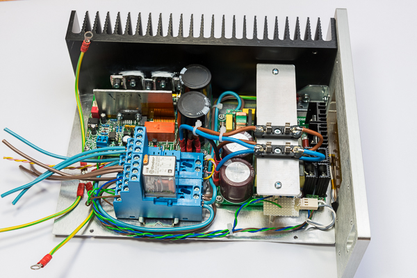

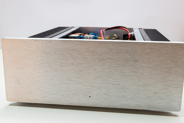

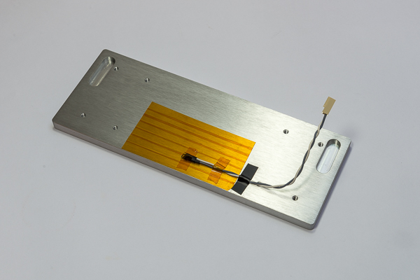

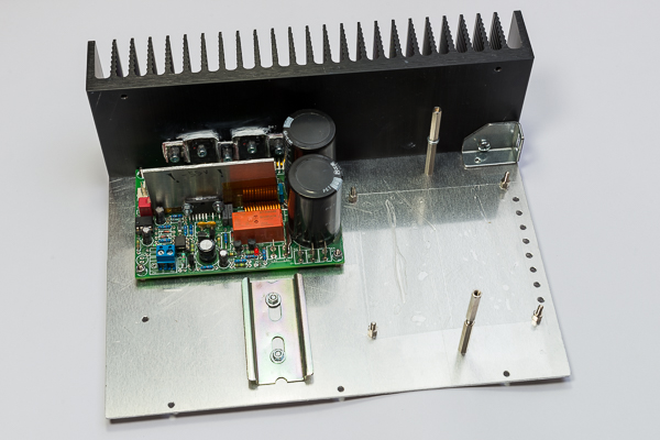

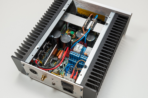

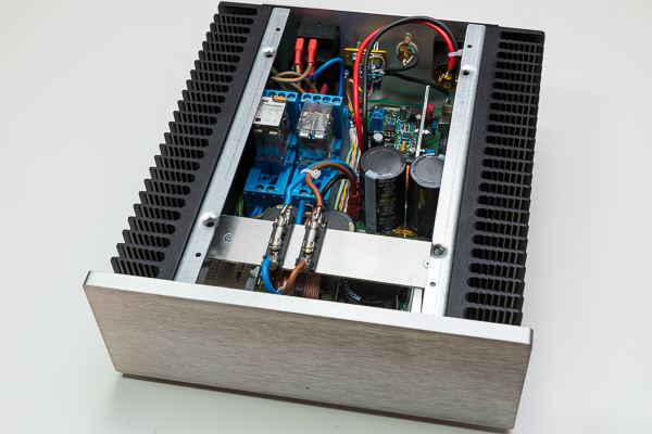

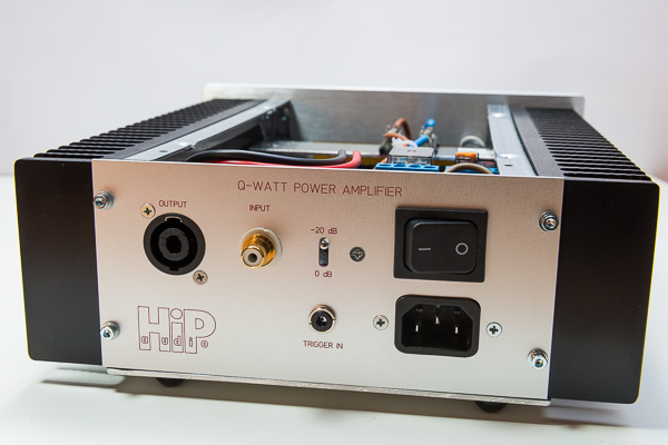

Finished my second channel; in a mini disipante enclosure.
Since there isn’t much room to spare inside, I had to modify the enclosure a bit. I used a 2 mm thick aluminum bottom plate instead of the default bottom plate that came with the enclosure. The bottom plate is fixed to the heatsinks from the bottom side. This way I didn’t needed the metal brackets and that freed up some space I needed to fit the amplifier PCB close to the heatsink. The mini disipante is a nice enclosure but some of the construction is not well thought through. For example, it is not easy to mount the front and back panels when the enclosure is well filled. The back panel I used is also screwed into the heatsinks.
I made some changes to the setup as well. I now have fitted the 12 volts trigger relay inside the enclosure. I’m using a trigger signal from my pre-amp to switch the power. I use a second relay to switch the opto-coupler and the power LED. The AUX supplies of the SMPS’s have fairly large buffer caps; the relay switches of the opto-coupler immediately as soon as power is removed. With this setup I don’t need the “larger” resistors to drain the buffer caps.
I’m in the process of converting my first channel to a mini disipante enclosure as well. I’m quite happy with the result. I attached some pictures of the various steps during the construction.

Well it is actually simpler than it sounds:
1) The 12 volts trigger relay: in my previous enclosure I didn't have the room to include it. The relay is activated by a 12 volts trigger signal coming from my pre-amp. The relay switches the mains to my SMPS, just like a mains power switch does. In other words, with the trigger signal my Q-Watt's switch on when my pre-amp switches on.
<slightly off topic>
I'm now starting a small project that takes the 12 volts trigger from my pre-amp and uses that to create 4 different 12 trigger outputs. These 4 outputs will be active delayed: when the pre-amp switches on, the 4 trigger outputs of my new project will become active one after the other with a slight delay between them. I do this to power on different components in my hifi system at a different interval.
</slightly off topic>
2) The second modification is about providing the required input to the opto-coupler. I my previous build I used two resistors and a fet to switch the power supply to the opto-coupler fast. Fast meaning as soon as the amp is switched off, the supply to the opto-coupler should be cut as soon as possible. I now have a relay who does that instead of the resistors and the fet? Why did I do that: because I could. The fet works just as well and is smaller than the solution with the relay. I retrospect, I would use the fet again because my mini disipante enclosure is packed...
3) there is actually a third change: I removed the volume pot and replaced it with a 0 dB / -20 dB switch. I use a pi-pad attenuator to get the -20 dB attentuation. I only implemented the volume pot to pre-set it to certain level. This is easier accomplished with an attenuator. The pi-pad is soldered directly to the switch. I should have taken a detailed picture if that but I forgot 🙂
