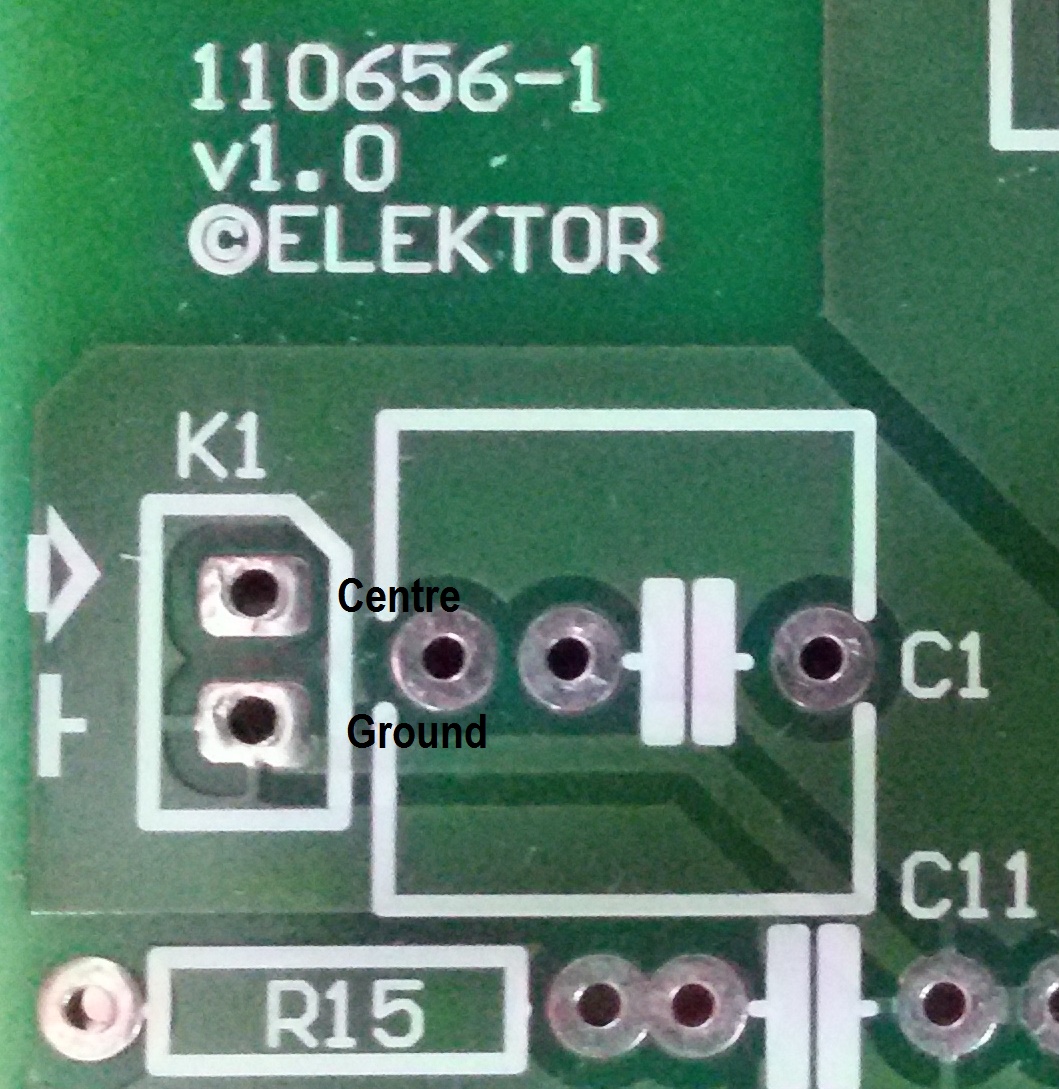

Popchops, the signal input cable i used for the Q-Watt was from Farnell UK.
Code 1891100 - VAN DAMME 268011C Multicore Screened Cable, Black, 24 AWG, 0.22 mm²
As Delange correctly said the screen connects to Ground on K1 connection (pin 2) and if there might be any 'hum' then the connection of the screen to Ground will do away with this.

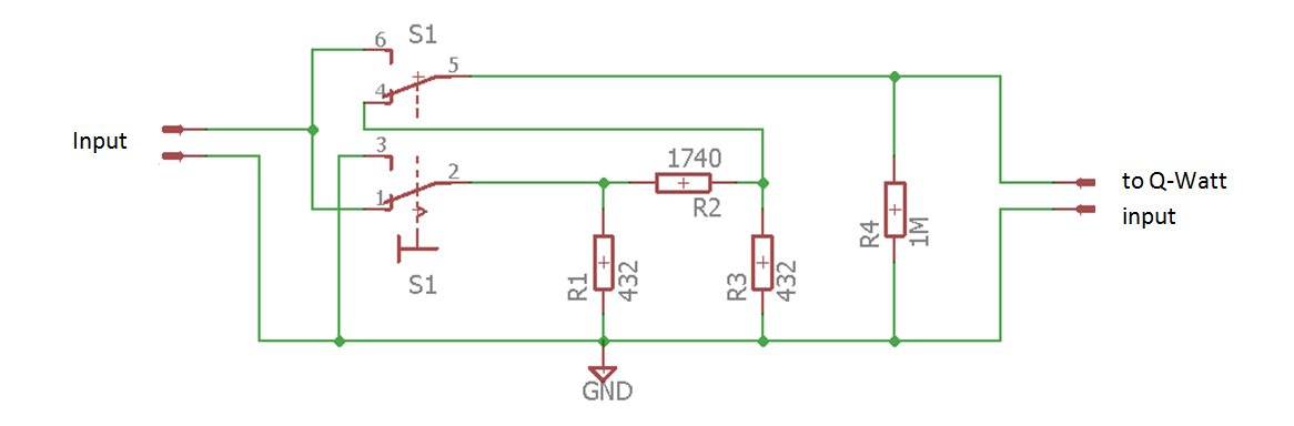

3) there is actually a third change: I removed the volume pot and replaced it with a 0 dB / -20 dB switch. I use a pi-pad attenuator to get the -20 dB attentuation. I only implemented the volume pot to pre-set it to certain level. This is easier accomplished with an attenuator. The pi-pad is soldered directly to the switch. I should have taken a detailed picture if that but I forgot 🙂

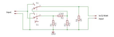

I used a DPDT switch to select either the input signal straight to the Q-Watt input or through a pi-pad attenuator. The attenuation is set to -20 dB and it is normalized to about 350 ohms. I have used this attenuator in my system before and it works very well with the Q-Watt as well.
I have attached the schematic in case you're interested.
Superb Delange!
Interesting to see the values chosen.
It's normalized to about 350 ohms (impedance my pre-amp sees). The impedance should be low (but not too low). The values also set an attenuation of 20 dB. The values chosen fit that criteria.
What values would you have chooses?
Why is the input impedance set to 360ohms at switch position shown but set to 1000000ohms when in the other position?
Why does your Source need to see a load impedance of 350ohms?

Yes, impedance matching is essential in almost any RF application, but not necessary in small signal AF, where we don't need mximum power transfer. On top of that be careful with your chosen impedance value, as 350 ohms might present a severe load to some preamplifiers, thus unnecessarily causing distortions.

I also think that a Pi attenuator with equal input and output impedances doesn't provide significant benefit over a simple voltage divider in small signal AF applications. It has to be considered in loudspeaker services, though.

An advantage of the pi pad in audio is that you can reverse it (input - output). Of course, the one I used in the Q-Watt is fixed and cannot be reversed. But if you built one into a cable then you could reverse it.
The difference between a voltage divider and a pi pad is only 1 resister. A resistor is very cheap, so why not go for a pi-pad?

I initially built this to be used with my Audiolab M-DAC. It has an output impedance of less than 1 ohms. This is a very good design and devices such as these will have no issues with the chosen values.
I also have it running for several months on my Cambridge Audio pre-amp. Although I couldn't find any info on the output impedance of the CA but it works very well too.

As a fellow constructor you'll see in the image the connections, wording in black text.

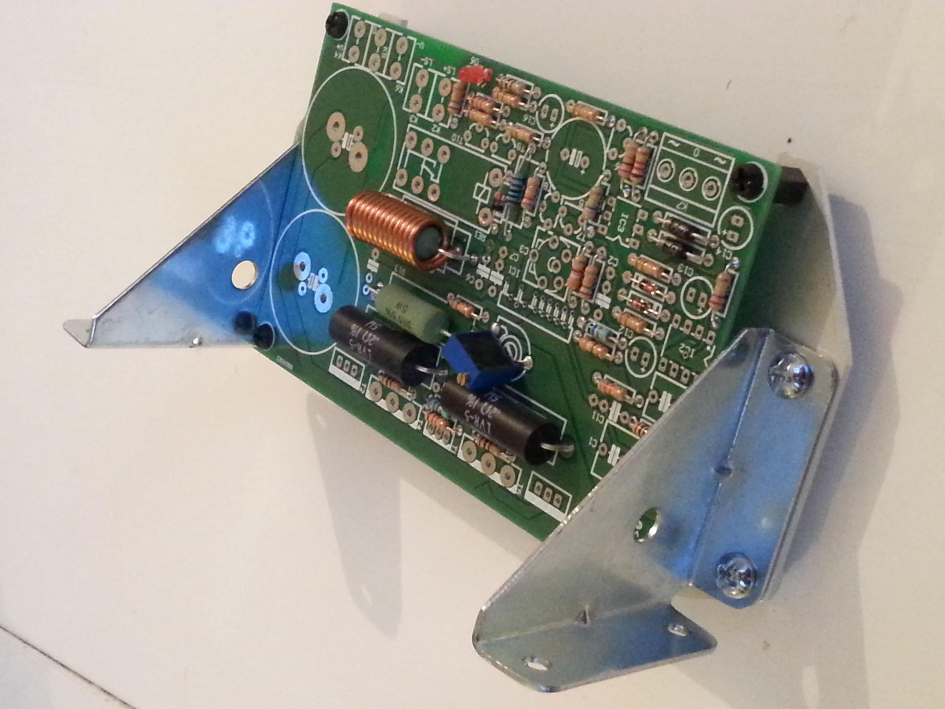

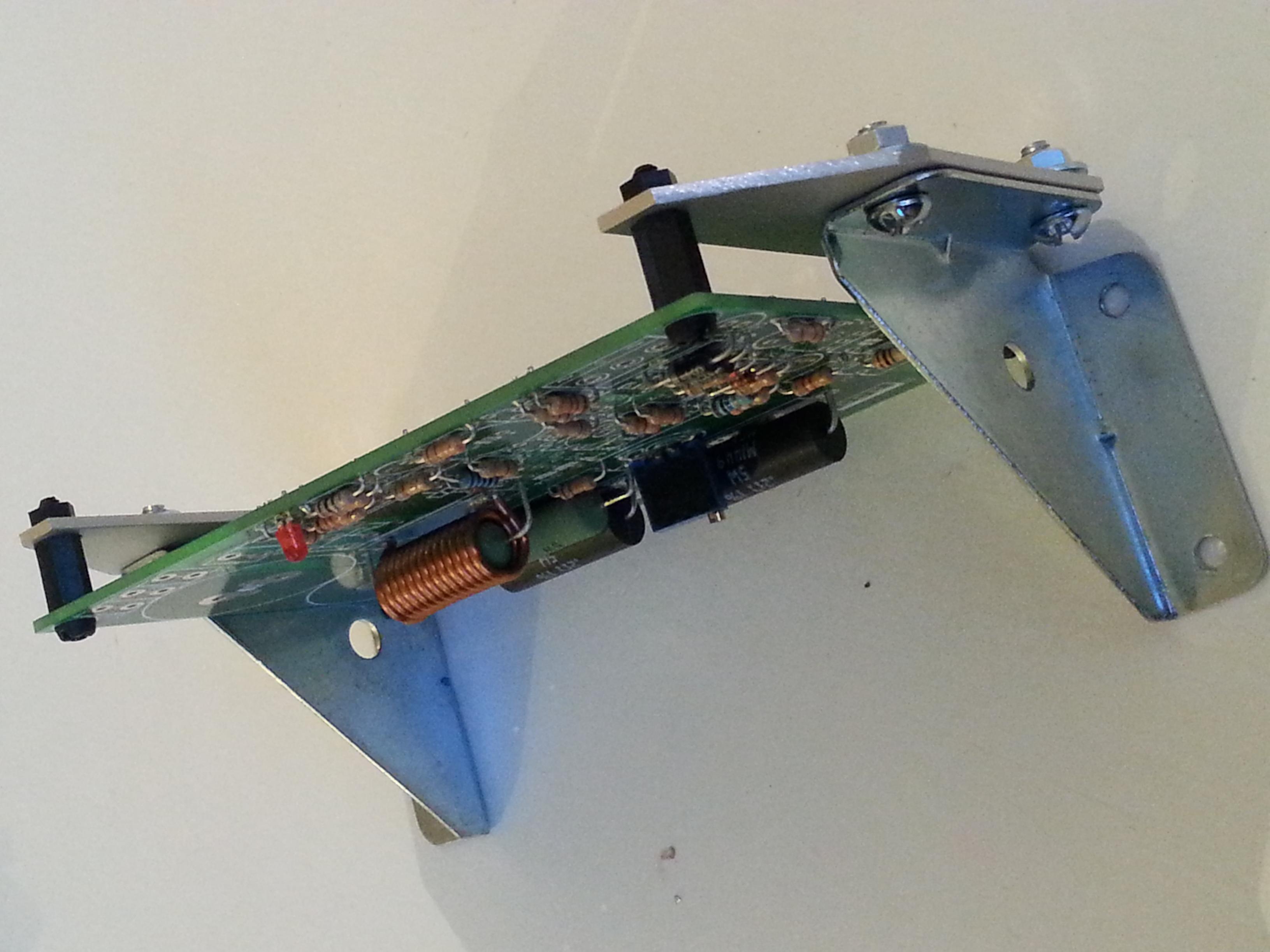

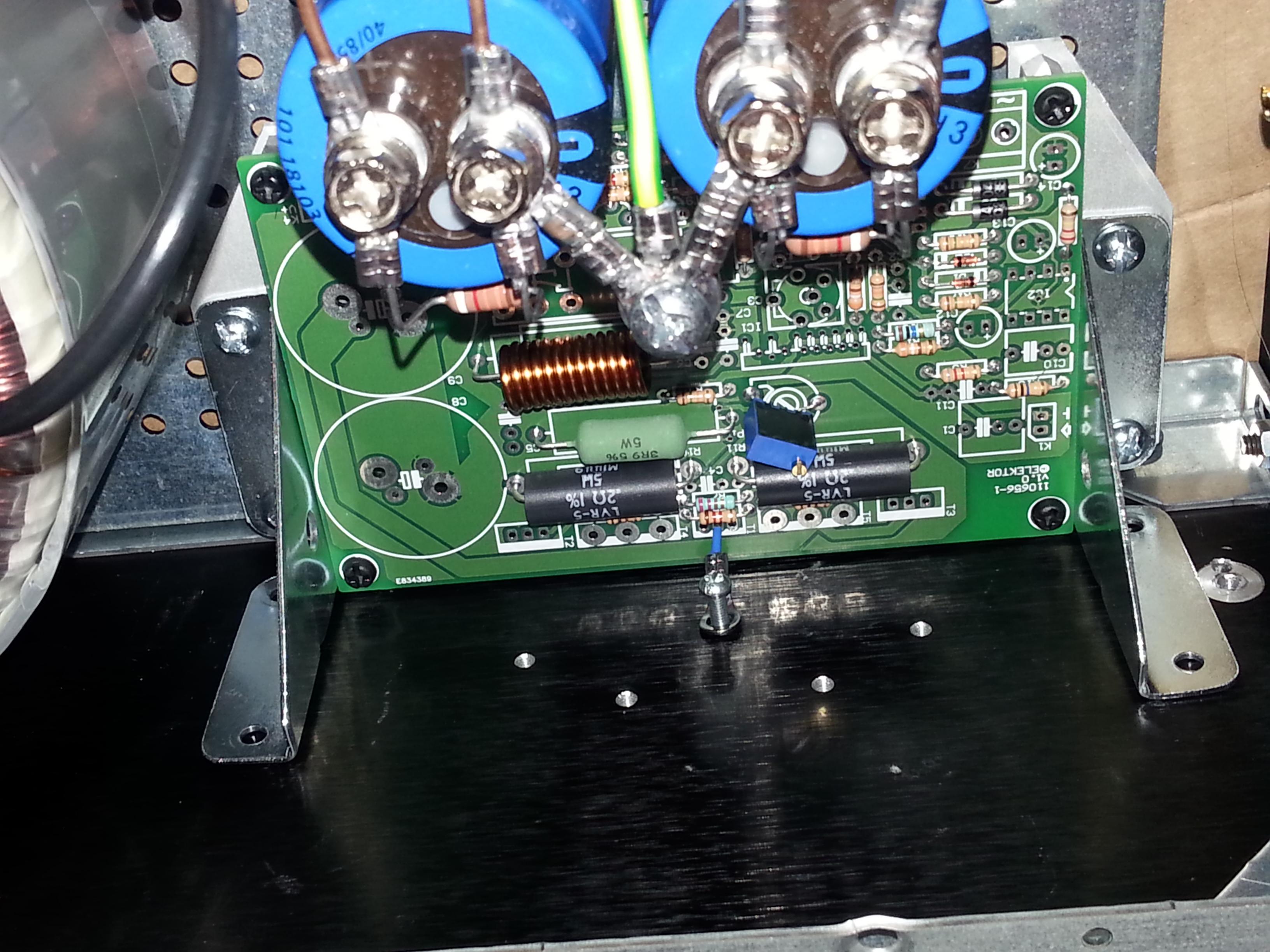

I found a simple bracket design for the Q-Watt that uses steel right-angled corner brackets from Ebay and 25mm aluminium strip. Allows the PCB to be mounted on the heatsink for strain relief on the semiconductor pins, and also for testing separate from the rest of the case.
Works in a 3U case with the highest/largest chips mounted on the centreline of the heatsink.
