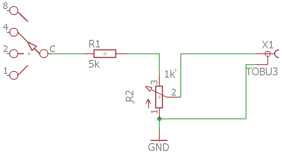

Hmmm maybe the ideal position of the volume can be adjusted using fixed attenuation internally. With the high power and sensitivity of the Q-Watt I think a fair wad of fixed attenuation will be needed for 2V sources. Will need to lose about 10dB before even thinking about volume control. This should increase the usable range of the potentiometer. Or am I talking rubbish?
There is indeed some sense in that: something like the attached picture will give you volume control and about 14 dB attenuation.
The potmeter could be something like this one
Mmm I like that Delange. You have just shown one ground. Actually each source RCA connection will have its own signal ground. Do I need to switch in the appropriate signal ground too? I think you showed just one switch for the 'signal' wire.
Also some sources are stronger than others so I would split the fixed resistor into one per source channel upstream of the switch.
Pops.

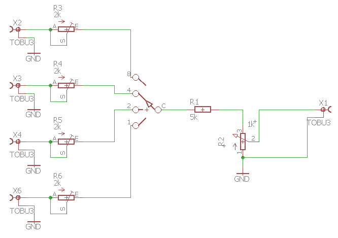

I posted a "mono" version; so you need a double pole switch and a dual gang potmeter for the volume pot. I'm not a fan of switching the ground signals.
I would do it as in the attached picture. Again this is a mono version but it works the same in stereo.
If you are worried about the the differences in the different sources you could add potmeters in series in the input sides. I added 2k pots but you can increase them to say 5k if you want more attenuation.
14dB is 1/5th, but 5k in series with 1k volpot gives 1/6th = -15.56dBThere is indeed some sense in that: something like the attached picture will give you volume control and about 14 dB attenuation.
Nearest resistor to 5k is 5k1 in E24 range, giving -15.71dB
3k9 gives -13.8dB
