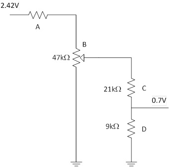

Here's the idea:

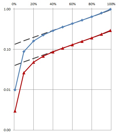

47k linear pot followed by a 9k:21k Ohm voltage divider as shown attached. Blue line shows the calculated voltage transfer Vout/Vin before the voltage divider (input to resistor B). Red line shows voltage transfer with the voltage divider (between resistors B & C). Resistor A was set to zero for calcs.
Should give me the necessary attenuation to protect my speakers while I test the Q-Watt.
Can anybody explain in words of one syllable how to calculate the input & output impedance here?
Is the voltage divider (resistors B & C) a better arrangement for attenuation than a series resister feeding into the pot (resistor A)?
Cheers - Pops.

Start by changing each vol pot into two resistors that add up to the pot value.
A=0
B= 46k+1k
C=21k (does not exist in E24)
D= 9k (does not exist in E24)
The output impedance of B is 1k||{0k+46k} = 978r7ohms
The output impedance of C/D = 9k||{978.7+21k} = 6385r3ohms
Input impedance of C/D depends on load impedance. I'll choose 100k for Zin.
C sees D||Zin = 9k||100k = 8256r8ohms = E
B sees C+E = 21k+8256r8 = 29256r8 = F
Upper B (46k) sees LowerB (1k)||F = 1k||29256r8 = 966r9ohms = G
A sees UpperB+G = 46k+966r9 = 46966r9
Input impedance for that one setting = ~47k
Output impedance = ~6k4
Throw that idea in the bin.
Change input vol pot to 10k, insert 0k or 30k for A
This will give a consistent input impedance and a lower output impedance.
The lowest input impedance will be 100k||10k = 9k091, or 30k+{100k||10k} = 39k091
The highest input impedance will be 10k, or 40k
The highest output impedance will be 25%*10k, or 25%*{30k+10k}=10k. This second setting should never be required because you are adding -12dB with the 30k and adding -6dB at the vol pot for a total attenuation of -18dB, A = 0k and B= 8k74+1k26 gives ~-18dB giving an output impedance of 1k1 instead of 10k
Put that into a spreadsheet for almost instant answers.

Hi Andrew,
OK so resistor A is preferable to the C/D voltage divider, as delange recommended before. Got it. Strange that Kevin pointed me towards a voltage divider.
I would like to emulate a 10k logarithmic pot, with a linear pot (B) and a resistor (C). C = B/5. What value of B is needed? Surely not 10k?

A lin vol pot with a log emulating resistor gives an "S" curve instead of a log curve. (try plotting rotation vs dB attenuation. A straight line is a log law.) You, the Builder, can change the slope of that straight (or bent) line.
But a log vol pot does not give a log curve because most/all are two series connected linear tracks inside the casing.
The usual recomendation for a log emulating resistor is somewhere around 10% to 20% of the pot value. Your /5 is 20%, so may be a bit too high.
It is easy to determine the resistance vs rotation of a linear pot. The only error is in the manufacturing tolerances of the pot build.
Determining the resistance vs rotation of a log law pot must be done by measurement and every pot will be different and every manufacturer will be different. You can only do it for the pot in your measurement jig.
I have used 100k & 15K and 100k & 10k, but neither give good rotation sensitivity. Neither were kept in the music system for very long (a year or so).
I find the ONLY way to get the rotation vs required attenuation is to make up a custom stepper with my own values.
One of the problems with the log emulating lin+R is the VERY variable input impedance. This seriously affects the RF attenuation. At worst you must set the lowest RF frequency attenuation someoctaves above the audio band. But as you rotate to a new setting you can find that the RF attenuation moves a decade higher and allows much RF to pass into the system.

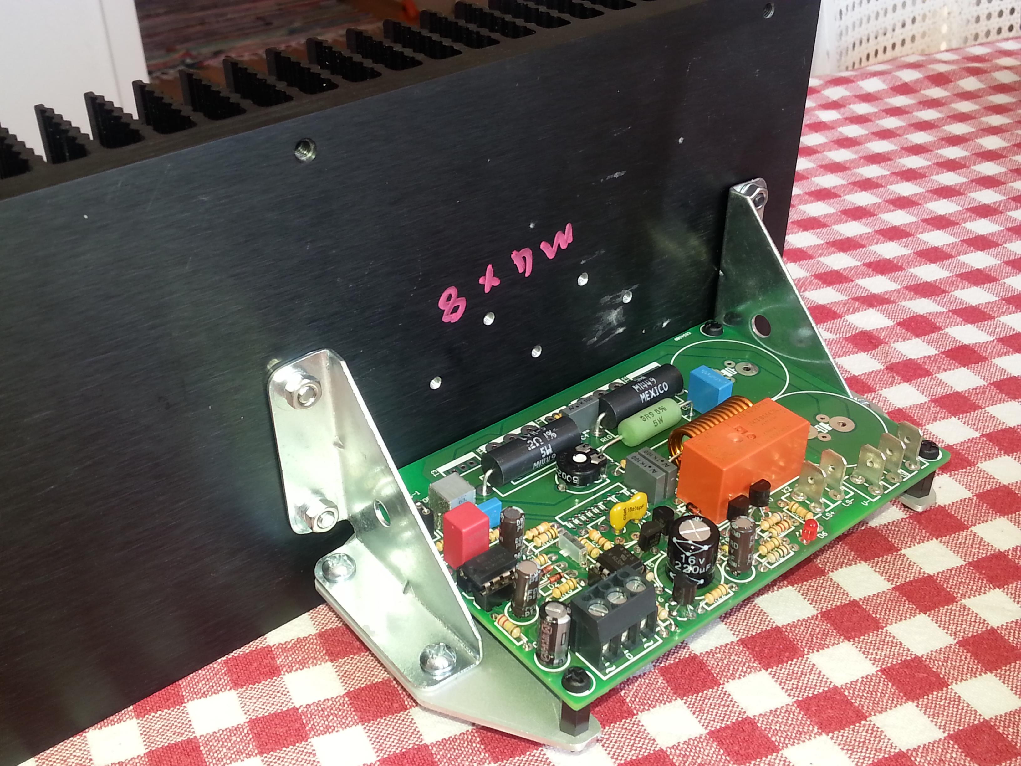

Hi folks.
Quick question to Calpe and Delange and the other Q-Watt builders:
Can anybody summarise the isolation requirements for the semiconductors T1-T5 on each heatsink. It looks to me like there is in each case a metal bolt holding the chips onto the heatsink. I know theres a non-conductive pad... but the screw passes through it.
So... how do I avoid unintentional 55V on my heatsink and am I missing something? Is it correct to connect my heatsinks to earth?
T2 has the metal bolt directly holding the base of the chip? So is this at 0 volts? Other than an isolating pad under each chip, what extra measures are needed. (Some small black washers were included in the kit. What are these for? How many should I have?)
Am ready to solder the chips and IC2 and filter caps now. Thanks, Pops.
Only T2 and T3 need a plastic bushing before fixing the transistors. The other transistors have a plastic housing and these don't need that isolating bushing.
It is important that the holes are drilled at the correct locations so that the transistors sit nicely above their places on the PCB.
This video (at the end) shows how to mount the transistors and which ones need the isolating bushing:
https://www.youtube.com/watch?v=7pPDXuZxAg8
Yes.
I did that too and it works fine. The metal enclosure needs to be earthed anyway (for safety reasons).
The heatsink is at -55 volts if you screw it directly to the heatsink.
That is fine; just do not touch the heatsink while the amp is powered on. In normal circonstances no one will be able to touch it because the enclosure will be closed. As a precaution I wrote it on the heatsink with a alcohol marker. If some one in the future opens the enclosure the that person will notice the warning.
I believe these are the two isolating bushings for T2 and T3.

Popchops, glad to hear your a step closer.
Taken from the Elektor article:-
'Mount the heatsink so that it is a bit above the board when the IC is fitted, to avoid contact with R1, R4 and R5. Caution: the metallic rear surface of the IC is connected to the negative supply voltage. This means that if you do not use insulated mounting hardware, the heatsink will be at the negative supply voltage. For safety, we recommend using insulating mounting hardware here.'
In my case i chose to fit a insulating pad that covers the metal part on the rear of the i.c., i prefer not to have -55v on the heatsink.
Check carefully the bottom of the heatsink does not/will not make contact with R1, R4 & R5.

Calpe - I wasn't planning to isolate the small 8cm heatsink... I prefer to maximise cooling. I will have to put some warning inside the case.
Pops
That's fine popchops, that's the pleasure with us Q-Watt builders, each one of us has our own thoughts and ideas.
Just double check the bottom of the heatsink is clear from those resistors mention before.
