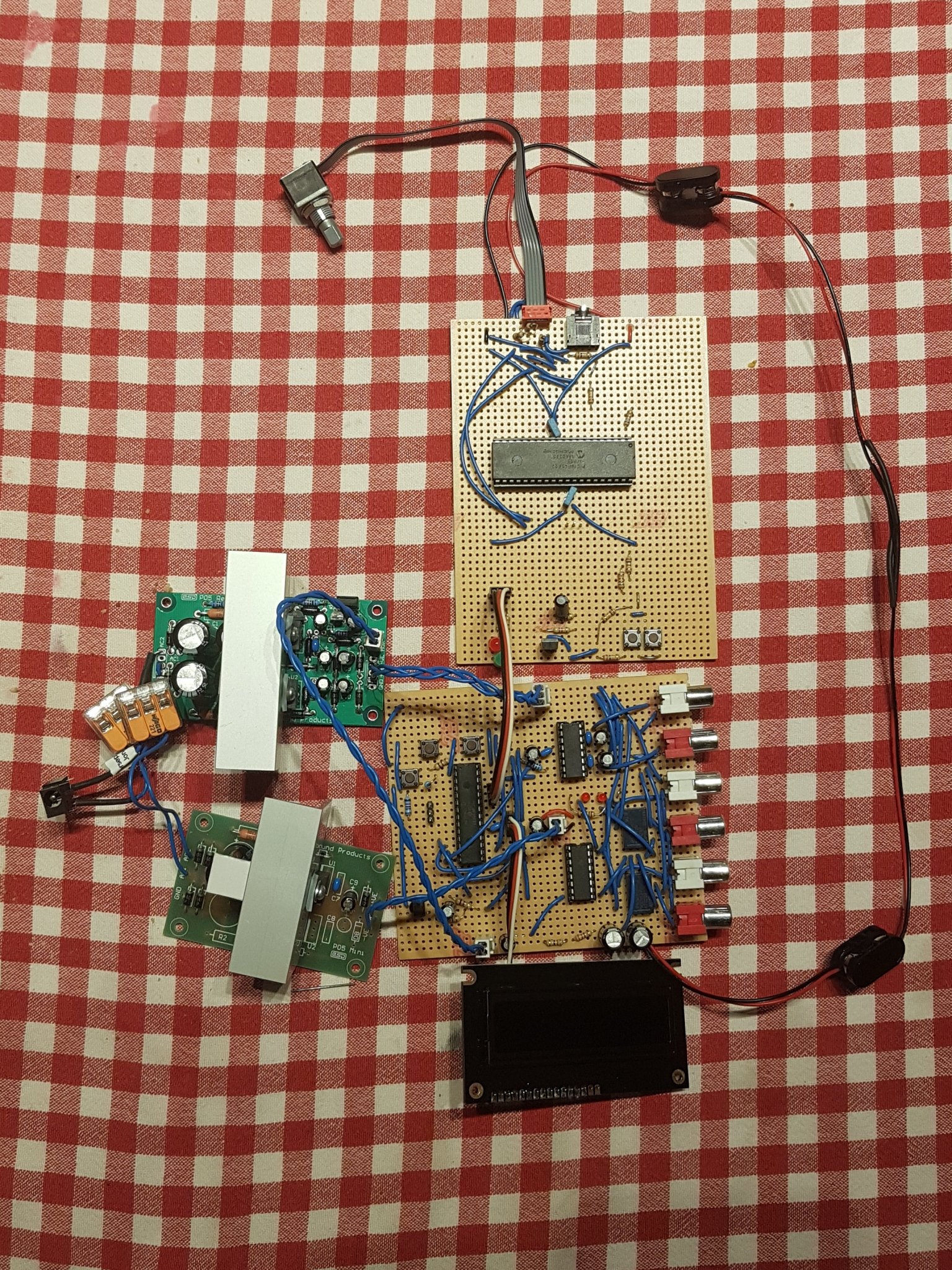

I am building a digital preamp and analogue switch based on PGA2311. 2-channel prototype is complete including software, and works brilliantly.
Uses optical encoder as volume control and infrared too. Offers 0.5dB steps in attenuation (or gain) with very low THD.
Am just now designing new circuit boards. I should start a new thread. Power supplies are both from ESP, and in fact the whole idea is based on ESP P163: https://www.sound-au.com/project163.htm.

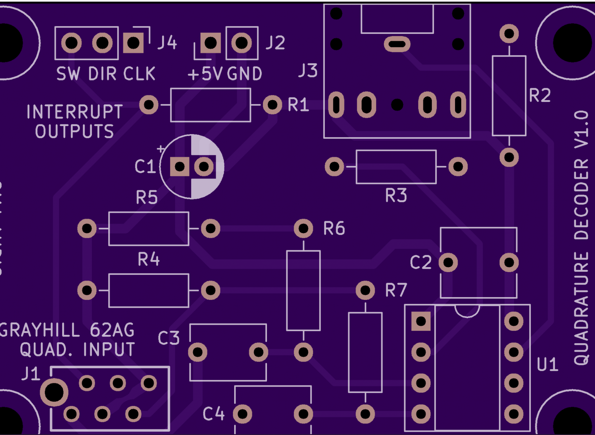

First of 3 PCBs ordered today. Like your tranny, I expect to wait 5 weeks for this PCB to be delivered.
This 8-pin PIC will decode the quadrature inputs (and push button) from the Grayhill knob, and signal change and direction to the main PCB.
